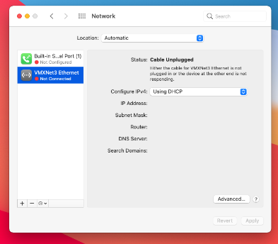

my BigSur VM is still using the Vmxnet network adapter, even though I changed it manually to e1000 and run the helper script.

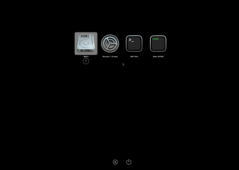

And, is there a chance to get rid of this pre-boot screen?
How are you saying this?Is this because of the name in system preference panel-->networks?
If you want to hide this, mount the efi partition, open EFI/OC/config.plist and change showpicker from true to false, save, unmount and you're done. <-- PLEASE USE TEXTEDIT TO OPEN config.plist
If you press '0' key when the vm boots you can show the bootpicker again, otherwise it will directly boot the default device.
I check the pref-networks.  No DHCP IP assigned.
That is just a name, you can rename to what you want.
To check if the correct model is applied you can check your qemu logs, for example you can save the diagnostics file of unraid and once extracted you can check inside "qemu" folder the file "vmname.txt" and you should find the model in use.
As an example, this is for a virtio-net network:
-device virtio-net-pci,netdev=hostnet0,id=net0,mac=52:54:00:c5:5d:33,bus=pci.0,addr=0x2 \
BTW, using vmxnet3 should not prevent the os to get an ip (it had some issues with upload speed and with apple id logins, did not try if now it's still an issue), so you need to check your network settings in the host and the vm settings.
Qemu log say this:
-device e1000,netdev=hostnet0,id=net0,mac=52:54:00:fd:62:ab,bus=pci.6,addr=0x1 \
VM config XML attached as plain text.
