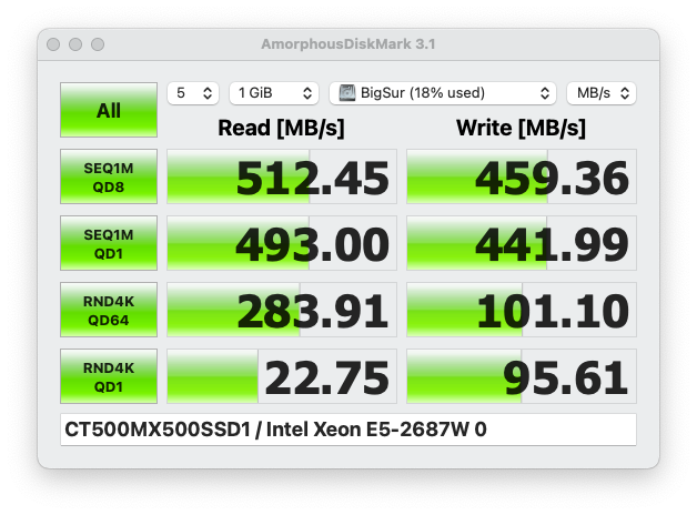

Yesterday I changed the hard drive configuration, switching from vdisk file on ssd to sata controller passthrough with the same ssd attached with mac os restored on it.
Well, performances increase a lot..From 237/257 MB/s (write/read) to 422/495 MB/s (write/read) with blackmagik software.
AmorphousDisk mark results follow:
Looking more into details, I found that this is because the virtual sata controller for vdisks in mac os is seen as a generic AHCI controller running at only 1,5 gigabit, the marvell 88se9230 I'm passing through runs at 6 gigabit.
Not sure if the emulated sata controller running at 1,5 gigabit is a limit of mac os or of qemu (in other words I don't know if in a windows or linux vm it runs at the same 1,5 gigabit speed), anyway if you have a spare sata controller running at higher speed it may worth to pass it through!
--> see below comment by giganode --> low speed probably related to too much overhead through virtualized devices.
Moreover I used to keep the bootloader in a separated img or qcow2 image file instead of on the mac os EFI partition, but it seems that trim/discard doesn't work with virtual sata and FAT32 on mac os, so if you keep writing and delete on the EFI image file the host doesn't sync the free space with the vm.
Passing through the sata controller and moving the EFI to the EFI partition of mac os seems to overcome this issue, since the disk is no more seen by the host and all is managed by mac os.

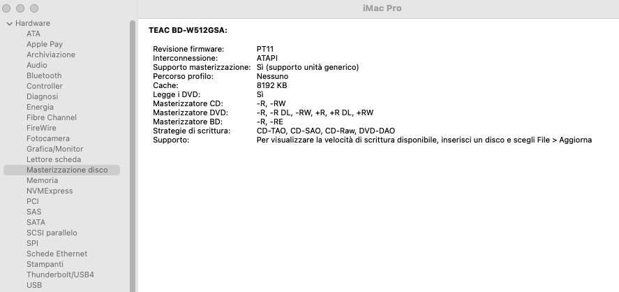

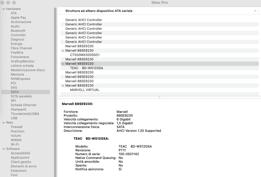

On 4/28/2020 at 4:21 PM, ghost82 said:
Maybe we first need to choose a smbios such that the original SystemProductName is equipped with an optical drive..I doubt it is going to work with a sata bluray/dvd writer if the original iMacPro1,1 has no optical drive..In this case, a sata to usb adapter could work..
And it works instead..ideally every sata cd/dvd/bluray should work.
I'm currently using a teac bluray attached to the passed through sata controller.
Not sure if it's possible to pass through directly the cd/dvd/bluray drive in libvirt, I tried in the past without success, but I think I didn't choose correctly the bus to attach it, attaching it to a virtual sata controller could work.

On 5/16/2021 at 11:02 AM, ghost82 said:
My god...what a monster!!
Hi @ghost82...
The 1,5 Gbit indicated in the system overview of macOS are not relevant. Here is a benchmark with my image, stored on an nvme:
Edited by giganode

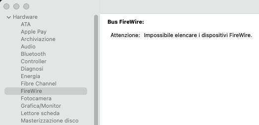

Anyone passing through a firewire controller?
I don't have any device to test, I'm not sure it works, in about this mac --> system report --> firewire, I read:
Firewire bus
Warning: unable to list firewire devices
It's a VIA VT6315 chipset, firewire 400, from the boot log it seems correctly initialized.
In my original macbook pro, there's no device attached but I can read the bus speed instead of the warning; however in that macbook pro the isight should be connected to the firewire bus internally.

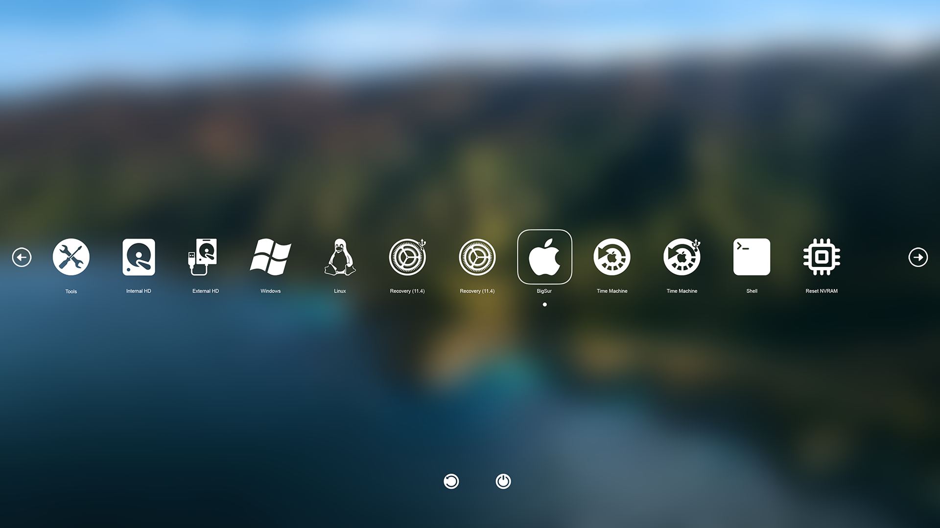

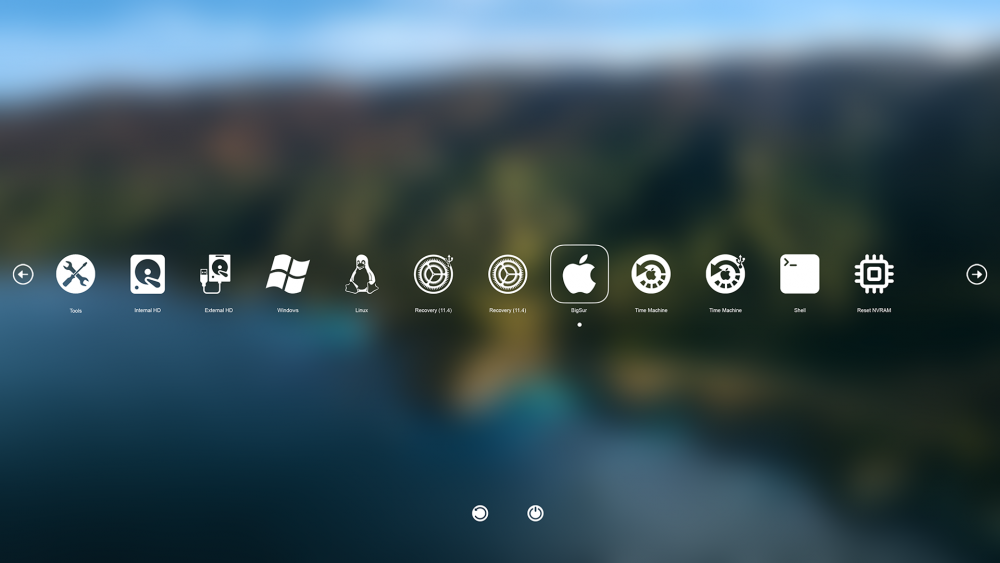

Sharing my theme BigSurFlat for opencanopy, works with latest oc/ocbinarydata versions.
Available on github:
https://github.com/82ghost82/BigSurFlat
Edited by ghost82
