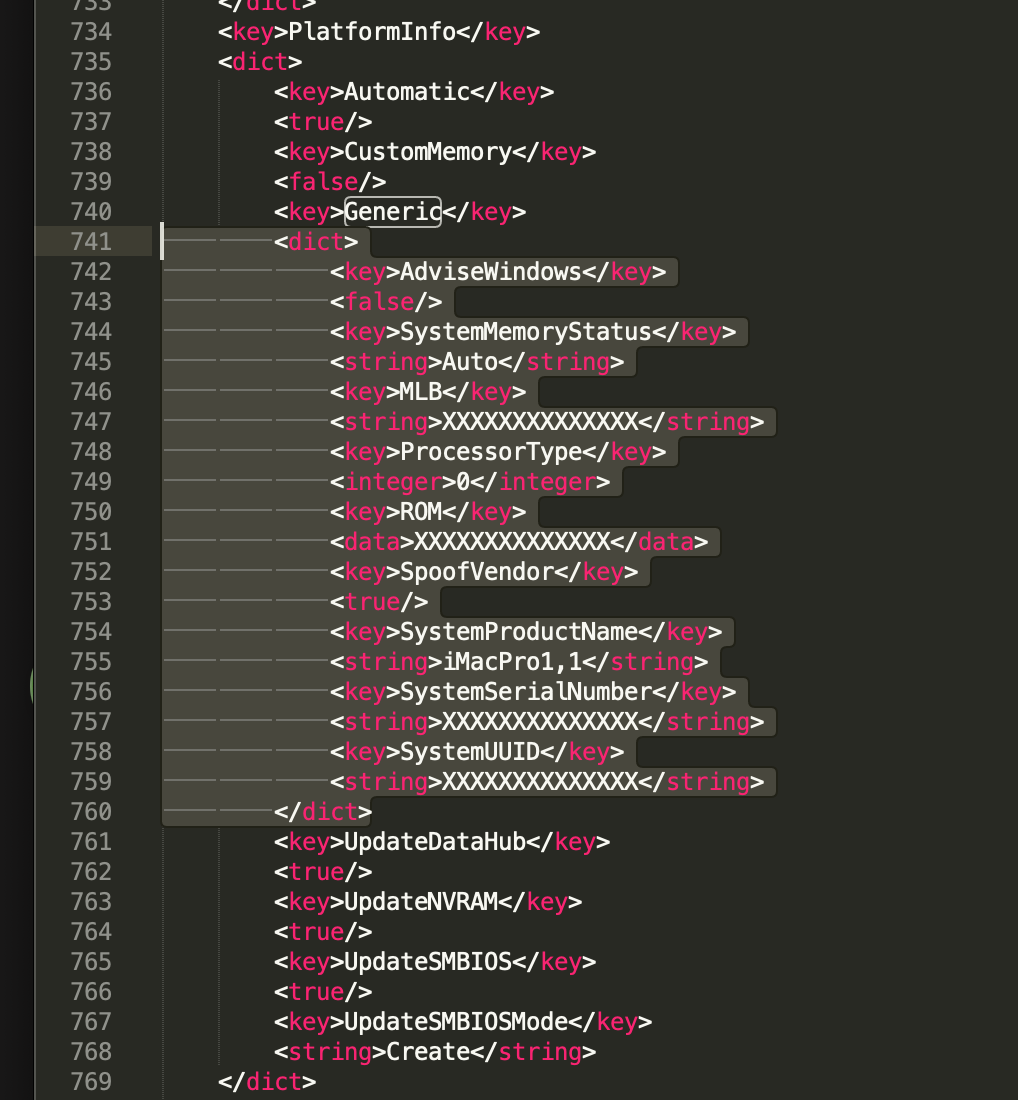

I upload my EFI so maybe you can point me out.
Edited by Idris Gsmalla
Remove "sensible" data

Hi @Idris Gsmalla!
You should already have the power injection properties in your SSDT-EC.aml and it is already configured in your config.plist:

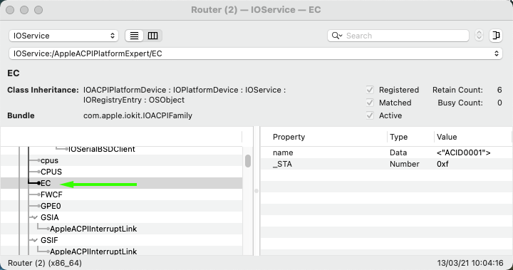

Just make sure you have injected EC device and USB power properties with IORegistry Explorer:
As far as I know nothing has changed in the structure of injecting usb power properties from Catalina to Big Sur.
I suggest to delete your attachment, which contains "sensible" data, just to avoid that some user will download it and use the same data which can cause issues.
EDIT: mmm...wait it seems there's something wrong also with my properties...there should be extra current available for usb ports and properties for usb ports seem wrong...I'm trying to figure out what's wrong..

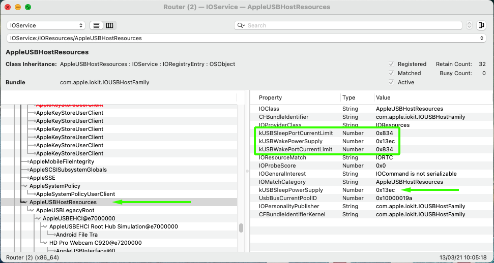

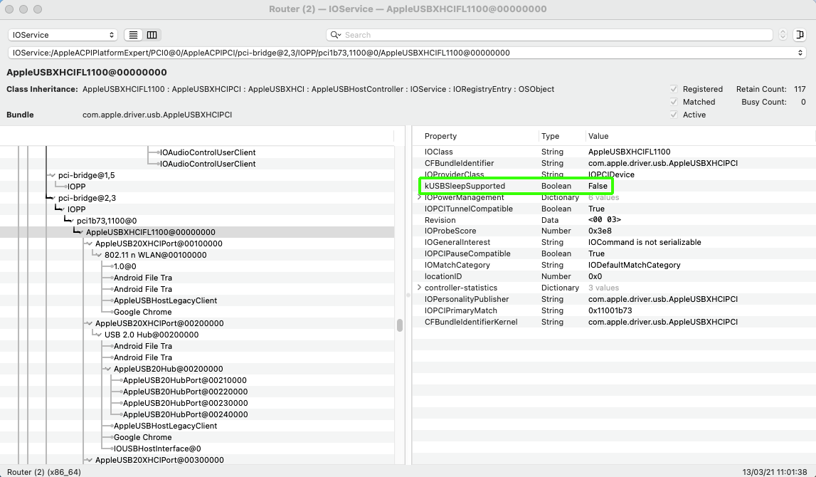

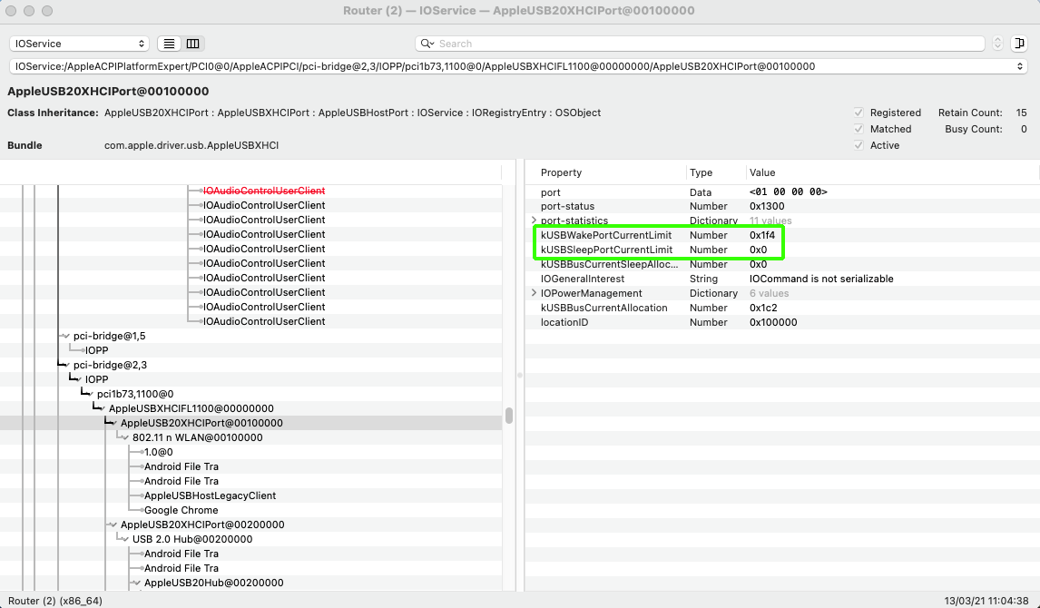

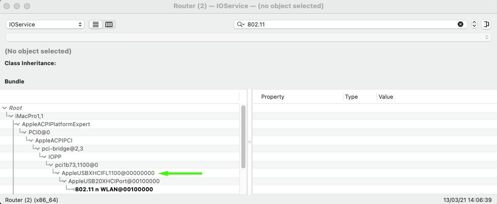

Ok, I think I fixed it.
Current case: USB Fresco Logic FL1100 passed through, devices passed through directly (no usb controller passthrough).
Available controllers in mac os (Big Sur) virtual machine:
1- AppleUSBXHCIFL1100 (Fresco Logic)
2- AppleUSBEHCIPCI (qemu EHCI controller for 2.0 usb devices)
3- AppleUSBUHCIPCI (qemu UHCI controller for USB 1 devices)
Issue:
USB power properties injected through SSDT.
Power properties show in AppleUSBHostResources:
But something strange showing in the controller (following images refer only to the fresco logic controller):
kUSBSleepSupported is showing as false, injected power values don't correspond.
Resolution:
inject a kext to properly inject power values and properties into controllers too.
Attached kexts for Fresco, EHCI and UHCI controllers.
Copy kexts in EFI/OC/Kexts and modify config.plist (following example for the injection in Fresco Logic):

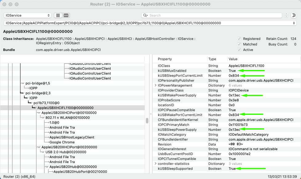

Now (image refers to Fresco Logic):
Properties and values are injected correctly.

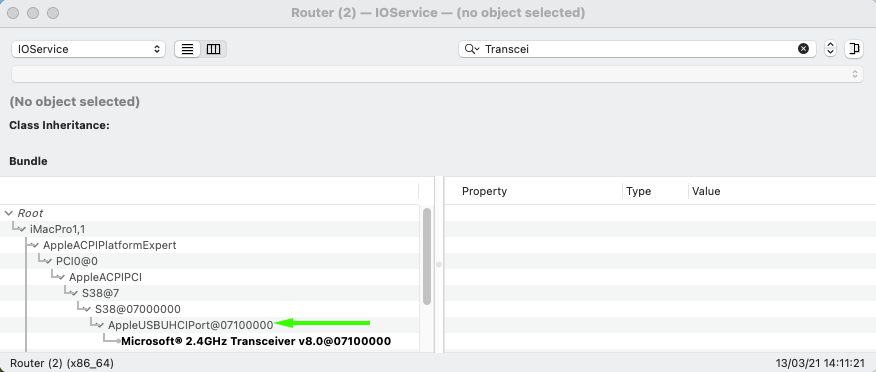

This kext was generated with Hackintool, the UHCI controller appears "different" from the other controllers in the IORegistry tree (look at the pictures below).
CFBundleName and CFBundleIdentifier modified (must be different for each kext injected).
Fresco Logic and EHCI (EHCI not shown) appear under pci-bridge@x,x (x,x=2,3 for Fresco)-->IOPP-->pcixxxx,xxxx@x
UHCI controller appears under S38@7 instead of a bridge:
So for usb power properties make sure they appear correct both in AppleUSBHostResources and also in each usb controller.

Thanks.
I was able to have the same result as you fully explained where the problem is.
Yes the audio dropout I can say it slightly better now, need more testing but there is improvement.
300470652_ScreenShot2021-03-13at23_06_42.thumb.png.d50e5921d7ca29e0263595d2ae119f98.png
631757023_ScreenShot2021-03-13at23_05_41.thumb.png.fb8a3609559c0382a2746cc73a85588a.png
999181411_ScreenShot2021-03-13at23_35_48.thumb.png.889f82b0689096d99698074ae409ccd8.png
Here is the iPhone connected to the AsMedia hub.
If you spot something I didn't apply correctly just let me know happy to test :)

Real Imac Pro 1,1 still has the USBX device with power properties (so the SSDT with USBX is ok), not sure about the EC injection (but it doesn't hurt to add it too).
Power properties need to be added with kext injection: this is the USB map kext (needed to map usb ports in case a controller has more than 15 ports) with the addition of power values --> in my attached kext there's no ports map, since I don't need it, as my number of ports is lower than 15 for each controller.

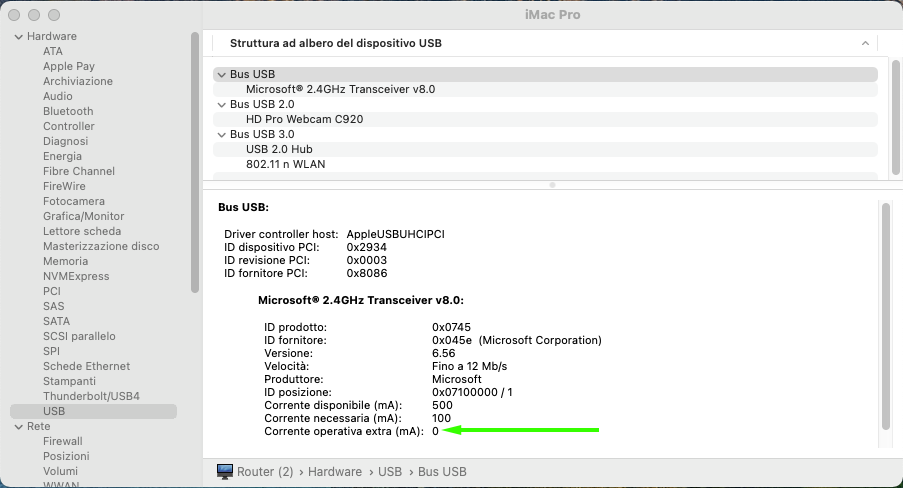

Can you test a little thing out of curiosity...
Connect your iphone to your asmedia and go to apple menu -->  about this mac --> system information
Then go to USB (on the left), select your USB bus to look for your connected iphone; can you see applied extra current?
Extra Operating Current refers to a special feature that Apple Macs support in relation to other Apple devices whereby under the right circumstances they can provide additional power (i.e. above the standard amount) to those connected devices.
One of the "right circumstances" is The connected device actually requires the extra power for some reason: I don't know how it works, maybe you should see Extra operating current different than 0 if your iphone is charging?

As far as your audio issue I read a lot of comments on apple discussion forum and it seems you're not alone, as you know too, so there's a high probability that the issue is with big sur itself..
I was able to replicate your kext setup, I combined them in USBPower-ALLINONE.kext.
I did map my USB probably using USBMap.
I Will give you more feedback about the audio issue but its better than before but I think its related to BigSur more than USB power.
When Using Catalina VM work perfect.
Yes the right circumstances was USB-C Cable and maybe iPhone that support fast charing? I am not sure as I only have iPhone XS and that support Fast charing.

On 3/14/2021 at 8:54 AM, ghost82 said:
It should be ok as far as I know..
Here are some replies from vit9696 about usb power properties, which may be useful:
Questions:
1. Does specifying the properties for the XHC device or via PciRoot - which in the end is the same thing - have any relevant impact/change on correct USB power management?
2. Are these two methods doing the same thing?
3. Is SSDT-USBX enough for handling USB port currents or maybe needs some more properties?
Answers:
1. On IOUSBFamily (pre-10.11 if I remember correctly) it does and works correctly. Required to be AAPL,-prefixed properties. On IOUSBHostFamily these values are ignored I believe.
2. Using DeviceProperties and _DSM is about the same thing as long as you can specify the device path in DeviceProperties (for USBX you cannot for instance, since it is not a PCI device) and as long as the device exists in ACPI.
3. Depends on the hardware. For Haswell you must specify the values in the plist of the kext describing ports. For Skylake I experienced mixed results. Most likely you need to specify them in both places to get reliable behaviour. Easiest to check is to try charging an iPad.
This confirms that ssdt for usbx and usb port/power injector kext should be the correct way to go.
