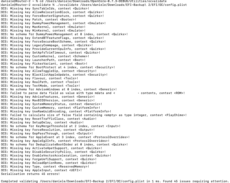

@paulmorabi
A lot of errors in the config.plist :)
When you update the bootloader you should always check the config.plist for added/removed entries, and before rebooting, always use ocvalidate to validate the config.plist.
Here was your config.plist verified by ocvalidate:
Try the efi I sent in pm and let me know.
All is updated and config.plist is fixed-
Edited by ghost82

43 minutes ago, ghost82 said:
@paulmorabi
Thank you so much for this. Normally I read the release notes and look at the section for breaking changes but otherwise leave as is (I thought, mistakenly, this would be OK).
