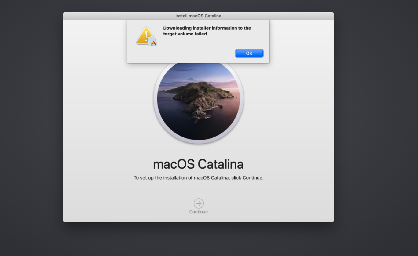

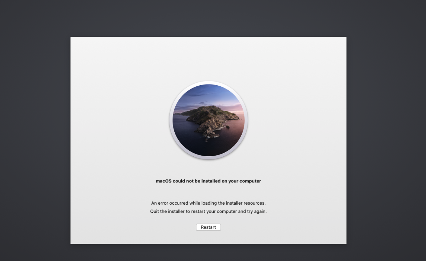

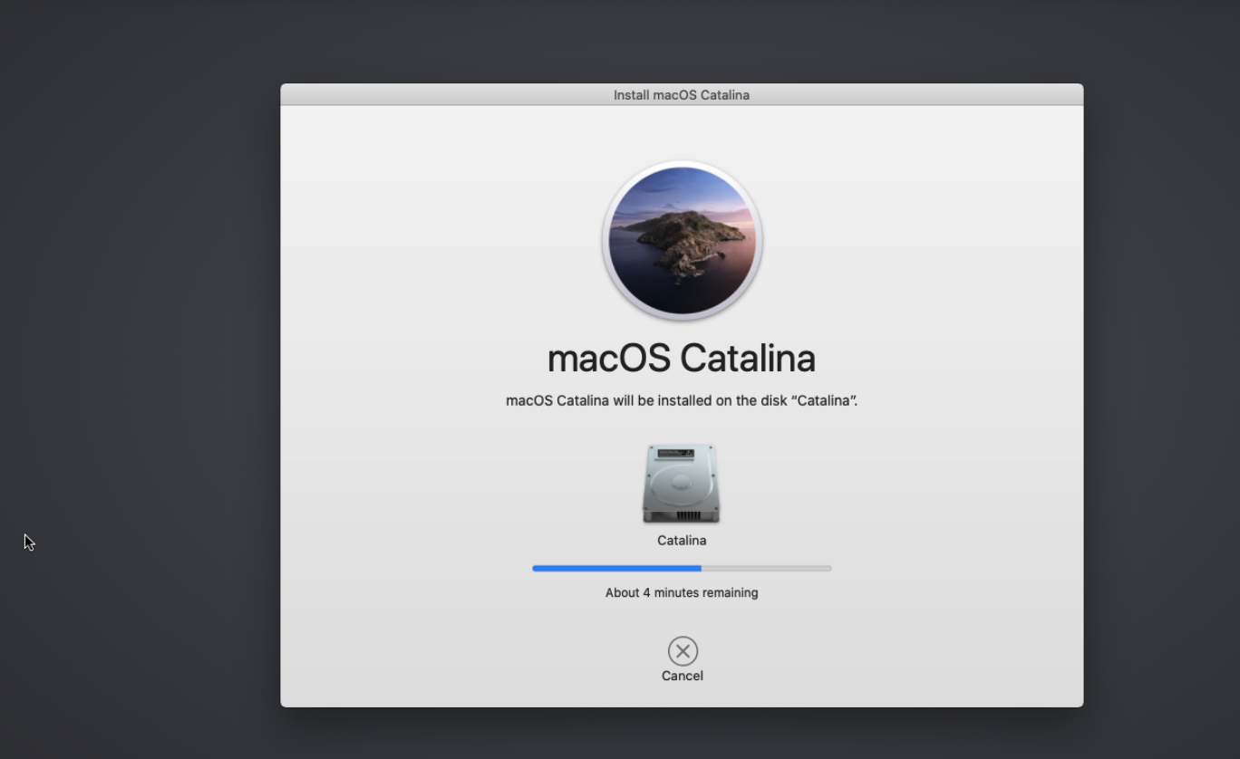

I am not able to install with the error in the picture and if I ever do, then in the next boot screen it says it could not load and resets
EDIT 1
ok after 1000 tries it got to this screen and will show you the next..
EDIT 2
after that it comes to the black  one and stays there for a while
EDIT 3
and finally goes the the third one and no matter how many times i reboot it won ever go out of there...
any help?

2020-09-20 02:12:03.438+0000: Domain id=3 is tainted: high-privileges
2020-09-20 02:12:03.438+0000: Domain id=3 is tainted: custom-argv
2020-09-20 02:12:03.438+0000: Domain id=3 is tainted: host-cpu
char device redirected to /dev/pts/1 (label charserial0)
the xml is as it comes out of the box from macinabox untouched
OK SO IT TURNS OUT THAT IT WAS A DNS PROBLEM, TESTED THE 8.8.8.8 and nothing then the 1.1.1.1 and done.. installed perfectly
Just in case someone else out there finds the same issue
