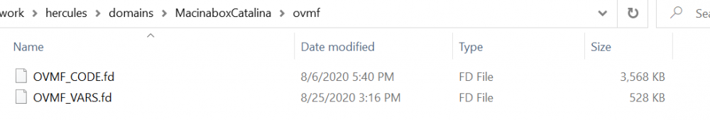

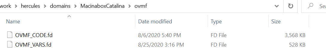

press esc to enter ovmf bios settings.
Edited by ghost82
I think you mean that once inside the clovis “menu” you need to select restart clovis, THEN hit F2 to get in the actual bios. That is the only way i can get in some bios and get to set a resolution.

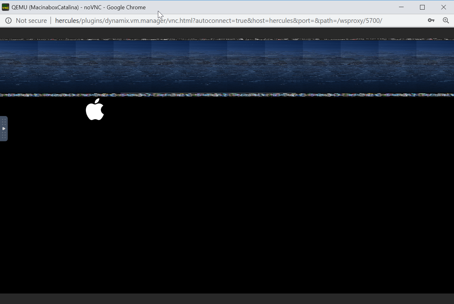

Hello, I have this kind of problem. w=When I add boot flag -v to clover VM starts like this in VNC
same goes for GPU passthrough (desktop on left is my LG 34 split into 2 sourceD DP and HDMI)
image.thumb.png.88372e42b3ffa5eff90f3c5344e89118.png.5b5fe30cc89baa0bd9473ede479a29b9.png
I've tried to change resolution during boot but nothing really works
IMG_3336.thumb.jpg.9d70434553f4ca9b23c86ad515abc246.jpg.0cde7f1e1855df4c15a759d3a240589b.jpg

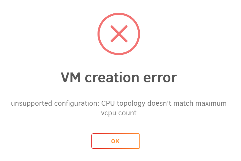

Been playing with this epic container for a few days.  I've had some good success in my test setup, including passing through a GTX 970 to HighSierra, though I didn't get the HDMI audio to work.  New components are on order, planning to build a new Unraid system with ATI cards for Mac and Windows compatibility.
Question that i have is, is there a preferred method to install multiple instances of MacVMs? The Macinabox Docker puts them in the OS's in the same spot.  I have a Catalina and a Sierra, though through my misunderstanding i ended up creating kind of a mess because i didn't understand what the "VM Images Location" field was doing.  I assumed that i would want to change that for each install, but, clearly that was not the intent. Anyway, i'm assuming that i can just move and rename the the  macos_disk.img file to a different location and run the docker again? If i move the .img, do i take the Clover.qcow2 with it?  Is there a best practices way to do this?
As the youtube video created for this app on how to use it was done in 2019 is this video still relevant on how do play around with move advanced settings?
So upon installation of Macinabox, CPUS 0 and 1 are assinged to the VM. When I got to change this default from 0 and 1 to, say, 8 and 9 and start my VM, I have a display error. Do we have to keep CPUS 0 and 1 assigned to Catalina since we set it up with those CPUs?
No, you can change CPU assignments, but the XML contains other custom bits that gets wiped out when changing CPUs via the unRAID GUI.
So you have two options:
1. Edit the CPU assignment directly in the xml (swap to advanced view in unRAID)
Or
2. Make a copy of the original xml, then edit CPU assignment in the GUI, save, switch to XML view and paste in all the bits that got removed from the original xml (from memory it’s the ovmf path and the block of custom arguments at the end of the xml)
Either way you need to understand a bit about the xml structure, and it helps using a text editor that lets you compare two text files.

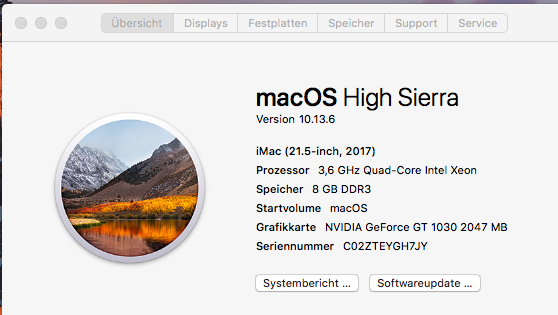

Finally i also got my mac VM working with macinabox. The key was not to adjust anything the XML using the GUI, although I used to consider the few lines at the bottom - that crashed my VM all the time. Then I figured out that once I adjust anything using the GUI, not only the custom code will be gone, this will basically change everything (model types, bus assignments, etc.). Then I decided to keep the preconfigured xml as it is and only add my lines for passthrough dedicated graphics and keyboard as well as change the assigned RAM and CPU cores directly in the xml view.
My steps (used at the end High Sierra at is has most compatibility with Nvidia):
1. Setup the VM by using macinabox (awesome docker, mate @SpaceInvaderOne!!)
2. ran through the installation process of High Sierra using VNC
3. in macOS started Clover Configurator
   3.1 mounted the EFI and loaded the plist
   3.2 SMBIOS -> changed to iMac 18,1 and refreshed UUID and serial + ensured that the UUID is not in use by someone
   3.3 Sys Parameters -> activated Nvida Webdriver
4. installed TeamViewer and activated unattended remote access
5. Turned off the VM
6. edited VM -> Switch to xml view
   6.1 increased memory for both lines to 8388608 (8GB RAM)
   6.2 added two more cores (number of cores entries in lines 14 and 31 have to be increased to 4)
   6.3 adjusted the maschine to the latest pc-q35-5.0 (i'm already on 6.9b25)
   6.4 changed the model type for my internet bridge to e1000-82545em as the type in standardprofile did not allow to login to Apple services (e.g. iCloud)
   6.4 copied the four entries starting with <hostdev [...] until ending with  </hostdev> from my Win10 VM. The four entries are my USB devices I want to pass
        through as well as my Nvidia GT1030 (video + sound)
   6.5 inserted the entries before line  </devices> almost at the bottom of the xml
   6.6 deleted the entries  <graphics .... and <video ... as they are one necessary for VNC
   6.7 saved the xml and bootet the VM
7. as picture on my TV (attached to the GT1030) looked as distorted as expected, I switched to TeamViewer
8. opened the Terminal, pulled and installed the nvidia driver by using the command posted by @SpaceInvaderOne
       bash <(curl -s https://raw.githubusercontent.com/Benjamin-Dobell/nvidia-update/master/nvidia-update.sh)
9. rebooted and done.
At the end it was a lot of trial and error and especially editing the xml using the unraid GUI which everytime crashed the VM completely cost a lot of time and effort. But as soon as I realized not to touch the GUI at all and just edit the xml directly, it went smooth.
What I forgot to mention: After step 5 I made a copy of the xml file and created a new VM using this xml file (with adjusted VM name and UUID) to have two VMs with the same disk. One low-end VM for VNC (2 cores + 4gb RAM) and one more powerful for my TV (4 cores + 8gb RAM + dedicated graphics).
Fun fact: my 400 EUR "NAS" virtualizing macOS has more performance in macOS with 4k than my 2018 1600 EUR MacBookPro does with 2k Retina.
Coming to the bad news: I did not manage yet to have audio (although passed through with my nvidia graphics) and bluetooth (onboard intel bluetooth chip; also passed through -> same way as in my Win10 VM for which it works perfectly) . Do you guys have any idea?
Thanks!

So, why can i set all kinds of resolutions in my (spaceinvader inspired) Windows 10 VM, but i can only select 1920x1080 in OSX? (even if i set the clover? bios to 2560x1600) What is the trick for adding more resolutions in OSX? I’m using vm’s through chrome remote desktop btw so remote always.
Edited by jowi

Is there a (easy) way to have the VM run from a passthrought NVMe drive?
So this is what I'm dealing with. Any suggestions?
Read the recommended post at the top of every page in this topic.
Yeah that just broke the VM
Edit: Here's my domains folder. Clearly the file is there
Edit 2: Deleted the VM, disks, and folder in \domains\. Let's try this a 15th time.
Edited by uktz
Alright, new issue. Trying to add more cores via the XML, and i'm getting this error
XML:

Any help?
Edit: Nevermind, just saw
<cpu mode='host-passthrough' check='none'>
    <topology sockets='1' cores='2' threads='1'/>
  </cpu>
and changed it to 4 cores 1 thread. fixed the issue
