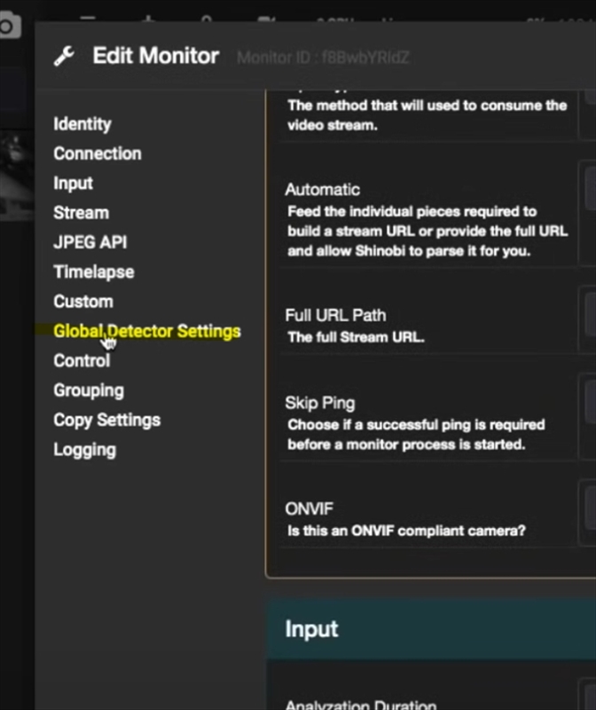

Hi
I have updated via :8080/super
Now I have errors "TypeError: s.getConfigWithBranding is not a function"
I have tried following https://hub.shinobi.video/articles/view/sIuhLW2A0E8A7K3
So I opened the docker console
sh UPDATE-v2-to-v3.sh
which failed
sudo apt update results sudo not found!!!!
Am I using the right console???
Thanks

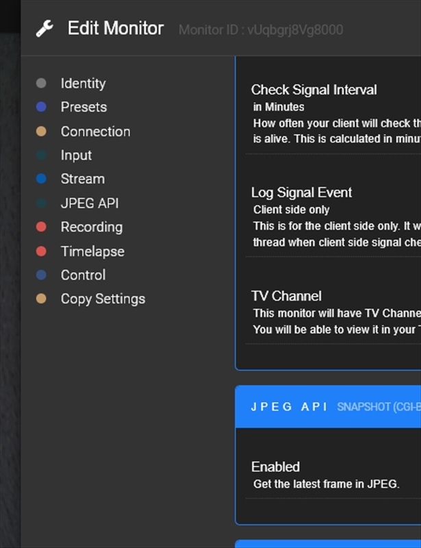

I ended up creating a new docker using ivaxor/shinobi build - much better interface (probably just the current update?) and is working great so far!
Update function works also.

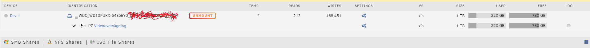

Have been receiving the following error in Shinobi.
From the docker logs:
Error: ENOSPC: no space left on device, write
    at Object.writeSync (fs.js:679:3)
    at Object.writeFileSync (fs.js:1393:26)
    at /home/Shinobi/libs/video/utils.js:60:20
    at new Promise (<anonymous>)
    at scanForOrphanedVideos (/home/Shinobi/libs/video/utils.js:48:16)
    at ChildProcess.s.group.<computed>.activeMonitors.<computed>.spawn_exit (/home/Shinobi/libs/monitor.js:740:17)
    at ChildProcess.emit (events.js:314:20)
    at Process.ChildProcess._handle.onexit (internal/child_process.js:276:12) {
  errno: -28,
  syscall: 'write',
  code: 'ENOSPC'
From the Shinobi UI:
rubmKbNjnE : Jk7abxh8IV
FFMPEG STDERR23 minutes ago
DTS 152155370626041, next:3300000 st:0 invalid dropping PTS 152155370626041, next:3300000 invalid dropping st:0
I don't believe I have any space issues.
Here is df -i from Unraid:
root@Unraid:~# df -i
Filesystem              Inodes  IUsed      IFree IUse% Mounted on
rootfs                 4077432   5060    4072372    1% /
tmpfs                  4080912    969    4079943    1% /run
/dev/sda1                    0      0          0     - /boot
overlay                4077432   5060    4072372    1% /lib
overlay                4077432   5060    4072372    1% /usr
devtmpfs               4077435    591    4076844    1% /dev
tmpfs                  4080912      3    4080909    1% /dev/shm
tmpfs                  4080912     85    4080827    1% /var/log
tmpfs                  4080912      2    4080910    1% /mnt/disks
tmpfs                  4080912      2    4080910    1% /mnt/remotes
tmpfs                  4080912      1    4080911    1% /mnt/addons
tmpfs                  4080912      1    4080911    1% /mnt/rootshare
/dev/md1p1           781402624  70465  781332159    1% /mnt/disk1
/dev/md2p1           781402624  32376  781370248    1% /mnt/disk2
/dev/md3p1           390701824  32942  390668882    1% /mnt/disk3
/dev/md4p1           390701824   7001  390694823    1% /mnt/disk4
/dev/md6p1           781402624  14197  781388427    1% /mnt/disk6
/dev/nvme0n1p1               0      0          0     - /mnt/cache
shfs                3125611520 156981 3125454539    1% /mnt/user0
/dev/sdg1            488381248   1415  488379833    1% /mnt/disks/Videoovervågning
/dev/loop2                   0      0          0     - /var/lib/docker
//100.121.90.81/NAS          0      0          0     - /mnt/remotes/100.121.90.81_NAS
And from the Shinobi container:
tmpfs            4080912    16   4080896    1% /dev
shm              4080912    49   4080863    1% /dev/shm
shfs                   0     0         0     - /config
/dev/loop2             0     0         0     - /customAutoLoad
overlay          4077432  5060   4072372    1% /usr/share/zoneinfo/UCT
/dev/sdg1      488381248  1415 488379833    1% /home/Shinobi/videos
tmpfs            4080912     3   4080909    1% /dev/shm/Shinobi/streams
tmpfs            4080912     1   4080911    1% /proc/acpi
tmpfs            4080912     1   4080911    1% /sys/firmware
Don't however understand the numbers on /home/Shinobi/videos as they do not seem to match my HDD:
Anyone have an idea what could be the issue?

Hello! sorry for my bad english.
I just installed shinobi on unraid with 2 RLC-410 5MP reolink camera. it work fine 😊
But I can't find "global detection setting" on edit camera:
234724
On spaceinvader video "global detection settings" appears...:
234725
How can I activate detection?
Thank you in advance 😊
Edit : ok It's vey simpply.. juste pass simple to advanced view... shame on me 😅
Edited by calagan57
