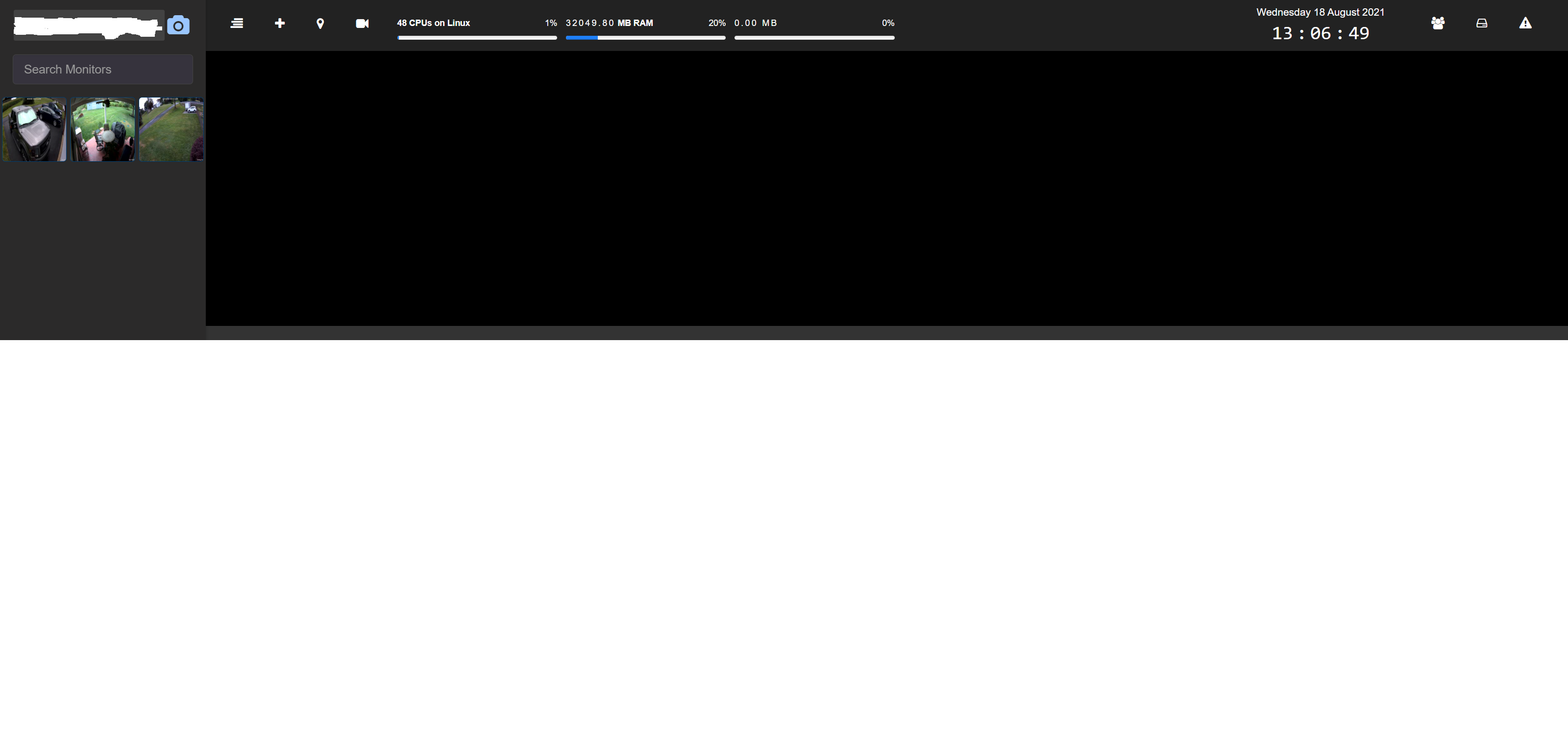

I have Shinobi set up and have added three of my cameras in Watch-Only mode (don't have a separate hard drive to record to yet).  You can see they've populated perfectly fine in the side bar on the left, but when I add them to the main dashboard area, they just display black.
I'm able to see them without issues via web streaming or the mobile app.  I've attached a picture for reference.  Anyone have suggestions on how to get them to display?
I had a similar issue to @snowborder714 but my setup was working one day and then not the next. I found the same display behaviour was occurring with my issue which ended up being that I ran out of HD space. I removed some files and as soon as Shinobi could write to the disk again, the main image re-appeared. I thought I set Shinobi up to record continuously and to overwrite files when the disk became full.
Now to try and figure out why it is writing files with root:root (I'm sure it is something I have done, or not done!).
