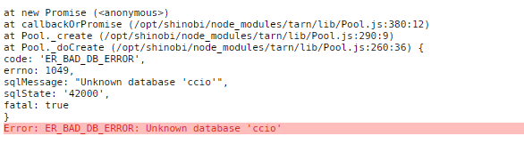

    July 29 2020 On new installs it is now necessary to manually install the database files on first run. Going to http://xxx.xxx.xxx.xxx/8080/super  and logging in you will see this

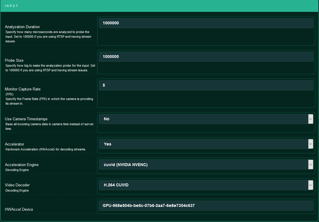

Hello, I've installed shinoby from repository spaceinvaderone/shinobi_pro_unraid:nvidia and when I configure camera I cant see Motion Detection settings. Who can advice something?
I found - need to switch to Advanced.
Who can share settings with NVidia acceleration settings for Cameras. I've deployed container with NVidia parameters but when I setup NVidia acceleration in Cameras settings I cant see Image and cameras not working.

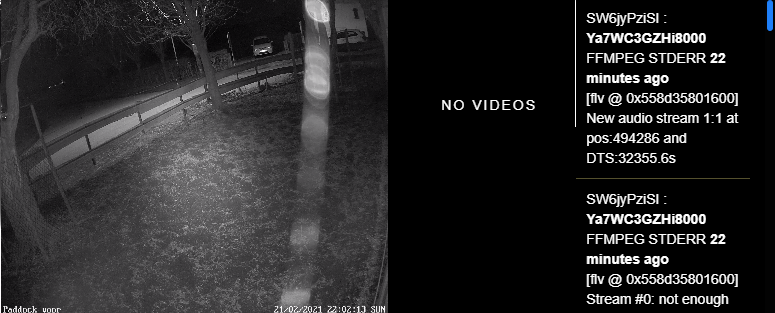

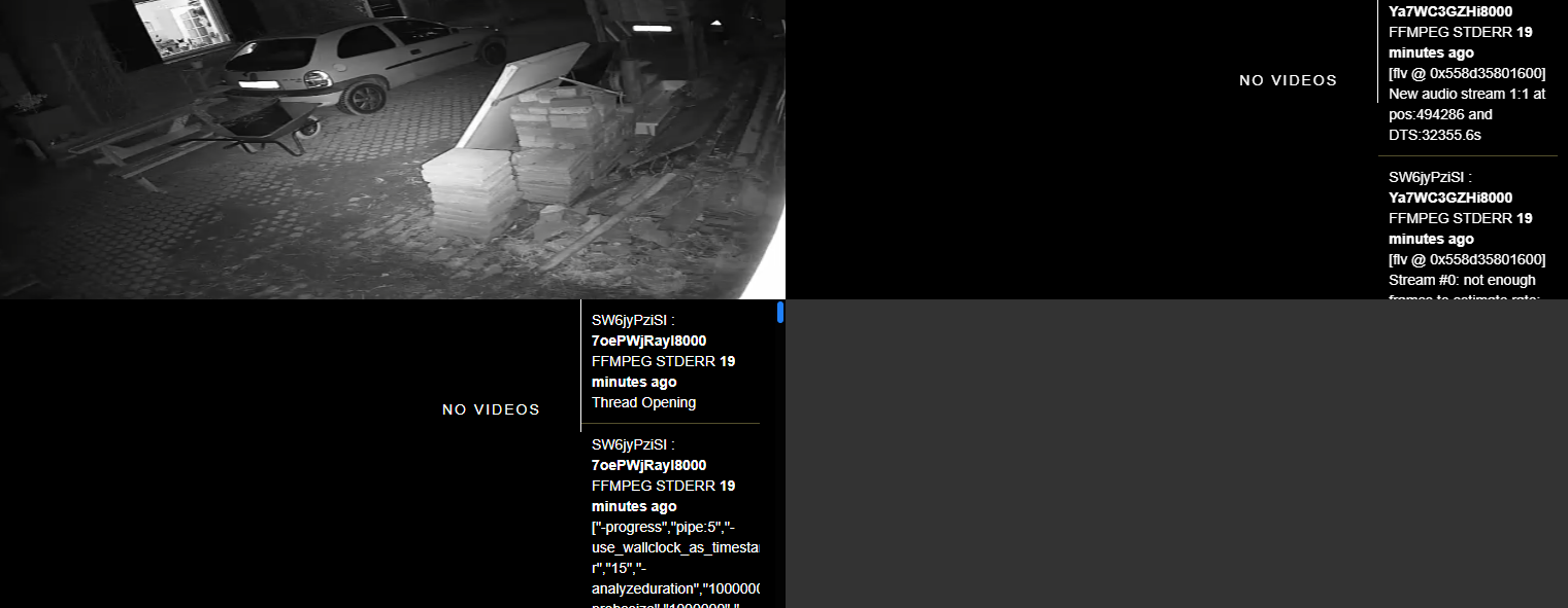

So fast forward a 'couple' days. For the Dahua camera i still have issues, i tried putting in the RTMP address (or compose one anyhow) but have failed so far. It all works, motion detection and the works, but for some reason the monitor stream (the substream) keeps blacking out. If motion occurs at that time, the vid is still made tho, so essentially no issue just quite annoying.
The Reolink camera's i have switched to RTMP (uses a bit more bandwidth . . .). Unfortunately, this does not solve the monitor's going black.
In terms of monitor's going black, i see nothing that could explain it. No errors are throw, nothing written to SQL. Both client side and server have plenty of resources available. Below a screenshot of the blacking out. As you can see, no errors, nothing. Heck they don't even do it all at the same time.
And then the stream starts up again. no messages, no errors, no nothing. . .
If anyone has any idea's, i'd love to hear them!
Edited by Caennanu

so, to come back to my original posts. It seems (for now) it all was due to bad RJ plugs.
When switching from RJ's to Keystones, the blacking out and intermittend issues seem to have vanished.
(i just have the baddest of luck when it comes to crimping RJ's . . .)

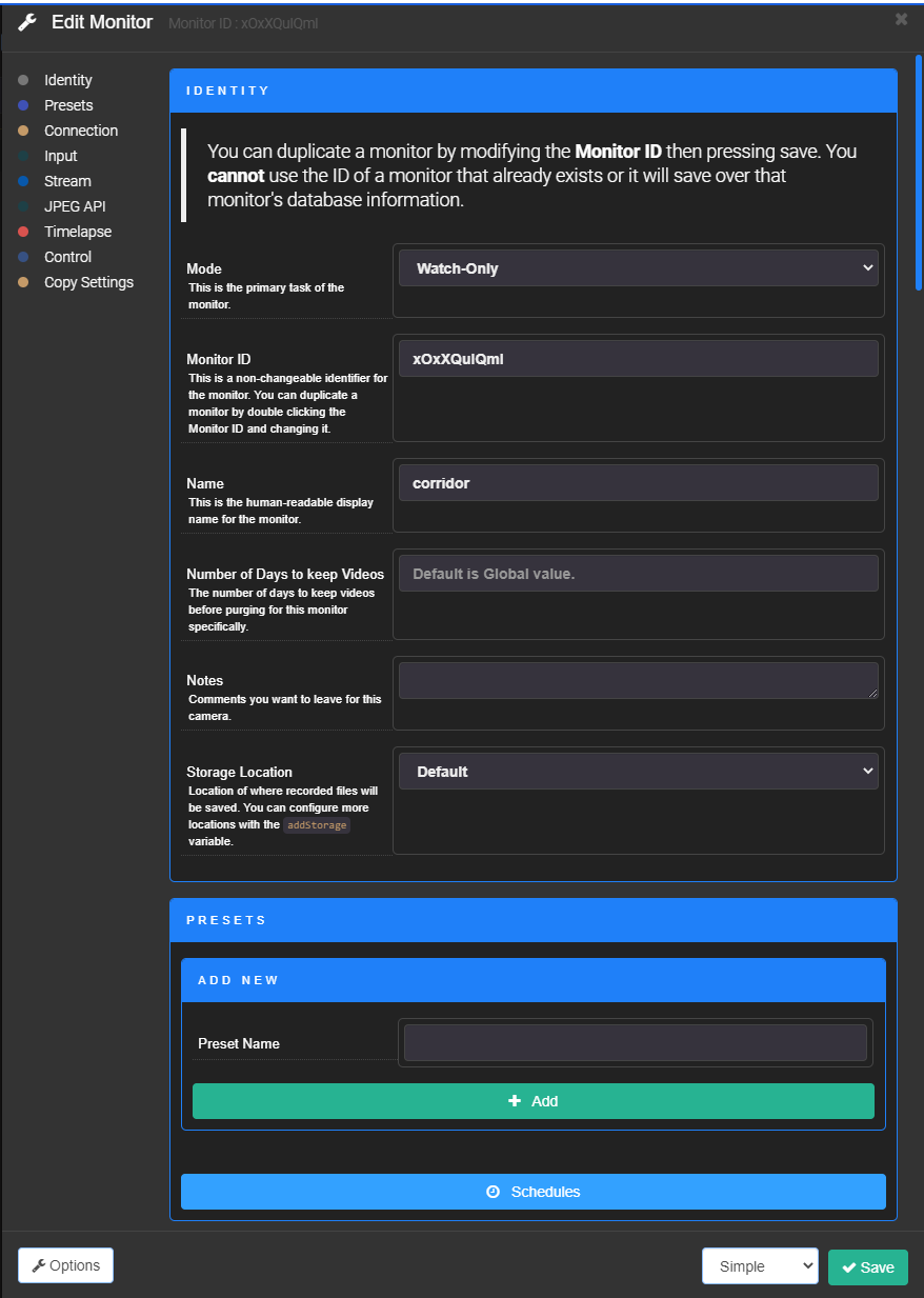

Now however i'm getting a message that my threadcount is too low.
I have not been able to find a way to increase this from the current value of 8.
Any1 who knows where i can increase this?

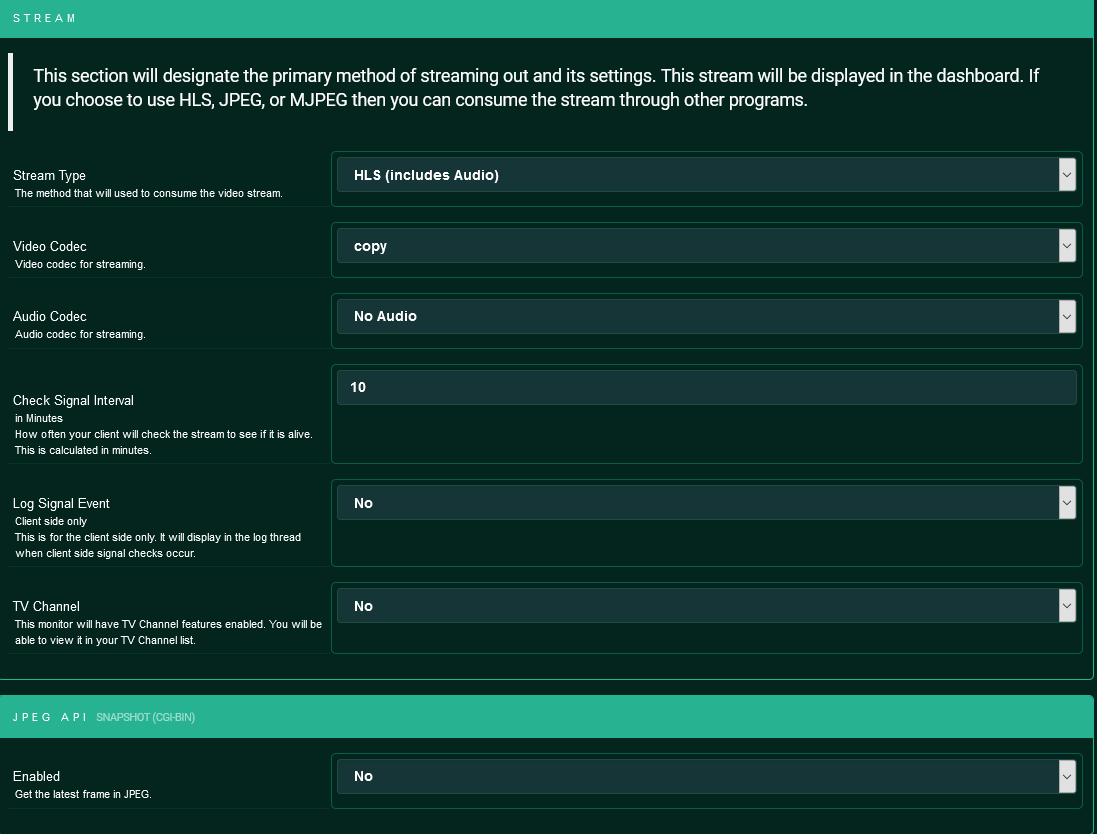

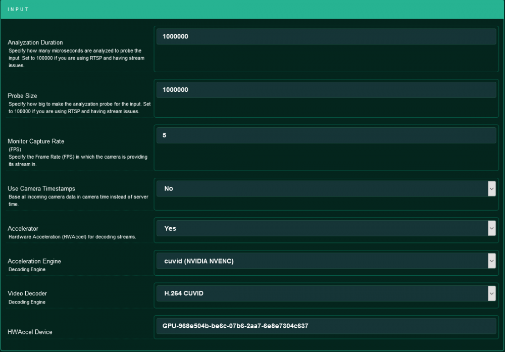

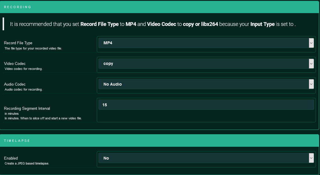

Hi guys,
after 5 days of struggling with shinobi I must say that this docker is the best one I have found if You want to use nvidia gpu. I can explain quickly.
This docker is based on Ubuntu 18.04 - which has cuda-10.2, which is the last version of cuda supporting cuda capable cards 3.0.
Here is a list, check your gpu: https://developer.nvidia.com/cuda-gpus
This docker has gpu working out of a box - ffmpeg + yolo !
My recommendation to setup camera are:
ss.thumb.png.a18f23536f66a8de7326fadd72c01142.pngss2.thumb.png.7abb08b8fef7422b9986c41b6a1e1c47.pngss3.thumb.png.635d8f43606374afbbba29a34c00053d.png
Advantage is the performance. I can see ffmpeg working on gpu. There is no cpu usage.  Sorry I made mistake when measuring cpu usage. Even if ffmpeg show it is running on gpu it still uses a lot of cpu. Be aware that when you decode using gpu, then in recording section you cant use gpu, or when you set recording to use gpu codec, then in input section you have to set to use cpu.
In conlusion, when I have added all 5 cameras 2 of them keep disconnecting. Also cpu load is not less than when using zoneminder. Only Yolo plugin seams to benefit from gpu usage a lot. For these reason I will keep using zoneminder as it is more reliable for me, all cameras work fine.
To asses update matters. Run console and type sh UPDATE.sh
Then your shinobi will be updated. Of course if you change anything in container settings it will reverse back to original version from image. That is how dockers are superior over lxc or openvz :) :D

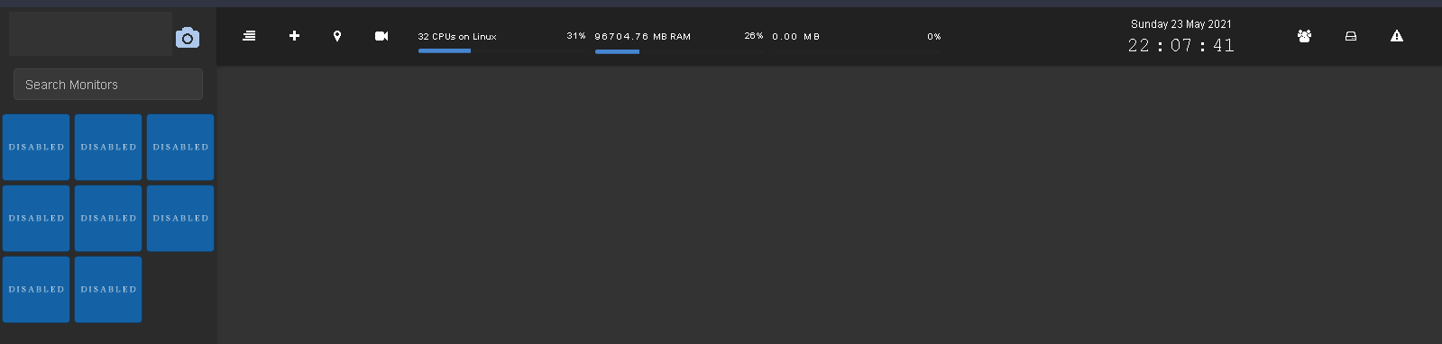

I have strange problem with my Shinobi. I've setup recording two 30 days and files are present on disk but from application interface I can only see last two days. What should I do to change this? Is this some kind of limitation or bug?
3am this morning Shinobi stopped recording all of my cameras, and the web UI shows all the monitors as 'disabled.'
if I go into the properties of each, they're all marked correctly; either 'watch' or 'record', but none are doing their tasks.
Thinking maybe my storage drive took a dump, I changed it out, and it recorded for about 5 minutes.  All of that footage is totally worthless as it's corrupted.
Anyone else suddenly having problems?
ETA: I just realized while I was poking for the backups, I run a backup once a week, at 3am, and it ran this morning.  only shinobi appears to be affected.  going to attempt to just restore shinobi from last week.
ETA2: ok, didn't complete the restore. noticed the database folder was 906MB in size.
-rw-rw---- 1 100 console 801112064 May 23 18:40 Timelapse\@0020Frames.ibd
is the biggest offender.
stopped the container, renamed that file (for now), started it, and now it's recording again.
none of my monitor groups are working though.  I can live with that for now, as I really only use shinobi to do 24/7 recording of the cameras, and take stills every 6 seconds or so.
ETA3: monitor groups started working again, after I manually added a couple cameras to the view.
