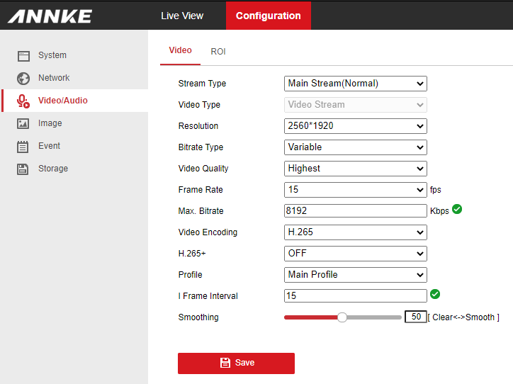

Guys did anyone been able to run live stream in H.265 / 265+ codec? Soon as i turn H.265 on Camera (Web UI setting) it stop to work (just black screen). Soon as i turn it back to H.264 it works again.
image.png.53ef855a3fbe412271cbe84d7abb7a56.pngimage.thumb.png.7214049d612de4033d71672571c11d41.png
I thought that H.265 its already wide used (lower data consumption), but if Shinobi is not really able to use it, then its not very usable as of today.
@SpaceInvaderOne in Video p.3 you mention that you had issues with H.265 so you are using the H.264. Just to confirm issue was with Shinobi same as i have? Not with the camera it self?
On NVR device or NVR via Web or Guarding Vision works everything fine...even on the iSpy i was able to get picture/video, not on Shinobi which is sad :(
Thanks
@killeriq I display in H264 and record in H265. But I think it is an issue of browser video support...

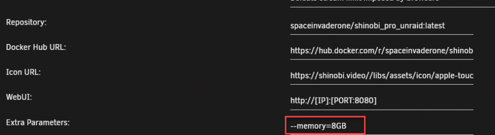

On 12/2/2020 at 12:13 PM, crspangenberg said:
I also had an issue with Shinobi utilizing all remaining available RAM on my server and locking up Docker. A few times I had to completely reboot the non-responsive server. Narrowed it down to Shinobi and went back to Zoneminder until I could find a fix. Have you been able to find anything?
force the docker to use less memory.
extra parameters: --memory=8G
I do that for my setup.

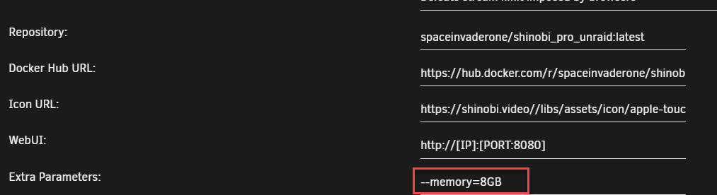

Thank you for that information, would you mind posting a screen shot as an example? This would be the first time adding an extra parameter.
Thanks Again!
Thanks Again!
It looks like this:
Thanks for tip i wil try...
General question is : How can today app "Shinobi" be that behind with support of new codecs? Or if we say browser - those are most updated apps on internet i would say ;) Firefox, Chrome etc. should have support for that
The WebUI for those chinese cameras video live view, have some plugin to install , but it works only on IE or IE Tab extension within other browser.

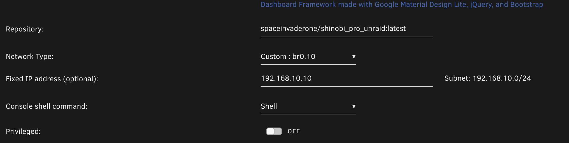

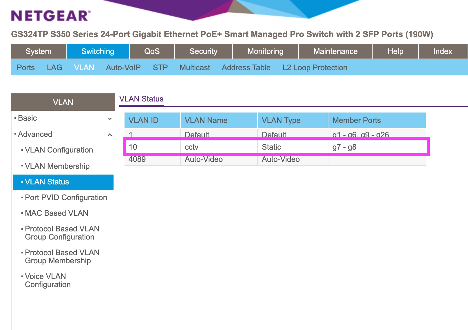

Apologies in advance for my lack of networking savvy here.
Was following spaceinvader's incredible tutorial for setting up Shinobi. Am using the same switch as specified in Part 2 of the series: GS324TP S350 Series 24-Port switch.
So my issues are two-fold:
  1. Unsure how to set/determine the IP of my VLAN eg ports 7 & 8.
  2. As a result of 1, can't access Shinobi docker web UI.
Thank you in advance!
