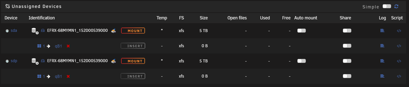

Searched around the forums and google, but I couldn't find anything similar to my problem, I probably just didn't know how to word it. Could be this plugin, Unraid itself or just a HW issue.
  • Situation: I have a Mediasonic ProBox HF2-SU3S2 4-bay USB/eSATA external enclosure that I use via USB for temporary connection of random HDDs and utilize the Unassigned Devices plugin to mount/share them as required.
  • Problem: What's occurring is that if I connect 2 drives of the same model (5TB WD Reds currently), they show up separately, but are treated as the same drive. For instance, they display the same Identification, but different mount point (SDA vs SDP). Additionally, I can mount one of the drives succefully, but attempting to mount the second drive results in nothing happening. I've attached a screenshot of my UAD panel.
I'm currently not sure if this happens with differing capacities but similar "models" (WD Red 2TB vs 4TB), but I have verified using dissimilar disks works as expected. Lmk what extra info would be helpful, and thanks in advance!
It looks like your enclosure backplane is presenting identical drives to unRAID with the same serial number/disk ID.  unRAID tracks drives by serial number/disk ID, not by sdX number, SATA port, drive bay, or anything else.  When unRAID sees the same serial number/Disk ID, it cannot distinguish between the two disks.
See this thread for a discussion of similar issues.
AFAIK, there is no resolution unfortunately.  The enclosure is making the disks appear to unRAID to be the same drive.
Thanks, I was hoping that wasn't the case. Oh well, lol.

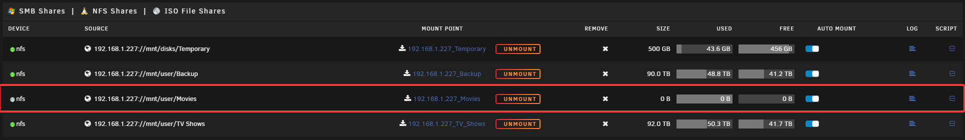

I'm getting some errors in my log regarding remote NFS shares since upgrading the host server to 6.8.
Oct 21 02:48:56 Unraid2 unassigned.devices: Error: SMB/NFS server '192.168.1.227' is not responding to a ping and appears to be off-line.
Oct 21 02:53:20 Unraid2 unassigned.devices: Error: SMB/NFS server '192.168.1.227' is not responding to a ping and appears to be off-line.
The errors are in the logs of the computer where the remote shares are mounted. I've attached diags as well. Also attached a screenshot showing the green light and capacity changing on the remote share. I can wait a few minutes and refresh the GUI, and sometimes it will be back to normal, or maybe a different share will be grayed out. So I'm not sure if this is a 6.8 or a UD problem.
Thanks.
unraid2-diagnostics-20191021-0813.zip
Edited by drawmonster
Thanks.
UD checks the remote share by pinging it.  When the remote share is not responding, it is usually from a network issue.
You are running Unaid 6.7.2.
