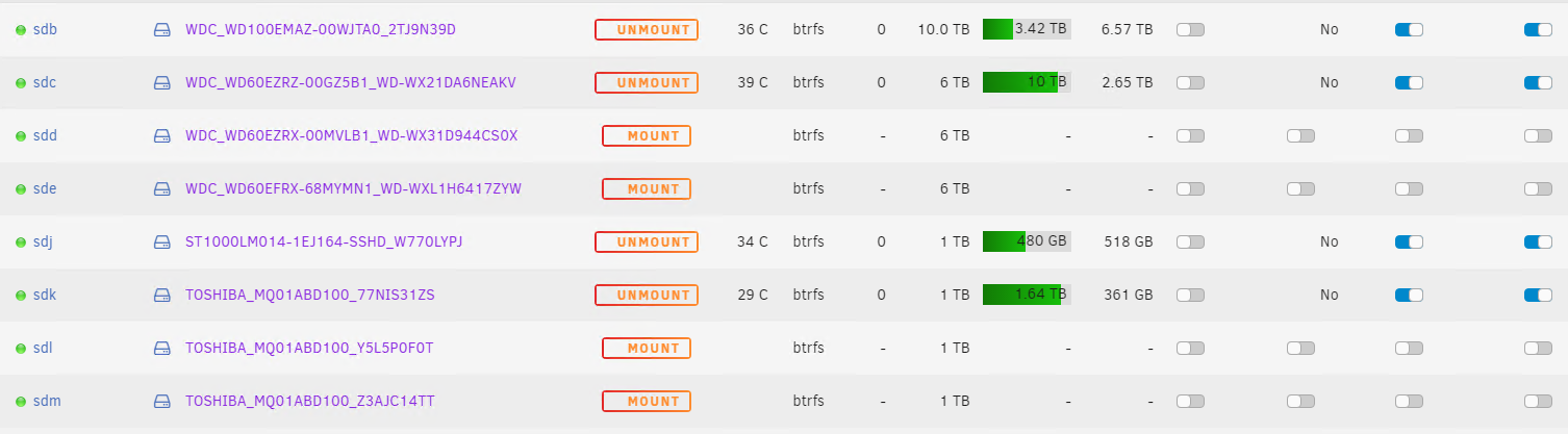

What exactly do you mean by "renaming"?
When you click on the name and it says something like "type a new name" and the that's the name of the folder under /mnt/disks/
  • Replies 11.9k

9 hours ago, bonienl said:
Duplicate serial numbers is clearly a bug at the manufacurer's side (WD).
A serial number is used to uniquely identify a product and is used in the RMA process of the vendor.
A two-bay dock presents both drives under the dock serial number rather than the drives' serial numbers.
That doesn't help at all with automount or scripting since it still has no way to decide which of the 2 identical serial numbers that name should apply to.
Sorry not following? I wasn't claiming it helps. That was my point. Is it not possible to not rename them both if we are set on serial ID being the only identifier?
UD works on the premise that each disk has a unique identifier (serial number) and was not built to handle duplicates because they should never come up.  Each disk is expected to have a unique serial number.
I think you are confused about the 'rename'.  It appears you think by setting the mountpoint name, the disk will then be unique,.  The name you are setting is the mountpoint for the disk and has nothing to do with making each disk 'unique' to UD.  The serial number is the only thing used to identify the disk.
No, I absolutely understand all that. I just mean what I say: because they have the same serial ID, it causes undesirable behaviour when using the rename function.
