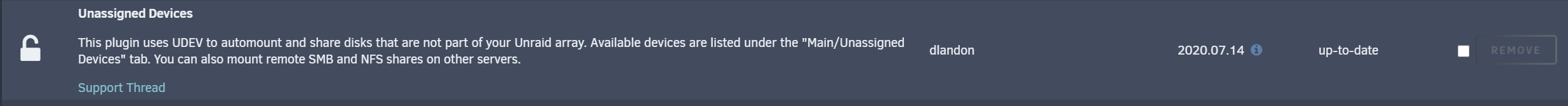

You got that error on 7/13.  The 7/14 update of UD fixed that issue.  You should not see it any more.
I have the 7/14 version already installed.
Yes.  The error showed up when 7/13 was installed.  You won't see it now with 7/14 installed.
Jul 13 13:35:06 UNRAID-1 emhttpd: Warning: array_merge(): Expected parameter 2 to be an array, null given in /usr/local/emhttp/plugins/unassigned.devices/include/lib.php on line 1627
Jul 13 13:35:06 UNRAID-1 emhttpd: Warning: in_array() expects parameter 2 to be array, null given in /usr/local/emhttp/plugins/unassigned.devices/include/lib.php on line 1630
Jul 13 13:35:06 UNRAID-1 emhttpd: Warning: file_get_contents(/sys/block/video/queue/rotational): failed to open stream: No such file or directory in /usr/local/emhttp/plugins/unassigned.devices/include/lib.php on line 635
Please note the date.
Jul 15 04:40:51 UNRAID-1 root: plugin: creating: /boot/config/plugins/unassigned.devices/packages/unassigned.devices-2020.07.14.tgz - downloading from URL https://github.com/dlandon/unassigned.devices/raw/master/unassigned.devices-2020.07.14.tgz
So if I'm still seeing it on my GUI, what do I need to do to clear it?
Reboot.
Just now, dlandon said:
Reboot.
LOL....figured.  Okay...thanks
