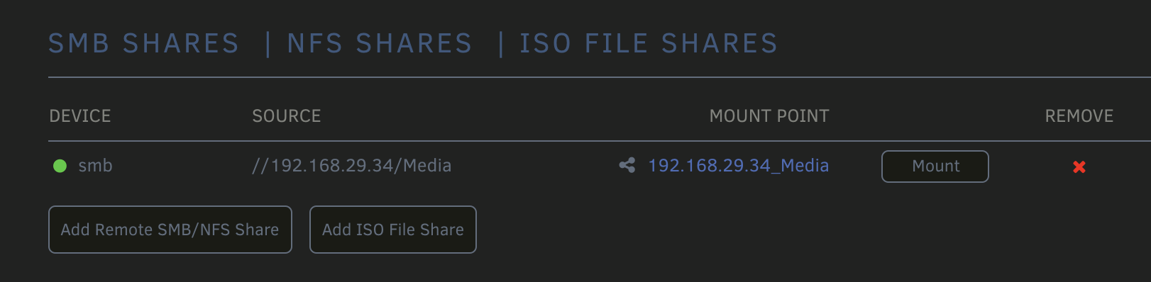

Hi there,
I am attempting to mount a share on a different unraid system. I installed the latest (as of 28 Aug 2020) Version on UD, and the UD Addon. Added the Share, Got the Success lcon, but the share will not mount.
618001452_ScreenShot2020-08-28at8_30_21AM.thumb.png.70cd321da3845228bbbce0afa63aeace.png
I tried, Searching for the System (Found and added by name), as well as, deleting it and adding it by IP (Seen above).
When I try to mount it, I get
Aug 28 06:04:09 Eyrie kernel: CIFS VFS: \\HARDHOME failed to connect to IPC (rc=-13)
Aug 28 06:04:09 Eyrie kernel: CIFS VFS: cifs_mount failed w/return code = -13
Aug 28 06:04:09 Eyrie unassigned.devices: Mount of '//HARDHOME/Media' failed. Error message: 'mount error(13): Permission denied Refer to the mount.cifs(8) manual page (e.g. man mount.cifs) and kernel log messages (dmesg) '.
Aug 28 06:05:39 Eyrie unassigned.devices: Removing configuration '//HARDHOME/Media'.
Aug 28 06:09:38 Eyrie ntpd[4558]: kernel reports TIME_ERROR: 0x2041: Clock Unsynchronized
Aug 28 06:13:08 Eyrie unassigned.devices: Mount SMB share '//192.168.29.34/Media' using SMB3 protocol.
Aug 28 06:13:08 Eyrie unassigned.devices: Mount SMB command: /sbin/mount -t cifs -o rw,nounix,iocharset=utf8,file_mode=0777,dir_mode=0777,uid=99,gid=100,vers=3.0,credentials='/tmp/unassigned.devices/credentials_Media' '//192.168.29.34/Media' '/mnt/disks/192.168.29.34_Media'
Aug 28 06:13:08 Eyrie kernel: CIFS: Attempting to mount //192.168.29.34/Media
Aug 28 06:13:08 Eyrie kernel: Status code returned 0xc000006d STATUS_LOGON_FAILURE
Aug 28 06:13:08 Eyrie kernel: CIFS VFS: \\192.168.29.34 Send error in SessSetup = -13
Aug 28 06:13:08 Eyrie kernel: CIFS VFS: cifs_mount failed w/return code = -13
Aug 28 06:13:08 Eyrie unassigned.devices: Mount of '//192.168.29.34/Media' failed. Error message: 'mount error(13): Permission denied Refer to the mount.cifs(8) manual page (e.g. man mount.cifs) and kernel log messages (dmesg) '.
Again, this is the lasted version of UD, Diagnostics attached, Thanks for the advice/assist!
eyrie-diagnostics-20200828-0835.zip
Edited by wesman
Reconfirm the name and password you are using to connect. The error says logon failure.
Yep, double and triple checked, both with Hostname and IP, its right
Anything other than letters and numbers in the username or password?
Are you sure that specific user has rights to the Media share?
I used root, but it does have "#" in the password
Well, I created a second user without the special characters, and it worked. THANKS!
Although, I am surprised that doesn't work :(
Root is not allowed to connect to shares, only SSH and webgui
Thank you for letting me know! that is news to me
