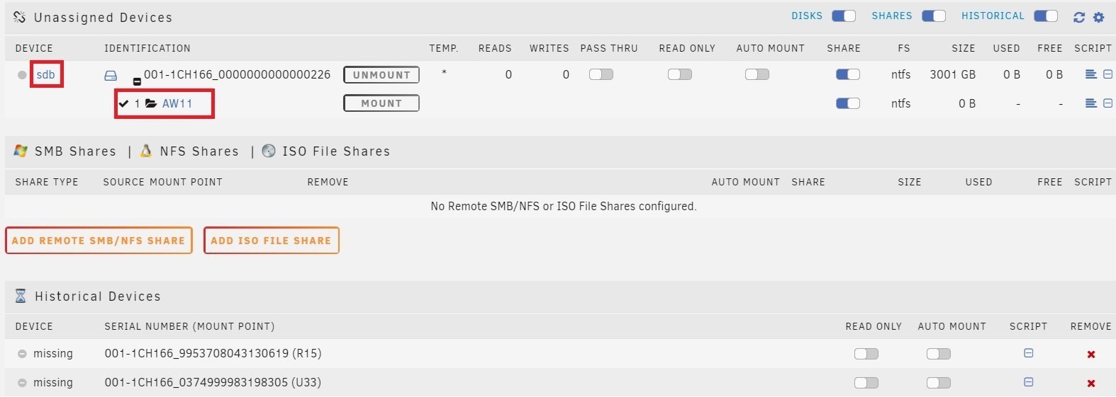

As you can see there's a device sdb with the partition AW11 shown on the Main tab. Two historical devices/partition U33 and R15 are visible as well.
On the console you can see a partition ELEMENTAL on sdb. This is an old already removed USB device. I can't umount that device.
The AW11 USB stick is attached currently and shown on the Main tab. BUT it's missing in the mount list. ELEMENTAL is shown instead. Needless to say that if I navigate to AW11 on the Main tab the folder/file list is empty.
This is the only free USB port I'm using. No way to swap USB ports, because the rest is blocked with USB license sticks passed thru to VMs.
What's happening here? And is there a way to fix that without rebooting the server?
Any help is highly appreciated.

4 minutes ago, hawihoney said:
Please have a look at the two screenshots.
Diagnostics attached.
It looks like the disk went off-line or was unplugged.  You attempted several times to re-connect it, or the port went off-line and back on-line.  I don't know how to clear this up without a re-boot.
