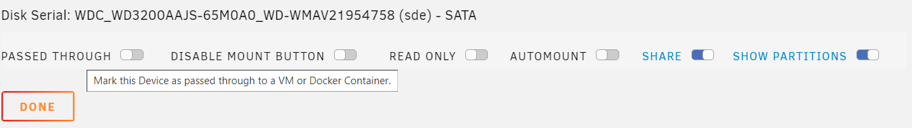

3 minutes ago, Zappmax said:
Any idea how i can "reactivate " the drive.
Turn off the "Passed Through" button in device settings:
57 minutes ago, unr41dus3r said:
I am using 6.11.2
Is there any ETA for the fixed version?
This is an Linux issue affecting Unraid and UD.  6.11.3 will be released shortly with a fix.
@dlandon thx "Passed Through" was the solution, dont know exacvtly why but it solved my problem
'Passed Through' is used to indicate a disk being used outside UD by a Docker Container or a VM.  That tells UD not to do anything with the disk, and to disable any user actions.  UD mounting a disk or clearing a disk used by a Container or VM will cause corruption or lost data,
