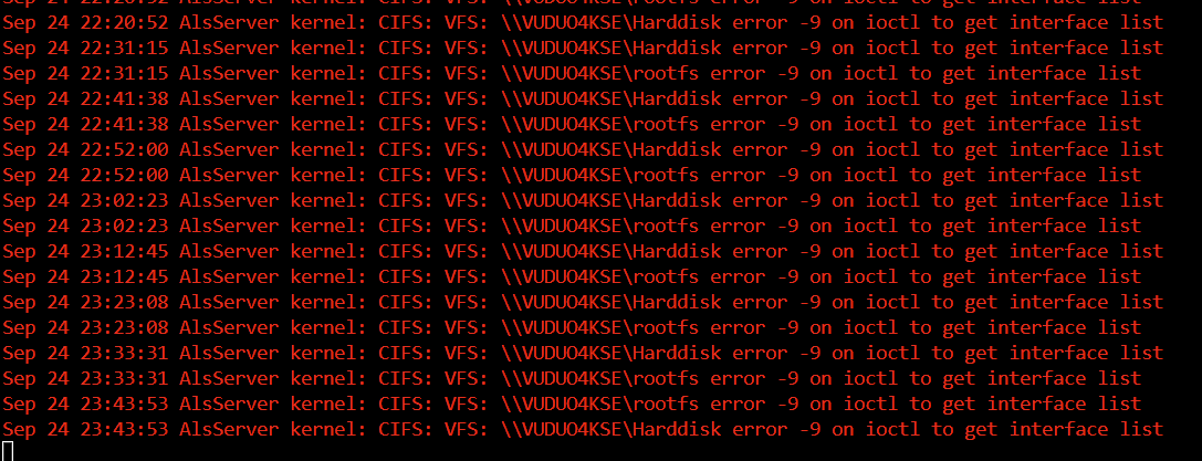

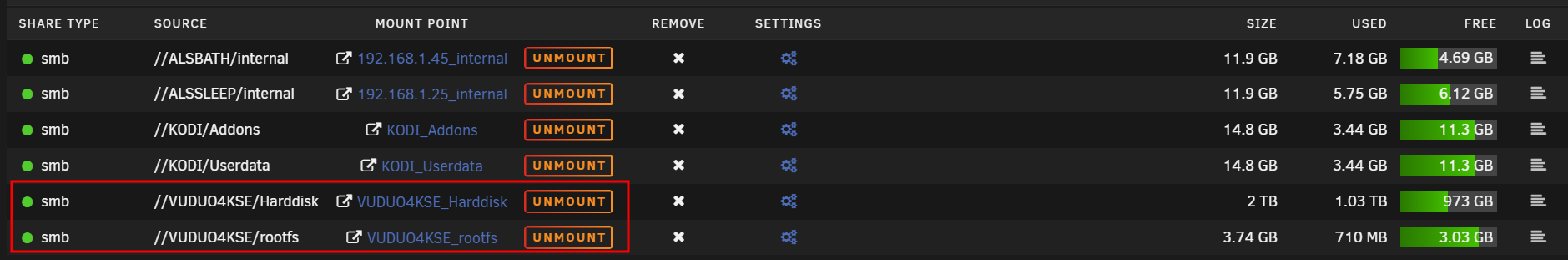

may anyone with an  idea what could cause these errors in the logs ?
a (working) remote smb share
is printing many errors in the syslog ... 24/7 since a few releases ...
more cosmtic as everything works fine ... ;)
Post your diagnostics file.
The remote server you are mounting the shares from is using the older SMB 2.0 protocol.  What is the remote server you are connecting to?
a STB (from vu+, mod. vuduo4kse) and yes, im aware of smb v2 here.
so if thats the reason, the every 10 min check will report an error due < smb v3 i assume and its normal ? even its connected and working as supposed to.
My point is that you might try to apply an update to the STB because of the older SMB protocol.  I cannot find any information on the log message you are getting.  If everything is working correctly, you can filter those log messages.  The Enhanced Log Plugin allows you to filter log messages.
