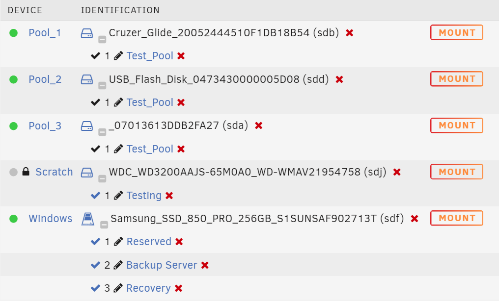

On 1/18/2022 at 12:05 PM, dlandon said:
I'm finishing up a new feature that allows you to add an alias name to a disk device and then use that name to mount, unmount, and spin down a disk.  Using this feature, you can spin down a disk when it is unmounted by changing the device script like this:
  'REMOVE' )
    # do your stuff here
    /usr/local/sbin/rc.unassigned spindown name=Scratch
After the disk is unmounted the 'REMOVE' event is sent to the device script and at that time the spindown can occur.  The caveat is that this only works in 6.9 and later.
Here is a screen shot to show how the alias naming works.
