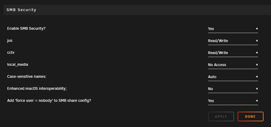

Hi all,
I hope this is the right thread to ask foa help with UD.
I have been using it for a while but in last few months I am not able to access the shared drive from windows.
\\VAULT\CCTV    is the path i am trying to use in windows. Also tried \\VAULT\mnt\disks\CCTV
Things i tried:
  1. Unmount -> Mount
  2. Disable -> Enable share on device
  3. Rename mapping to something else
only thing that did work is the workarround from some other post were i would expose the share from command line, but that then needs to be remembered and causes some other issues later down the line...
I am trying to get to the bottom of why the share is not appearing
Any pointers what i could try more apprechiated,

Check the UD Setting for SMB Share.  "No" turns off sharing.

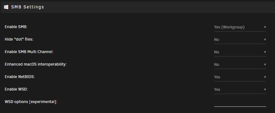

How do you have the SMB Settings setup?  WSD and NetBIOS.
Yeps
