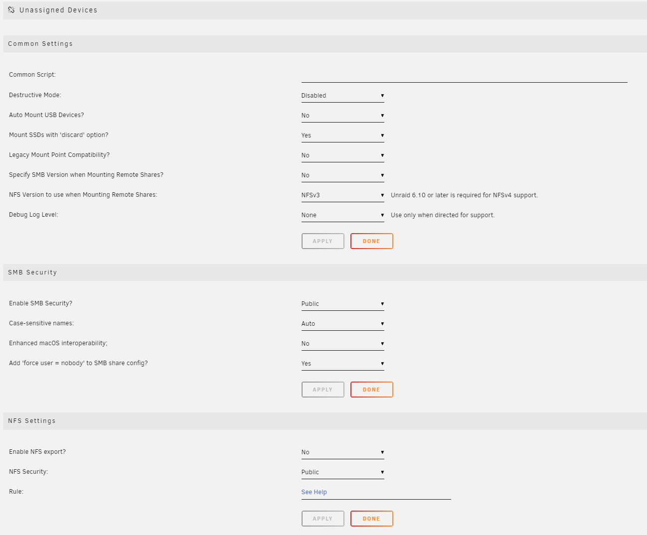

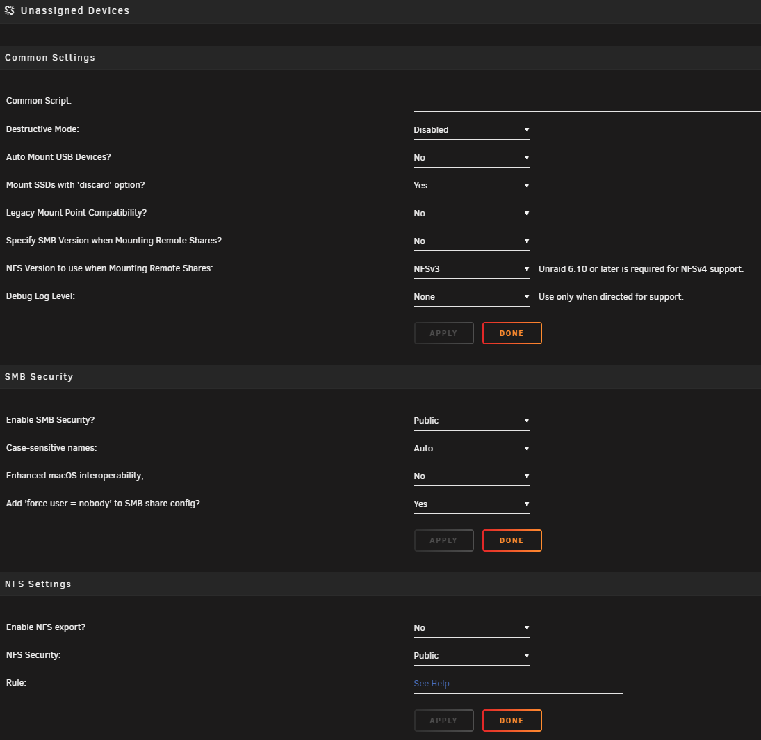

I am trying to share locations between two Unraid servers.  From a windows machine I can see and access all folders located on both servers but when when trying to mount the folders, I keep getting similar errors as above
Jun 25 13:40:35 Reveille kernel: CIFS: VFS: Error connecting to socket. Aborting operation.
Jun 25 13:40:35 Reveille kernel: CIFS: VFS: cifs_mount failed w/return code = -4
Jun 25 13:40:35 Reveille unassigned.devices: Error: shell_exec(/sbin/mount -t 'cifs' -o rw,noserverino,nounix,iocharset=utf8,file_mode=0777,dir_mode=0777,uid=99,gid=100,vers=1.0,credentials='/tmp/unassigned.devices/credentials_Reveille Unraid Backups' '//RANGER/Reveille Unraid Backups' '/mnt/remotes/RANGER_Reveille Unraid Backups' 2>&1) took longer than 10s!
Jun 25 13:40:35 Reveille unassigned.devices: SMB 1.0 mount failed: 'command timed out'.
I have messed with the SMB settings like making sure it was set to 'Public" in the UD gui but still nothing.  When I go to add the share, I can see the server, but when click on "load shares" nothing is found.  No passwords should be set as it currently sits for the shares.
I have attached diagnostics from both servers for reference.  I appreciate any guidance you can provide.  I have been using Unraid for a few years but I don't know all the intricacies about it so if you need additional information or have suggestions please elaborate the best you can to help me out.
reveille-diagnostics-20220625-1442.zip ranger-diagnostics-20220625-1443.zip

Everything seems to be the same on both machines.  I did mess with "enable SMB Security" setting and tried all the different options and currently sits at Public.  I can't remember if that is the default value or not.
