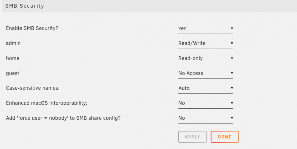

5 hours ago, Arubial said:
Since upgrading to 6.10.3, I am unable to see my SMB shares with UD.
You have SMB enabled, which is necessary.  The other pieces are the UD Settings for SMB:
Make sure you don't have 'SMB Security?' set to hidden.  If you do, you can't browse.

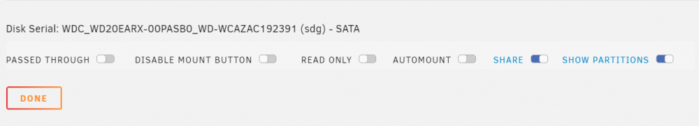

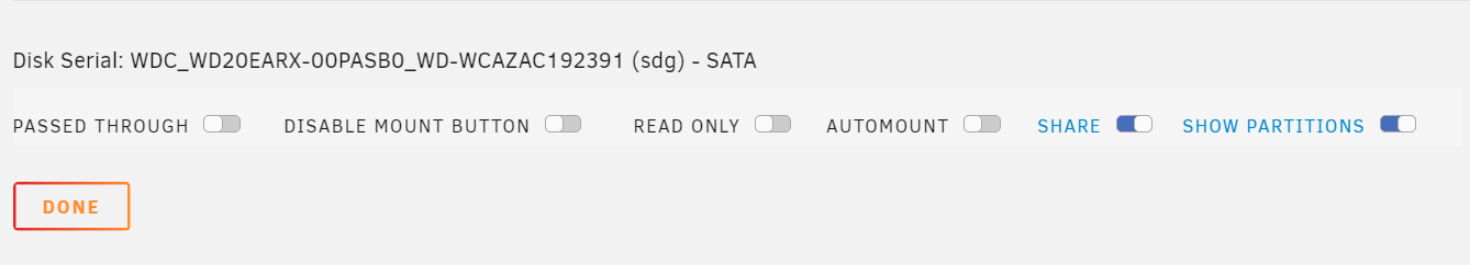

The last thing is to enable 'Share' for the device:
Because of the way Unraid handles shares, it can take up tp several minutes for the share to actually show up in the Network Neighborhood.
I checked my settings, and they haven't changed. SMB is enabled, and I have it set to public like I always have. I don't really need security on this particular share. I also made sure the share option is enabled in the UD settings. What's going on?

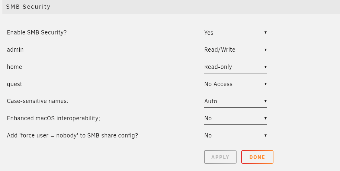

What do you mean Public?  You mean setting 'SMB Security?' to 'No'?
Prior  I do not rememeber having to set the SMB Security to "Yes" and then specifing read/write for the users,  but it has been a while ago that I setup the SMB sharing so it could have just got reset with the update to unraid OS 6.10.3.  Thanks for quick responses
It was a recent change in UD, not in Unraid.  The issue is a recent change I made that disabled SMB when the security setting was 'No'.  Previously, the 'No' setting was SMB Public sharing.  This was not appropriate to set Public sharing with security set to 'No'.  What I will do is add a 'Public' setting.  So you can set the security to 'No', 'Public', 'Yes', and 'Yes (hidden)'.
This change will be in the next UD release.

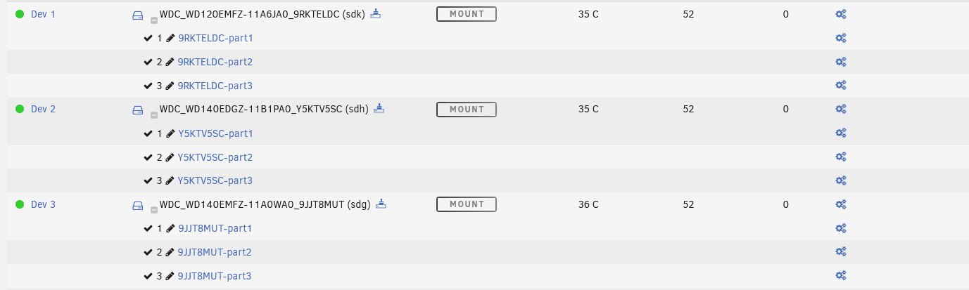

I need help. I updated Unraid to 6.10.3 from 6.9.2. I have 7 disks in UD and I set it to auto-mount. Right after the update, only one disk was mounted, I tried to click the MOUNT button, it just spins and goes back to MOUNT. I tried to reboot and disable auto-mount, and still the same. Any idea how to resolve my issues. Thank you.

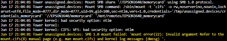

I updated my Unraid OS to 6.10.3 from 6.9.2 but I am unable to mount a smb share. It was mounting the share just fine on 6.9.2 but not on the new OS 6.10.3. I double checked the settings and everything is the same. Is there anything I can check on my end to help solve this issue? Thank you.
tower-diagnostics-20220617-2107.zip
Post your diagnostics zip file.
The remote mount is failing when trying to use SMB 2.0:
Jun 17 21:04:01 Tower unassigned.devices: Mount SMB command: /sbin/mount -t 'cifs' -o rw,noserverino,nounix,iocharset=utf8,file_mode=0777,dir_mode=0777,uid=99,gid=100,vers=2.0,credentials='/tmp/unassigned.devices/credentials_memorycard' '//EPSON3640/memorycard' '/mnt/remotes/EPSON3640_memorycard'
Jun 17 21:04:01 Tower kernel: CIFS: Attempting to mount \\EPSON3640\memorycard
Jun 17 21:04:01 Tower kernel: CIFS: Status code returned 0xc000000d STATUS_INVALID_PARAMETER
When this fails, UD will attempt to use SMB v1.0 to mount the remote share, which is what you have shown in the log snippet.  I'm not sure what the STATUS_INVALID_PARAMETER is referring to, but it may be your credentials on the remote server.  I would change the credentials on the remote server and then re-do the UD remote share to match.  Try to not use any special characters.

1 hour ago, gleech said:
UD is detecting duplicate mount point/share names:
Jun 17 18:50:02 Tower unassigned.devices: Error: Device '/dev/sdg1' mount point 'nftc' - name is reserved, used in the array or by an unassigned device.
Jun 17 18:50:02 Tower unassigned.devices: Disk with serial 'WDC_WD120EMFZ-11A6JA0_Z2K5V93T', mountpoint 'nftc' cannot be mounted.
Jun 17 18:50:02 Tower unassigned.devices: Error: Device '/dev/sdh1' mount point 'nftf' - name is reserved, used in the array or by an unassigned device.
Jun 17 18:50:02 Tower unassigned.devices: Disk with serial 'WDC_WD140EDFZ-11A0VA0_9KHGR42M', mountpoint 'nftf' cannot be mounted.
Jun 17 18:50:02 Tower unassigned.devices: Error: Device '/dev/sdi1' mount point 'nfte' - name is reserved, used in the array or by an unassigned device.
Jun 17 18:50:02 Tower unassigned.devices: Disk with serial 'WDC_WD140EDFZ-11A0VA0_9LGG46BG', mountpoint 'nfte' cannot be mounted.
Jun 17 18:50:02 Tower unassigned.devices: Error: Device '/dev/sdj1' mount point 'nftd' - name is reserved, used in the array or by an unassigned device.
Jun 17 18:50:02 Tower unassigned.devices: Disk with serial 'WDC_WD120EMFZ-11A6JA0_QGGL6E3T', mountpoint 'nftd' cannot be mounted.
Jun 17 18:50:02 Tower unassigned.devices: Error: Device '/dev/sdk1' mount point 'nftg' - name is reserved, used in the array or by an unassigned device.
Jun 17 18:50:02 Tower unassigned.devices: Disk with serial 'WDC_WD80EZAZ-11TDBA0_1SGV50EZ', mountpoint 'nftg' cannot be mounted.
This looks suspicious to me because the names are all 'nftX'.  I think UD might think any name with 'nft' is considered a duplicate.  Post the output of:
