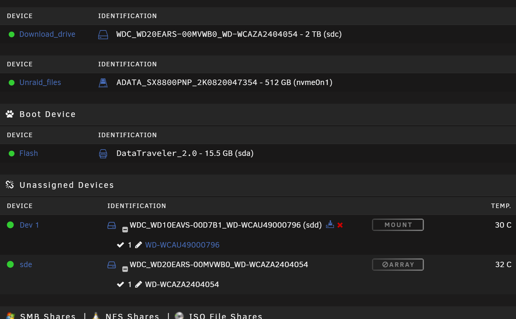

how is it possible  1 drive can be in a cache pool  and in unassigned drives at the same time?    shouldnt it be hiding from it as my other cache pools dont show up
It looks as if it temporarily dropped offline and then came back online.  The device Id changed and Unraid does not handle this.
I replied on your other thread
ah ok  ya thanks...    i  when i re booted it fixed itself  i not 100%  sure if its back plain or power supply .. told my sister when i see her to just give me the computer  since shes a few hours away   i cant just fix it easily... may just find a computer case and skip the hot swap.. and go straight to just mount the hard drives in the case..  no need for 4 bay hot swap
