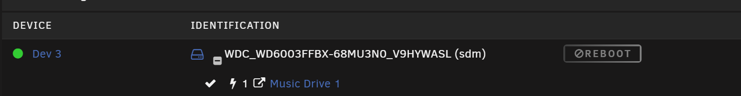

7 minutes ago, comet424 said:
what does the reboot mean?  before  it was cant mount.. now its reboot.. it seems to be this 1 hard drive i always have issues with
whats going on  i unmount and hit the spin down the drive before i remove it..  does it say anything
is something wrong with the hard drive  or is the using the star tech enclosures?
What the "Reboot" indicator on the Mount button means is that the device was removed before being unmounted.  A reboot is the only way to fix it.  This can happen when a disk is physically unplugged, or the connection drops.  Your log is full of disk errors indicating that the device dropped offline or was disconnected.
This is an example:
Jun  4 12:22:19 Tardis ntfs-3g[15010]: ntfs_attr_pread_i: ntfs_pread failed: Input/output error
Jun  4 12:22:19 Tardis ntfs-3g[15010]: Failed to read vcn 0x0 from inode 5: Input/output error
Jun  4 12:22:19 Tardis kernel: Buffer I/O error on dev sdn1, logical block 183141285, async page read
You may have cable or enclosure issues.
