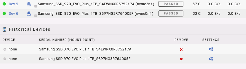

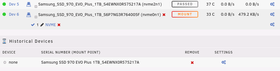

@dlandon with the latest update I got two missing devices but they are both connected:
If I remove the Devices from the Historical Devices the config from the devices is also removed like:
(This screenshot shows with one device removed from the Historical Devices)

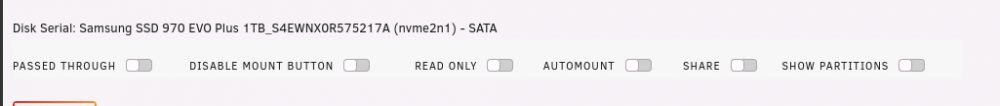

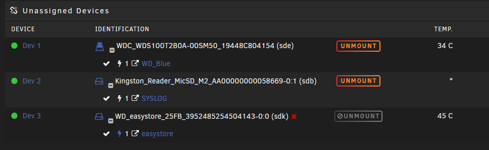

What's also strange is that if I'm only clicking the slider to show the partitions (slider enabled), which BTW are showing anyways, I get this screen:
but the slider in the settings from the disk look like this (seems like this isn't saved):

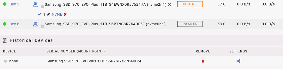

Look carefully at the serial no (id).  The Historical devices have spaces, the new ud devices have underscore.  This is because ud has changed to using the devs.ini id.  They are the same devices, ud just thinks they are different devices.  Apply your settings to the new found devices and then remove the historical devices.

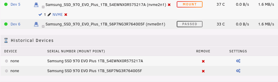

I have done this already twice, here is a screenshot after the removal:
Here is a screenshot after applying the new setting (only Passed through was enabled and show Partitions disabled):

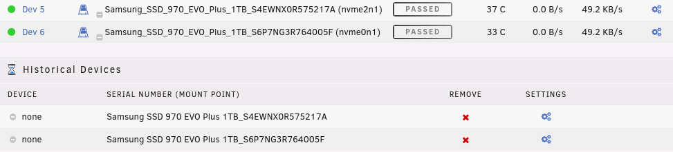

And here after I've assigned it to the second device:

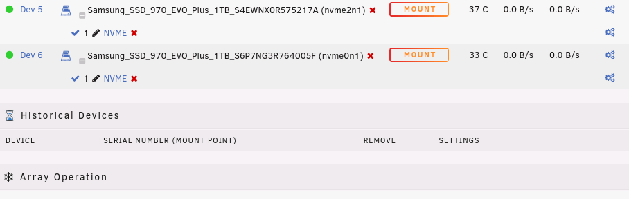

If I remove the devices from the Historical Devices and re add it it's the same over and over again.
Should I send you my ini file, haven't looked at it yet...
PM this file to me.  Don't post it here as it has some private informatiuon.
/flash/config/plugins/unassigned.devices/unassigned.devices.cfg
I suspect it may have an issue as I can't reproduce your problem.
Update UD.  I think I may have found it.
Thank you, can confirm everything is working after deleting the drives from Historical Devices and applying the settings again! :)

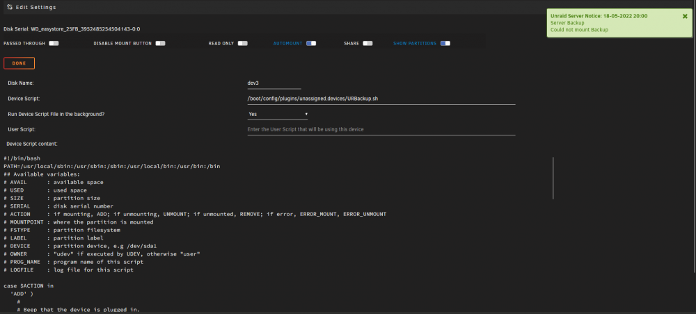

Since upgrading to unRAID 6.10.0 and the latest version of the UD plugin, my external backup drive (14TB Easystore NTFS) will not mount and run the backup script.  I deleted it from historical devices, plugged it in and configured it again.  No change.
Worked great in unRAID 6.9.2 and prior to updating UD.
If I plug it in to a WIndows PC, everything appears as it should.
medianas-diagnostics-20220518-2003.zip

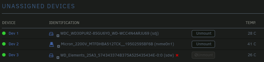

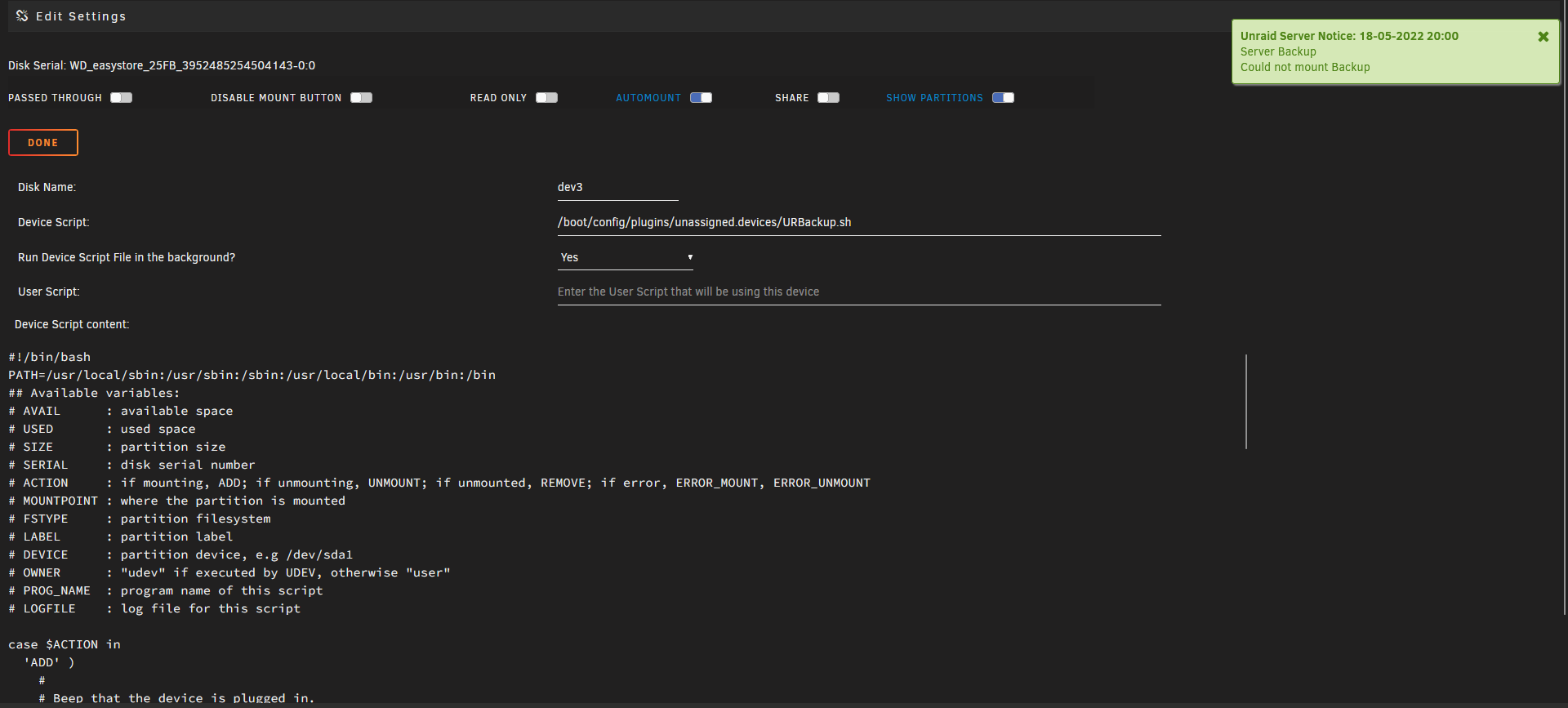

Same issue as @Hoopster - I'm running 6.10-rc4. Updated to Unassigned Devices 2022.05.18 today and I can't access my USB connected Elements that I normally have mounted for backups via the DirSyncPro docker.
It looks like you didn't unmount the disk before you physically removed it.  If the mount button shows a not 'Unmount', you'll need to reboot to clear it up.  Don't just pull the disk out and expect it to work when you plug it back in.
Yes, I should have caught that.  The configuration of the disk was incorrect in UD after the upgrade.  After mounting it manually, I did in fact unplug it without unmounting and removing from historical devices.  A reboot of the server cleared everything up and it is working properly now.
I was so used to just unplugging it after the backup and automatic unmount that I forgot to manually unmount.
Thanks for pointing out the obvious as I missed that.  😀
Edited by Hoopster
