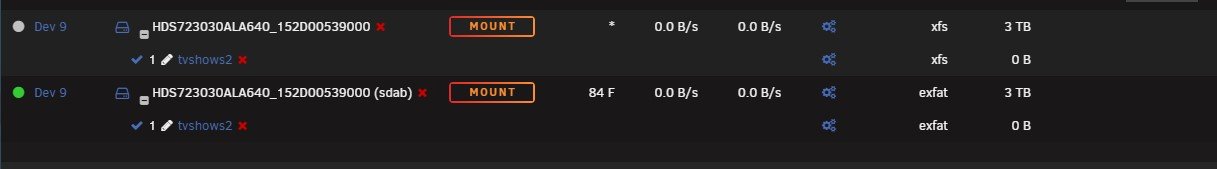

When I added a second drive to a 4 bay USB enclosure, something happened and neither drive will mount.  Previously when only 1 drive was in the enclosure, the 1 drive mounted fine.  I have 7 Unassigned Drives connected via the HBA.  The 8th drive was the one in the 4 bay USB 3.0 enclosure.  It was formatted and working fine.  I turned off the enclosure and added a 9th drive.  Now, both drives are listed as Dev 9 and the one that should be Dev 8 has no device label (should be sdaa) and both show the same mount point "tvshows2" which was the mount point for Dev 8 as the new Dev 9 is not formatted and has not been mounted.  This is the entries from the system log.  It looks like the UUID was duplicated and I tried changing the UUID on the settings page but now it's telling me there is a pending log to replay.  xfs_repair has been running for about 2 hours on a 3TB disk, not sure how long I need to let it run.  Can anyone tell me how to fix this?
logs.txt
Unraid relies on each drive being presented with a unique ID (typically the serial number although this is not mandated).  It looks as though this dock does not do that which is why you are experiencing the symptoms you see.  If so not much you can do except considering using another dock that DOES present each drive to Unraid with a unique ID or just assume you cannot dynamically plug drives into a slot with this dock.
