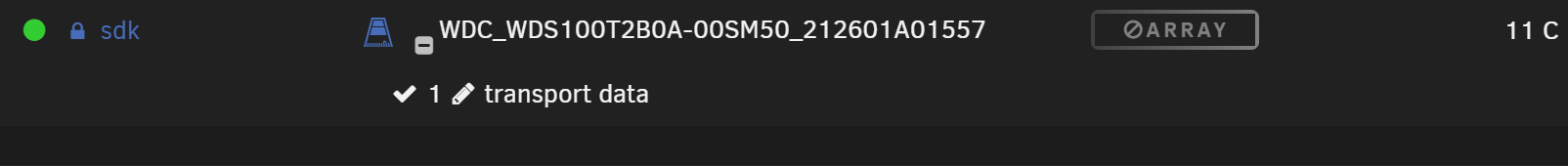

hi i like to know..  what it means the no array icon for my unassigned device.. i usually mount and unmount the drive to be removable. so i can transfer my sisters files..  now  i wanted to unmount from my server.. and it shows that array icon what does it mean?
server been up 2 weeks... but the hard drive only been plugged in a week
the last several warnings showing
 and i currently running
2022.04.20  UD
That happens when the disk is removed (disconnected) before it is unmounted.  You'll need to reboot.
oh ok..  ill do that then... so always make sure its fully unmounted   i thought i always unmount...  but i appreciate that..
