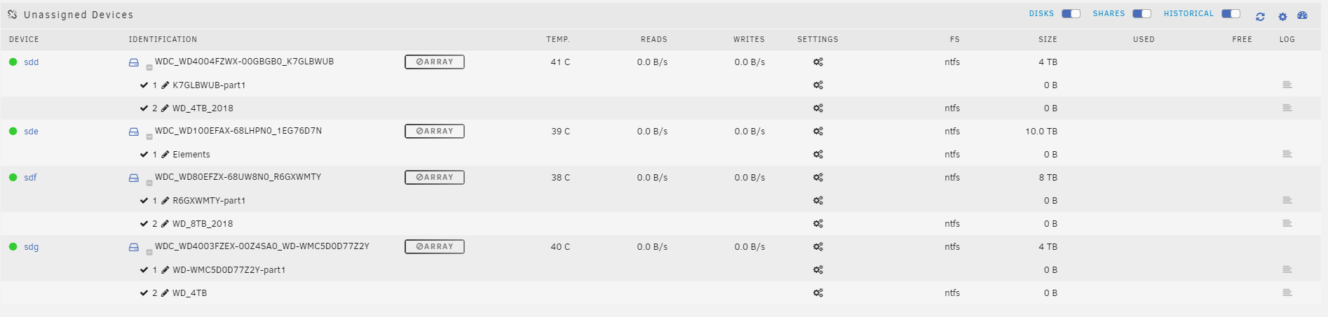

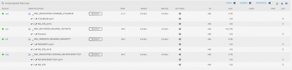

@dlandon: After the release 20220411 the button bar (shown below) is missing:
Before 20220411:
After 20220411:
Edit: 20220411b fixed it. Thanks.

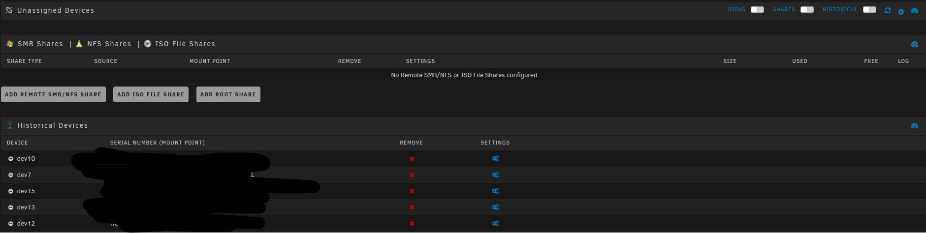

Hist2065619445_Screenshot2022-04-11110550.thumb.JPG.c8c960fc645b508c4997b83c741c31e7.JPGorical disks keep appearing on the main tab. Turning on/off the historical devices does nothing.
Edited by Fuggin
Latest update fixed it...but the historical disks don't show now when switching it on...I don't know if the update just cleared the history altogether.
NVM....need to enable disks AND Historical to see them....fine by me.

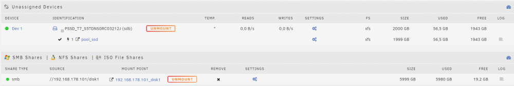

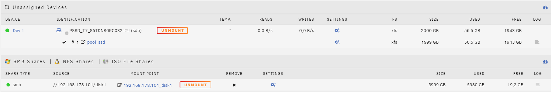

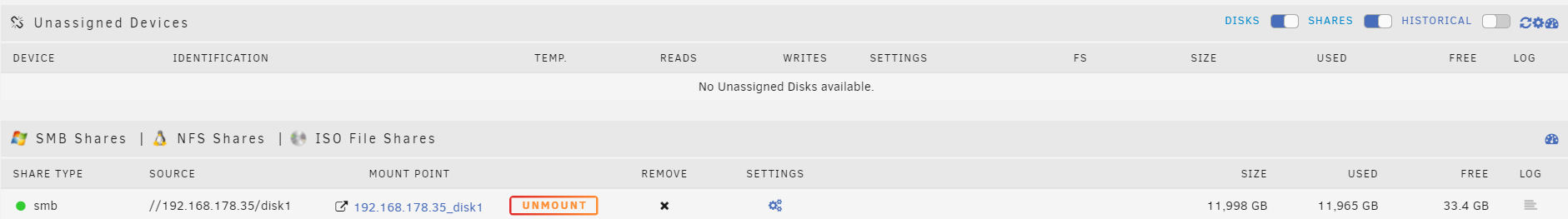

I have been out of the Unraid game for a little while, had everything up and running for the last year or so and now it's coming time to me to decide what to do with these four unassigned drives I have in my server. However I cannot for the life of me figure out how to mount them and access them via Windows?
When I look at tutorials on YouTube / Google / Reddit / etc it shows that there should be an Auto-Mount and Share toggle switch on the right hand side, but it's not there? I can't see anything in the Settings when I click on the little gear icon.If I click on the three letter Device codes on the left hand side, I can't see anything there.
I'm sure this is a very simple fix, so please can someone point me in the right direction?
You won't be able to do anything until you clear the 'Array' status.  Reboot and it should clear up.

I have updated Unraid and rebooted and the 'Array' status has cleared, it is now allowing me to mount the drives!
They were neither removed or part of the array at any time, they have been sat as unassigned drives since I set up the server, so I'm not sure why that status was showing up.
EDIT: Ignore me, I've got it working! Thank you
