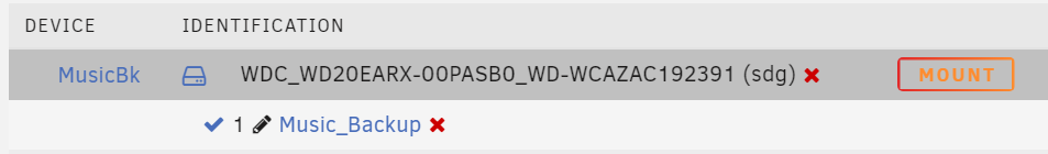

2 hours ago, CaptainSpalding said:
From where can I do that? I found only a place where to change the device name.
Click on the blue text opposite the '1' in your screenshot (the 2nd line)

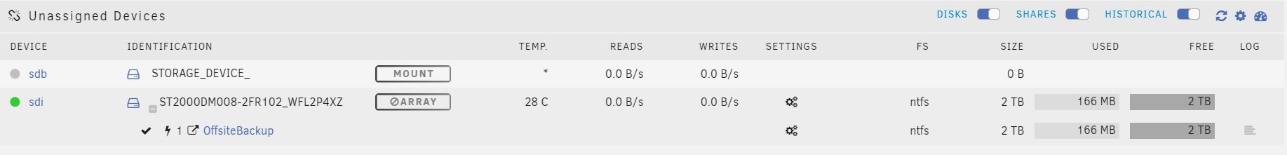

I'm building a new NAS and I have a reeeeeeally funky issue.
Unraid 6.9.2
The Array consists out of 3x 4TB Seagate Ironwolf's and a 120GB Plextor SSD Cache. But that has nothing to do with the funky stuff.
I have 2x 2TB Seagate Compute drives, these are used for off-site backups.
The usecase is this:
  1. Monday morning 2TB Seagate Compute "A" is plugged in, auto mounted and SMB shared by UD
  2. later that day a backup is executed on a different system which stores the backup on that disk/share
  3. Monday night 2TB Seagate Compute "A" is disconnected and stored off site
  4. Next week on Monday morning 2TB Seagate Compute "B" is plugged in, auto mounted and SMB shared shared by UD
  5. later that day a backup is executed on a different system which stores the backup on that disk/share
  6. Monday night 2TB Seagate Compute "B" is disconnected and stored off site
  7. etc.....
Now here is the funky part:
  1. I connected 2TB Seagate Compute "A", configured auto mount and auto share in UD
  2. disconnected 2TB Seagate Compute "A"
  3. I connected 2TB Seagate Compute "B", configured auto mount and auto share in UD
  4. disconnected 2TB Seagate Compute "B"
Whenever I now connect either 2TB Seagate Compute "A" or "B" I get this greyed out "ARRAY" button in UD and the disk is not shared 😬🙃🤪
I connected the drives to a different machine and deleted the partition. Yet they still show up with that greyed out "ARRAY" button in UD.
Below is the log taken when I connected one of the drives while it had no partition anymore. It complains about a mismatch in line 4 as if it does not like that different disks get connected to that sata port.

but even when I connect one of the drives to a different SATA port now it still shows up with that greyed out "array" button and shows that "mismatch" error in the log.

EDIT!
Now it gets even funky'er!!! 🤣
If I do the exact same thing with these 2 disks:
  • HGST_HDS724040ALE640
  • dev3HGST_HDS724040ALE640
Then it works just fine!
Only with the 2 ST2000DM008-2FR102 it does not work and I run into this greyed out "ARRAY" button. :)
This happens when the disk is removed without being unmounted first.  When it is re-installed, Linux assigns a new sdX designation.  Unraid does not see the new disk as an Unassigned DIsk and UD thinks it's a disk that fell out of the array.
You'll need to reboot to clear it up.
Thank you! I will reboot and see what happens.
Is there a way to have a cron job unmount the disk?
I'd like to have this offsite-backup as "end-user" proof as possible. Which means I do not want to unmount it manually every Monday evening before it gets unplugged. 😅
Your script can do an unmount when it is done, or you can unmount the disk with a User Script on a cron.  Go to the UD page and click on the help icon and read about using the UD script to mount and unmount the disk.  The problem with the cron is that you'd also need to confirm it got unmounted or you'll be back in the same pickle.
My suggestion is to set up a User Script to do the copying and unmount the disk at the end of the script.  As I read your post, it is a manual process.
Then I only get this. 🤔
Not sure what is going on for you?   I get a pop-up allowing me to change the mount point (and thus share name)
thx!
Ideally I would have Veeam Backup & Replication SSH into unraid, ensure that the disk is mounted before the backup and unmount it when its done.
But I need to see if I can execute that pre/post backup job. (ESXi is on a different machine - Unraid is 'only' used to store onsite backups and as 'provider' for the offsite backup media)
As a quick solution I have now created a userscript to unmount the disk - scheduled to run ~2hours after the backup task is always finished. This worked nicely in my test! :)
I assume there is no way how I could have a cron job run sometime at night to let Unraid/Linux forget that a disk was safely removed - in case that this would happen at some point - so that a reboot isnt required.
The disk is mounted.  You are browsing it.  Unmount the disk then change the mount point.
You can't get Linux to unforget the disk.  If it's properly unmounted, there is no problem.  Don't remove it until it is unmounted.  If it's not unmounted before removal, you risk data loss/corruption.
I do not get a pop-up. I tried with Firefox and Chrome.
This page is where I land if I press that partion link on the main page:
11 minutes ago, wgstarks said:
Now worked, thanks!
Thx!
I found a way to have Veeam Backup & Replication remotely mount the disk via ssh before the backup starts
then then unmount it once the backup is done. :)
I noticed that it can sometimes take 60 seconds or more for the SMB share to get accessible after the disk has been mounted.
Is that.... normal? 😅
Yes.  UD sets up the shares and Unraid enables them on a polling schedule that I believe is one minute.
I believe so.

On 4/1/2022 at 8:52 AM, cholzer said:
Is it possible to ssh into unraid and then remotely call UD to unmount or mount a disk?
I did take a look at the scripts in the first post but these dont seem to hold the answer. 😅
Reason for my question is that as it truns out I run into several issues with the SMB share creation/destruction when I remotely SSH into unraid and then just mount/unmount the disk.
These problems do not exists when I use the "mount" button in the UD gui, so I guess the solution would be to call UD remotelly via SSH and let it do the mount/umount. But how?
Thanks in advance!
I think I figured it out. :)
Goal:
Short Version:
Use ssh to have UnassignedDevices mount/umount a specific disk and create an SMB/CIFS share for that disk.
Long Version - my usecase:
  1. (pre-backup script) a Server on my network connects to UNRAID via SSH and instructs UD to mount a specific disk which also creates the share
  2. this server then runs a backup job which has this UD share as target
  3. (post-backup script) once the backup is done the server connects to UNRAID via SSH and instructs UD to unmount this specific disk which also removes the share
Step-by-step guide:
I assume that your disk already has a single partition
  1. Connect the disk to your Unraid system
  2. go to the settings of the disk, enable the 'share' setting
  3. mount the disk, make sure that the share is created and can be accessed
  4. note the disk id (sd* i.e. sdg) next to the drive serial in the UD GUI
  5. ssh into the UNRAID server or open the terminal in the webgui
  6. run "ls -ahlp /dev/disk/by-uuid" to list all drives by their UUID (look for the sd* to find your disk's UUID)
  7. now you can use these 2 commands to mount/unmount this specific disk via SSH or a script on your UNRAID machine.
/usr/local/sbin/rc.unassigned mount '/dev/disk/by-uuid/THEUUIDOFYOURDISK'
/usr/local/sbin/rc.unassigned umount '/dev/disk/by-uuid/THEUUIDOFYOURDISK'
Hope this might help someone who finds himself in the same situation as I was in. :)
Edited by cholzer
There is an easier way of doing this.  Give the disk an alias name and use that name to mount/unmount the disk:
/usr/local/sbin/rc.unassigned mount name=MusicBk
/usr/local/sbin/rc.unassigned umount name=MusicBk
