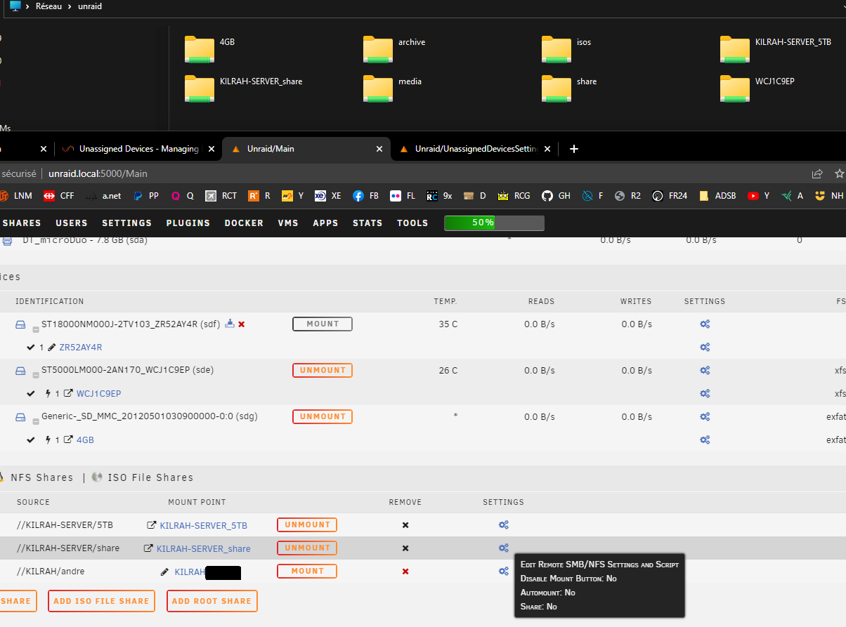

I have another issue that I've seen mentioned a few times, the smb shares just work... weird.
One drive (WCJ1C9EP) I can't write to over smb, regardless of whether smb security is Public or Yes with RW permissions to the user I use for the other shares (it's xfs encrypted with pool key, Unraid can write to it just fine). Often the client UD shares will show up shared even if share is set to No on them, and ironically I can write to those...
Edited by Kilrah

3 hours ago, dlandon said:
Whenever you change the UD SMB Share settings or change the Share switch setting on a device or remote share, there is a delay in the samba settings taking effect.  Unraid has up to a one minute delay in setting the SMB shares after UD makes changes.
Yes I've seen that, still if I change the samba security settings for example the remote shares become shared even if they're set to no, and I still can't write to that share hours later and after multiple tries...
