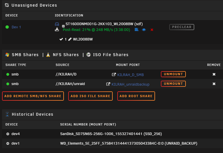

I've had it previously when connecting 2 SD card readers that happened to identify using the same string (first would work, would get that error when connecting the 2nd), but this is my drive that I connect every couple of days for automated backups. I have a SATA drive as UD that's currently preclearing but its string looks nothing like it. The string is being read by usb_manager just fine, but seems UD can't grab it. I've tried reloading UD config.

4 minutes ago, Kilrah said:
emhttpd: device /dev/sdh problem getting id
This is an Unraid message.  What shows in the UD web page?
5 minutes ago, Kilrah said:
I've had it previously when connecting 2 SD card readers that happened to identify using the same string, but this is my drive that I connect every couple of days for automated backups. The string is being read by usb_manager just fine, but seems UD can't grab it. I've tried reloading UD config.
Post diagnostics file.
Diags attached.
UD shows nothing related (well it has the drive in historical devices)
This drive is encrypted with the pool key. I've tried another USB port, as well as passing it through to a VM and can mount it fine there.
Edited by Kilrah
Hmm /dev/disk/by-id shows the ID for the partition but not the disk for some reason...

EDIT: Same for another, blank HDD and a card reader. A flash drive comes up fine though.
Going to assume it's udev doing something weird...
Edited by Kilrah
Yep, that's what I see.
Remove the UD plugin and stop the array.  See if Unraid will recognize the disk and show it in the Unassigned Devices tab.
This usually happens if a device has a duplicate identifier, since I'm not seeing another device with the same name it could be from a previous incomplete removal, how did you detach the device? I'm seeing this and it's not normal:
Sep 25 12:51:19 Unraid usb_manager: Info: rc.usb_manager usb_remove  Western_Digital_Elements_SE_25FF_57584131444137305043384C /dev/bus/usb/002/003 002 003
Sep 25 12:51:19 Unraid usb_manager: Info: rc.usb_manager Device Match 002/003 vm:   002 003
Sep 25 12:51:19 Unraid usb_manager: Info: rc.usb_manager Removed 002/003 vm:  nostate 002 003
If the removal was the problem rebooting would fix it.
I plug the device in, UD automounts, runs device script, then unmounts and I disconnect. Seems last time was on Oct 4th.
By removing it or using the "Detach" button?
Just disconnecting USB after the disk is unmounted.
