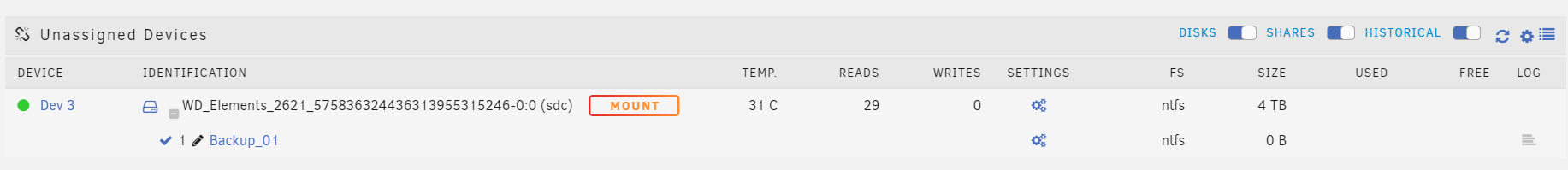

On 11/16/2022 at 3:38 PM, shakeshuck said:
Is there also no error message if you try to mount it from the console? Just a thought.
I apologize for the late reply.
If I mount the whole thing manually via the command "mount -t ntfs-3g", then I also get no error message. Simply nothing happens.
I have installed the ntfs-3g driver "ntfs-3g-2022.10.3-i586-1.txz".
As a test, I would try mounting with the Parted Magic and then report back.
root@AMHOST:~# mount -t ntfs-3g -o umask=111,dmask=000 /dev/sdc1 /mnt/user/usb
root@AMHOST:~# ls /mnt/user/usb
root@AMHOST:~#
root@AMHOST:~#
The ntfs-3g driver is built into Unraid.  You don;t need to install it.  According to your original post, the first partition doesn't have a file system.
Post a screen shot of UD showing the disk you are trying to mount.
Do you mean something like this?
I don't understand why this happened.
On both hard drives I pulled a backup and that worked without any problems. Now both hard disks can no longer be mounted. Can I still solve the problem or do I have to format the disks?
Click on the check mark.  That will do a file system check.  See what it comes up with.

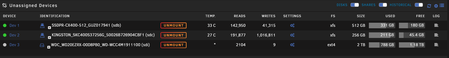

1 hour ago, dlandon said:
Go to UD settings and set "Debug log level:" to "Udev and Hotplug",  Go to the UD page and let it sit for about 10 seconds.  Then post the diagnostics file again.  Turn off the logging as it is pretty chatty.
Also post a screen shot of your UD page.

16 hours ago, dlandon said:
Post the output of this command:
/sbin/udevadm info --query=property --path $(/sbin/udevadm info -q path -n /dev/sdi)
DEVLINKS=/dev/disk/by-id/ata-WDC_WD20EZRX-00D8PB0_WD-WCC4M1911100 /dev/disk/by-id/wwn-0x50014ee209cc2fc4 /dev/disk/by-path/pci-0000:08:00.0-sas-phy3-lun-0
DEVNAME=/dev/sdi
DEVPATH=/devices/pci0000:00/0000:00:11.0/0000:08:00.0/host8/port-8:3/end_device-8:3/target8:0:3/8:0:3:0/block/sdi
DEVTYPE=disk
DISKSEQ=27
ID_ATA=1
ID_ATA_DOWNLOAD_MICROCODE=1
ID_ATA_FEATURE_SET_HPA=1
ID_ATA_FEATURE_SET_HPA_ENABLED=1
ID_ATA_FEATURE_SET_PM=1
ID_ATA_FEATURE_SET_PM_ENABLED=1
ID_ATA_FEATURE_SET_PUIS=1
ID_ATA_FEATURE_SET_PUIS_ENABLED=0
ID_ATA_FEATURE_SET_SECURITY=1
ID_ATA_FEATURE_SET_SECURITY_ENABLED=0
ID_ATA_FEATURE_SET_SECURITY_ENHANCED_ERASE_UNIT_MIN=286
ID_ATA_FEATURE_SET_SECURITY_ERASE_UNIT_MIN=286
ID_ATA_FEATURE_SET_SMART=1
ID_ATA_FEATURE_SET_SMART_ENABLED=1
ID_ATA_ROTATION_RATE_RPM=5400
ID_ATA_SATA=1
ID_ATA_SATA_SIGNAL_RATE_GEN1=1
ID_ATA_SATA_SIGNAL_RATE_GEN2=1
ID_ATA_WRITE_CACHE=1
ID_ATA_WRITE_CACHE_ENABLED=1
ID_BUS=ata
ID_FS_TYPE=ddf_raid_member
ID_FS_USAGE=raid
ID_FS_UUID=Dell_(
ID_FS_UUID_ENC=Dell\x20\x20\x20\x20\x10\x28
ID_FS_VERSION=01.00.00
ID_MODEL=WDC_WD20EZRX-00D8PB0
ID_MODEL_ENC=WDC\x20WD20EZRX-00D8PB0\x20\x20\x20\x20\x20\x20\x20\x20\x20\x20\x20\x20\x20\x20\x20\x20\x20\x20\x20\x20
ID_PATH=pci-0000:08:00.0-sas-phy3-lun-0
ID_PATH_TAG=pci-0000_08_00_0-sas-phy3-lun-0
ID_REVISION=80.00A80
ID_SERIAL=WDC_WD20EZRX-00D8PB0_WD-WCC4M1911100
ID_SERIAL_SHORT=WD-WCC4M1911100
ID_TYPE=disk
ID_WWN=0x50014ee209cc2fc4
ID_WWN_WITH_EXTENSION=0x50014ee209cc2fc4
MAJOR=8
MINOR=128
SUBSYSTEM=block
USEC_INITIALIZED=46837230
This line is the problem:
ID_FS_UUID=Dell_(
That's an inappropriate UUID.  Why are you using an ext file system?  Can you nove the data off that disk and reformat it to xfs?
If that's not possible, maybe @JorgeB can offer a manual way to change it.  UD isn't built to do any more with ext file systems but mount them.
FS: ntfs
Executing file system check: /bin/ntfsfix -n /dev/sdc1 2>&1
sh: line 1: /bin/ntfsfix: No such file or directory
File system corruption detected!
Looks not good :(
