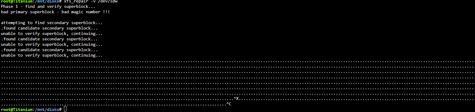

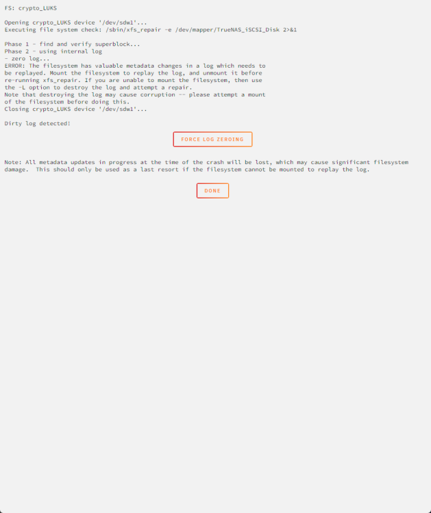

I hope this is the right place to post this.  It looks like I have a corrupted XFS system that I need to repair.  I have been running this setup without any issues for over a year. The catch is that the file system is located on an iSCSI attached file share accross 10Gig optic, that is mounted using unassigned devices.  Here is a high level diagram of the setup.

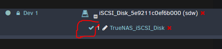

Unassigned device as it shows up in main menu (hope you can see it)
I cant mount the drive under unassigned devices. This is the error I get when I mount the array with unassigned devices for the iSCSI drive.  Then it reverts back to unmounted
The drive shows up as dev\sdw so I THINK? the iSCSI interface is working correctly, but this could be cashed from when it was working. I am not too experienced with iSCSI.
I didn't see a way from the GUI to do an xfs_repair, so I tried from the command line.  This is what I get,  the result is that xfs_repair tries to verify superblock and I get  "............" continuously until I ctl^c to break out.

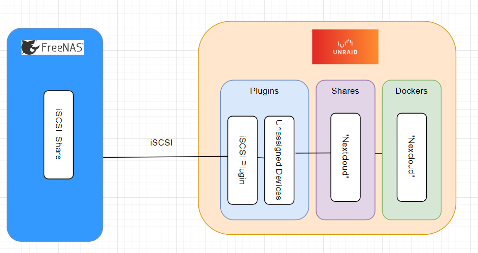

Before you ask why I am doing this.
1. I like the docker for nextcloud and the docker system in general in unraid better then freeNAS jails and plugins.
2. the idea was to use the docker in unraid then take advantage of the ZFS files system in freeNAS for better error protection and speed.  Not sure how the speed aspect turned out since freeNAS array is ZFS but when it was connected to unraid the share was formatted XFS, I think that's how it works. To be honest it was hacked this together using several different tutorials and trial and error.. Anyway I didn't do any speed tests but it didn't feel like it was an improvement in speed over unraid.  Yes I am using a 10gb interface between freenas<->Unraid<->Client computer.  I am not sure if it is even using ZFS since it is mounted using XFS.
3. Once I get access to the data, I plan to just run nextcloud on freeNAS since this seems to be more headache then its worth.

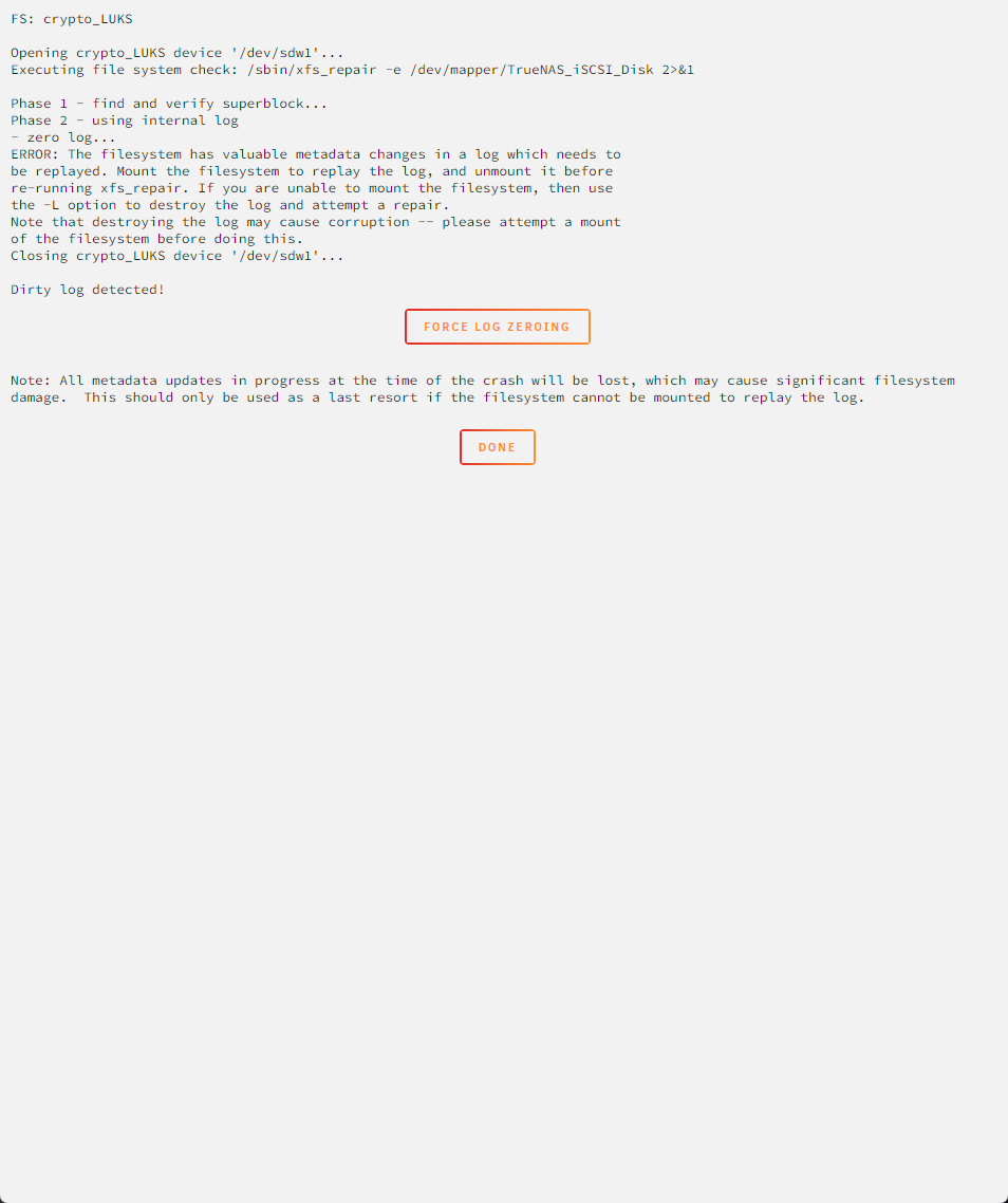

You can repair the fs using UD, click here:
OK I ran the disk check using the checkmark.  Got this result.
I tried to mount the files system and got this error
Is there any other way to run the log file, or do I have to wipe it and move on?  If I do how much damge would this do, would it end up deleting files?
OK I went ahead and deleted the log file.  This worked, I am assuming that the impact deleting the metadata file had was the files that it was confused about placed in a directory called "lost and found", but preliminary scan shows that all the files are there.  Thanks for the quick and helpful response.
