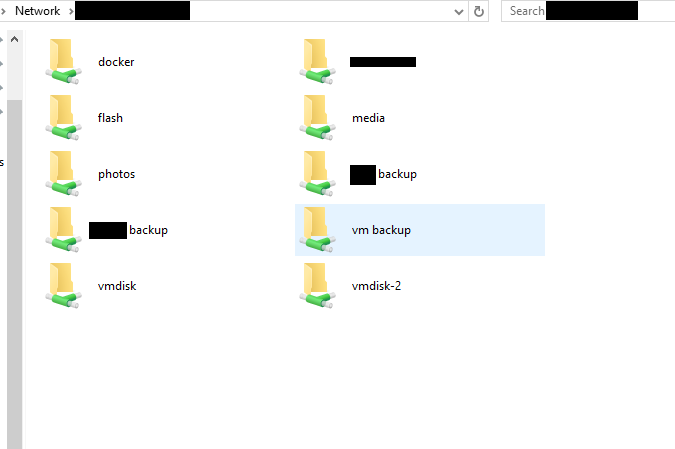

FWIW, I mount my 2 disks to /mnt/vmdisk and /mnt/vmdisk-2. I prefer not to have to go into the mnt/disks/ folder to access my shares. If you do decide to change the renaming feature, it would be nice to not be limited to only using the /mnt/disk folder. just my 2 cents  ;D
or can you let us know how to get around the disks limitation or like mentioned limit us to only /mnt/
I've had an instance when I mounted mine to /mnt/user/ because of what I was doing at that time, but typically I do mount to /mnt/disks/
Options are always nice, but I do think /mnt/ unless your worried somebody is going to mess up disk shares some how with the incorrect mounting.
... but I do think /mnt/ unless your worried somebody is going to mess up disk shares some how with the incorrect mounting.

1. Because I am difficult
2. Because it is less mouse clicks and looks nice when browsing to my unRAID network shares (see photo).

I actually don't map any network drives, I just browse to my unRAID network share from the side menu. I feel like it is slightly more secure if some sort of virus tries to infect my computer. There is a chance it might only look for attached network drives...

I just like the ability to mount and treat it like a share so everything in my network can seemlessly see the device opposed to having to remap everything because its not treated like a share mapping to /mnt/user/
However like I said that's just me and I'll figure out a plan B for the greater good.

EDIT: I made a change so the mount point cannot be changed from /mnt/disks/.  If you enter just a mount point name 'MyDisk', it will be changed to /mnt/disks/MyDisk.  The mount point has to be at /mnt/disks/ for everything to work properly.  This will be fixed in the next release.
Worked, thanks! And I agree on the change, sorry for the hassle.  ;D
I'm glad you worked it out.
It's a very easy thing to happen.  The plugin should not allow this situation.  Your situation has highlighted a hole that needs to be addressed.
This is part of what I am trying to accomplish with the work I'm doing on the plugin.  I'm adding and changing log entries for clarification, and adding code to make things more robust.  When there is a problem, it should either be handled or the user should be told what is happening.
