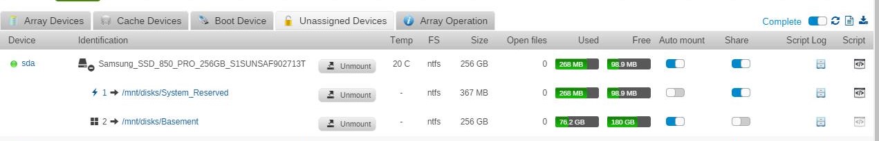

Not sure if this was reported already, but when you select auto-mount partition on a disk with multiple partitions, after refreshing the page all partitions will have auto-mount enabled.
You can set the auto-mount switch off for a partition you don't want mounted.
When I do that the other partitions have the auto-mount disabled on them too.
Click on the + and then manage each partition auto-mount.
I know that. Like I said, it doesn't work. After I refresh the page it changes, either all partitions on auto-mount or none. I tried reinstalling the plugin, didn't work.
Setting any partition as auto mount marks the disk as auto mount.
The auto mount switches have been removed from the partitions in the latest version.  The auto mount applies to the drive, and not to the partitions.  This should eliminate the confusion.
