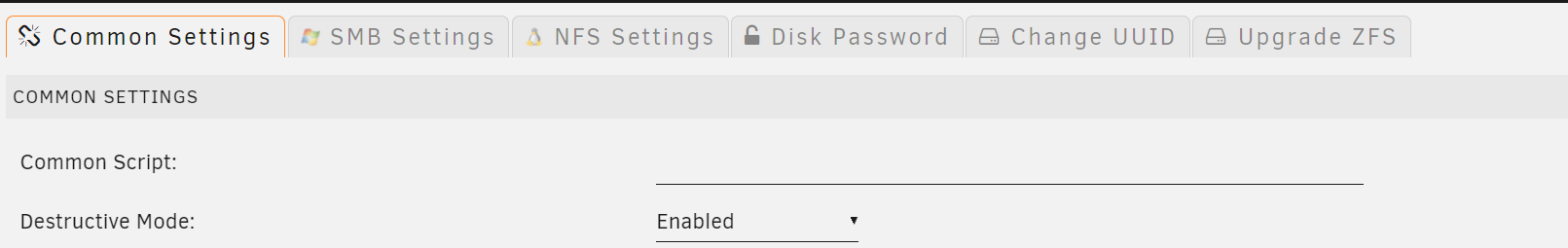

You mean these settings?
These should show regardless of the license.
I just upgraded plugin to ver 2024-0122a and it is working fine on my registered Unraid server and on the trial server.

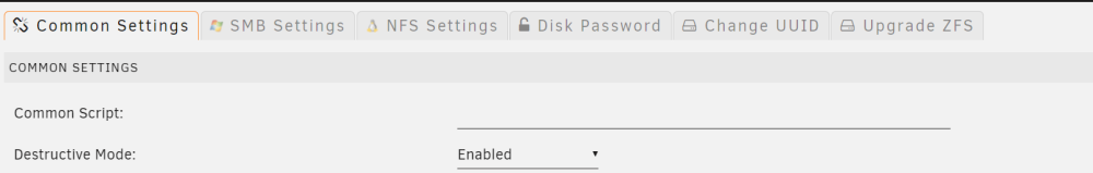

I noticed after applying the update 2024.0122b one of my NTFS UA disks is now a Read Only Share.
And these 2 screen caps are from the Settings UA. Also not sure why I am being asked to the UUID on the disk that is hosting the RO share on my trial Unraid server.
UA NTFS shares on my registered Unraid server are fine after installing the recent upgrade "2024.0122b"
Edited by Vetteman
If an ntfs disk is not shut down properly in windows, it will mount as read only when UD mounts it.  Look in the syslog and you'll see why it was mounted read only.
When a disk is unassigned from the array and then used in UD, it can sometimes show a duplicate UUID and won't mount.  The change UUID only shows disks that might need their UUID changed.  UD is not saying it has to be changed.
