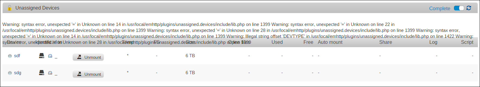

Hi everyone. I'm a total noob to unRAID and am trying it out as a NAS alternative and a location to store my backups. I previously posted my problem here but it was recommended to post in this thread instead.
I've managed to scrounge up an HP dual-Xeon computer that I'd like to use as an unRAID server (it's a monster!). So far I have it working with a 500 GB SSD cache drive, a 2 TB parity drive, and two 2 TB array drives. I have Shares configured on it so I can access it from the PCs in my house for media sharing and backing up to.
Here's my problem:
The motherboard is an old one, so it doesn't see SATA drives bigger than about 2 TB. To get around this limit, I'm attempting to use  a pair of 6 TB drives in a Vantec NexStar MX USB RAID box, with the box configured so the drives are treated individually (not RAID or JBOD). UnRAID sees the drives and lets me mount them, but there doesn't see to be any way to format them. In addition, I'm getting this error message overlaid on the Unassigned Devices section of the Main page.
Warning: syntax error, unexpected '=' in Unknown on line 14 in /usr/local/emhttp/plugins/unassigned.devices/include/lib.php on line 1399
Warning: syntax error, unexpected '=' in Unknown on line 22 in /usr/local/emhttp/plugins/unassigned.devices/include/lib.php on line 1399
Warning: syntax error, unexpected '=' in Unknown on line 28 in /usr/local/emhttp/plugins/unassigned.devices/include/lib.php on line 1399
Warning: Illegal string offset 'DEVTYPE' in /usr/local/emhttp/plugins/unassigned.devices/include/lib.php on line 1422
I've attached a screenshot showing what it looks like.
5a529bd02809b_2018-01-07UnRAID6TBProblem.thumb.jpg.16424cc7361f96c7fc4bec3ccf8e3b27.jpg
Have I run into a limitation with unRAID or am I doing something wrong?
Any help would be appreciated. Thanks!

What version of UD are you using?  Post diagnostics.

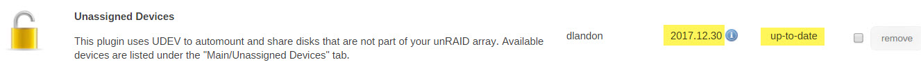

It says I'm running version 2017.12.30 and that it's up-to-date, but I see from other users that they have a more current version. Why does mine say that it's up-to-date?
Diagnostics attached.

I haven't run 6.3.5 in a while, but there should be an update button in the upper right part of the plugins page.  Click on that and it will check for updates.
There seems to be a problem with your configuration file.  Please post the the /flash/config/plugins/unassigned.devices/unassigned.devices.cfg file.
