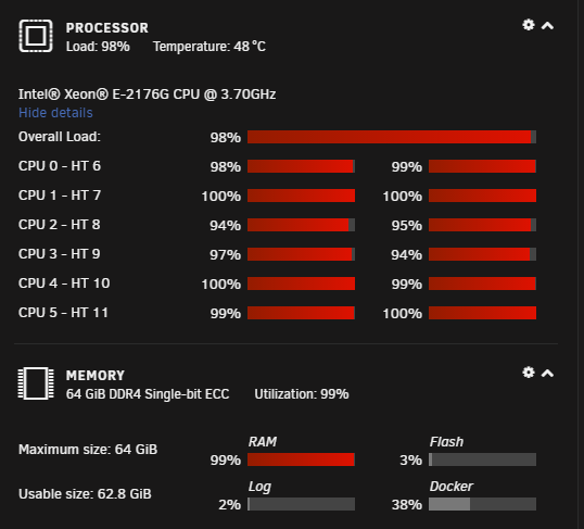

Memory usage very HIGH? [Solved]
Hi All
I have 64 Gigs of RAM (Useable 62.8 GiB)
I have multiple Dockers (Not been a issue before adding new VM's)
My VM's
2 x Windows 10 = 6144 MB = 12G
1 x pfSense = 3072 MB = 3G
1 x Hassio = 2048 MB = 2G
1 x Xpenology = 8192 MB = 8G
Total: 25G
Docker 38% of 62.8G = 24G
Left = 13G

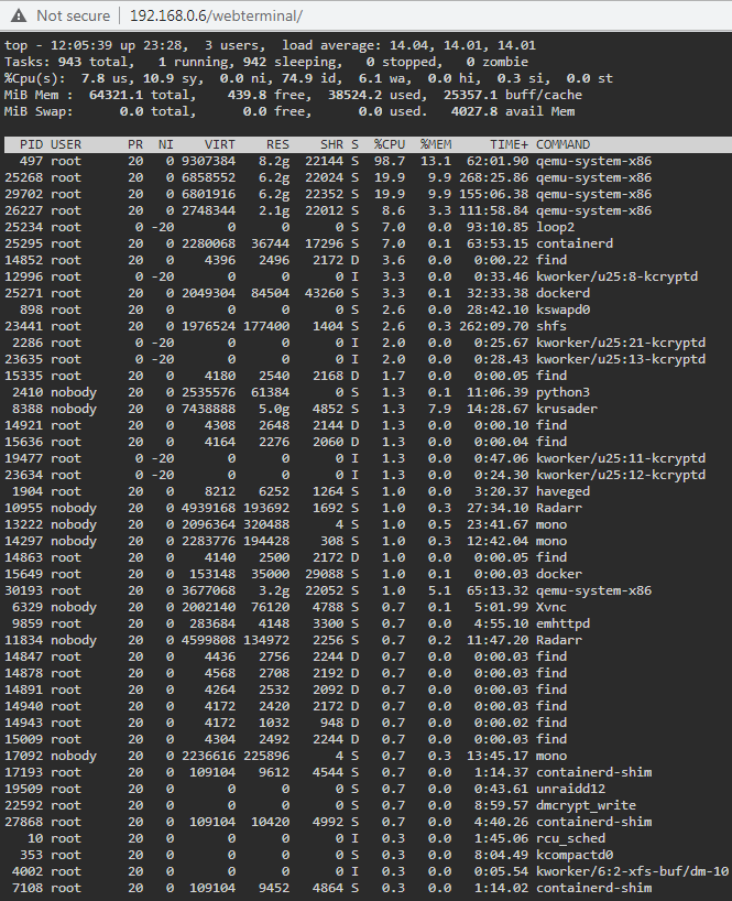

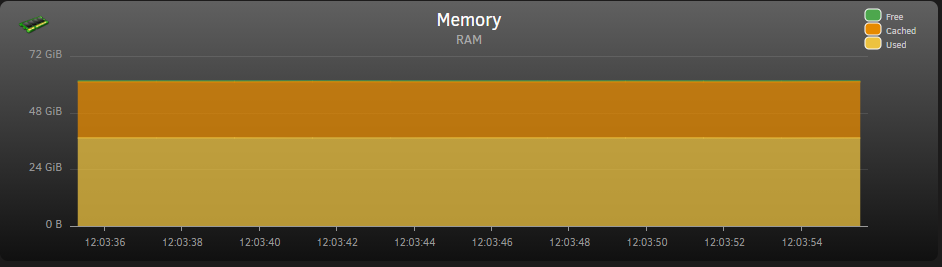

The Load:
TOP:
Do I just need more RAM? (This system have a max of 64G 😞 )
Any tips to where I can cut memory usage?
I got the CPU usage down by selecting different cores for each system
As always your insight and expertise is much appreciated!

Yes but something is using more RAM than before never got this before?
Keep in mind that you are excluding the host (containers included) from using any RAM you give to VM's. Many times it's better to give the VM absolute minimum required resources for performance and allow the host to manage everything you can give it.

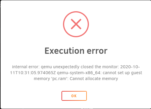

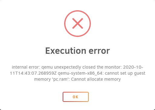

I can't even start the last WIN 10 with 3G now without getting the :
Shouldn't this be possible and then letting the host to use the last 34 Gigs ?
What is the recommended memory value for a windows 10 for office work?
Pretty sure that the VM requires an address contiguous chunk of memory, and your free memory is extremely fragmented at this point. I haven't searched, maybe there is a way to tell the kernel to defragment RAM?
A long shot...
if changes was made to "dirty" memory, and there is a lot of unwritten cache, could that be the reason why the system can't free up enough memory to start the VM?
I know I asked it as a question. The reason is I am not 100% sure myself, how the system would react to this situation. But it is a possibility, I think.

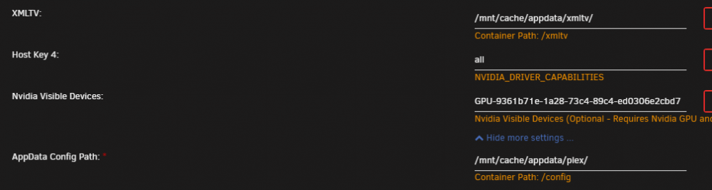

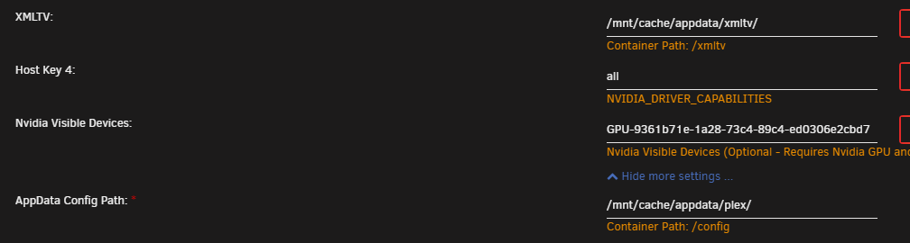

UPDATE
Found the problem - I can now run all the VM I have without getting above error after changing this back to "normal"
This was caused by changing the docker to cache instead of user. This used a lot of memory:

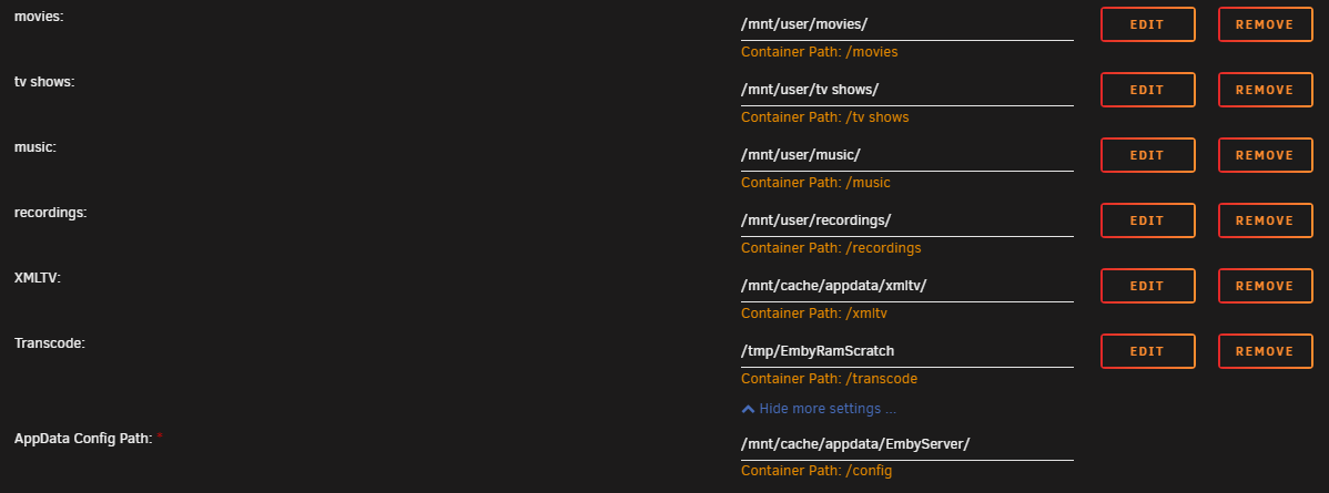

This tweak has nothing to do with your RAM usage. The source of your problem must be something else (or you used a path, that targeted your RAM). Do you use transcoding to RAM and use the /tmp or /shm folder? Than this is your problem.
Next time you should investigate the RAM usage before restarting your server / containers. Use this command:
ps aux | awk '{print $6/1024 " MB\t\t" $11}' | sort -n
In addition check the sizes of your Ramdisks as follows:
df -h -t tmpfs
And finally you could check the size of your tmp folder which is even located in your RAM:
du -sh /tmp
Edited by mgutt
Thanks! much appreciated! -  I will try this next time I try the "cache" path again. (Yes I transcode to RAM but this was not the issue! - I had no trancodes and I even tried stopping PLEX)
Edited by casperse
I don't get the error anymore but Memory is going up

39.6484 MB              php-fpm:
39.7539 MB              php-fpm:
39.9492 MB              php-fpm:
41.4102 MB              deluge-web
43.1602 MB              Plex
51.0469 MB              /usr/sbin/python3
54.082 MB               python3
69.332 MB               python3
81.8398 MB              /usr/bin/dockerd
138.496 MB              /app/radarr/bin/Radarr
146.586 MB              /usr/local/sbin/shfs
158.039 MB              /opt/ombi/Ombi
166.699 MB              /usr/lib/plexmediaserver/Plex
167.602 MB              /app/Jackett/jackett
178.035 MB              /app/radarr/bin/Radarr
192.16 MB               mono
197.223 MB              mono
230.992 MB              rslsync
291.141 MB              mono
329.223 MB              system/EmbyServer
331.602 MB              /usr/sbin/mysqld
350.137 MB              java
2120.78 MB              /usr/bin/qemu-system-x86_64
3245.57 MB              /usr/bin/qemu-system-x86_64
4245.45 MB              /usr/bin/qemu-system-x86_64
4271.35 MB              /usr/bin/qemu-system-x86_64
16604 MB                /usr/bin/qemu-system-x86_64
The last 5 is the VM's with a total of 30 Gigs is there anything else above docker weise that stands out?
(I was surprised that Emby uses so much and that Plex have so many different processes)
It seems you did not setup a separate transcoding ramdisk. Do you use /dev/shm? Then this could be your problem. /dev/shm has a total size of 32GB and Plex will fill it over time. Not only for live transcoding, even for optimized versions and live tv streams etc. This is a general temp folder for all transcodings. Its better to define a separate folder with a specific size as described here:
https://forums.unraid.net/topic/35878-plex-guide-to-moving-transcoding-to-ram/page/12/?tab=comments#comment-894460
I used 4GB in the past which works flawlessly up to 3 or 4 parallel running 4K transcodings. After I did a benchmark and hit the maximum of my iGPU, I changed it to 8GB as I received an "out of storage" error in Plex, but finally this shouldn't be needed in usual usage. 4GB is sufficient because Plex cleans up the folder automatically when it occupies >95% of the total size.
Plex uses multiple processes to load-balance them across multiple cores/threads. Maybe Emby has only one single-thread process?!
Repeat the command later, so we can compare the results.
Another command to check the size of your /tmp folder (which targets your RAM, too):
du -sh /tmp
Edited by mgutt
du -sh /tmp
I used this guide when I first created my Plex server to use my RAM for transcoding:
Guess things have evolved since then ;-)
UPDATE: Did the script and its working
One question should I schedule this to run in the User Scripts?
Edited by casperse
Where would I set the script?
I would say the guide was not optimal since the beginning as "/tmp" uses (as far as I know) the complete RAM size.
In my last post you find the link to the full guide to create a ramdisk with a specific size. I asked @jonp to update his guide, but it seems, he didn't have the time for it yet.
Edited by mgutt
7 minutes ago, mgutt said:
I would say the guide was wrong since beginning. It was never clever to use the full ram size as transcoding path (which "/tmp" does as far as I know).
I have created the script in the "User Scripts" and updated the path (Thanks!) its working
Only thing I can't figure out is if I have to enable schedule for this script here?
UPDATE: Excellent guide thanks all is running now!
Edited by casperse
Yes schedule to "on array startup" (is explained in the guide as well ;) )
I went back and enabled the cache path for the docker.img :-)
Only activity I can see is Plex scanning libraries - no transcoding
So the CPU could be indexing and preview thumbnails?
But memory is back to 99%-100%
du -sh /tmp
20G     /tmp
df -h -t tmpfs
Filesystem      Size  Used Avail Use% Mounted on
tmpfs            32M  632K   32M   2% /run
tmpfs            32G  8.0K   32G   1% /dev/shm
cgroup_root     8.0M     0  8.0M   0% /sys/fs/cgroup
tmpfs           128M  1.9M  127M   2% /var/log
tmpfs           1.0M     0  1.0M   0% /mnt/disks
tmpfs           8.0G     0  8.0G   0% /tmp/PlexRamScratch
(Yes I did set the PlexRamScratch to 8G just to be sure.... like you did I have a P2000 doing the trancodes and I don't want the RAM to be a bottleneck)

10.9336 MB              /usr/sbin/winbindd
11.3438 MB              php-fpm:
12.2266 MB              /usr/local/emhttp/plugins/unbalance/unbalance
12.5273 MB              /usr/sbin/winbindd
13.0664 MB              php-fpm:
13.0664 MB              php-fpm:
13.0742 MB              php-fpm:
13.3711 MB              php-fpm:
13.4844 MB              php-fpm:
13.5625 MB              php-fpm:
13.5625 MB              php-fpm:
13.5977 MB              /usr/local/emhttp/plugins/controlr/controlr
14.6719 MB              /usr/bin/python
14.7695 MB              php-fpm:
14.8789 MB              /usr/bin/python
14.9844 MB              /usr/bin/python
15.0859 MB              /usr/sbin/smbd
15.1484 MB              /usr/sbin/smbd
15.1992 MB              /usr/sbin/smbd
17.4922 MB              /usr/bin/python
17.9062 MB              /usr/sbin/smbd
20.4023 MB              /usr/lib/plexmediaserver/Plex
20.6523 MB              /usr/sbin/smbd
21.168 MB               /usr/bin/python
22.4844 MB              /usr/sbin/libvirtd
25.3398 MB              Plex
26.5938 MB              python
34.2461 MB              /usr/libexec/Xorg
34.8789 MB              Plex
35.5273 MB              docker
37.1523 MB              Plex
37.3242 MB              Plex
37.9258 MB              containerd
38.168 MB               /usr/bin/python
39.0625 MB              deluge-web
40.3359 MB              php7
43.6914 MB              php-fpm:
43.8945 MB              php-fpm:
45.5078 MB              php-fpm:
51.5078 MB              /usr/sbin/python3
52.168 MB               /usr/sbin/Xvnc
54.707 MB               python3
64.25 MB                Plex
79.7578 MB              /usr/bin/dockerd
104.973 MB              python3
110.766 MB              /app/radarr/bin/Radarr
136.883 MB              /usr/local/sbin/shfs
141.602 MB              /app/Jackett/jackett
144.734 MB              /opt/ombi/Ombi
146.723 MB              mono
167.867 MB              /app/radarr/bin/Radarr
188.879 MB              mono
280.812 MB              mono
293.574 MB              system/EmbyServer
332.719 MB              /usr/sbin/mysqld
359.27 MB               java
788.543 MB              rslsync
914.41 MB               /usr/lib/plexmediaserver/Plex
2107.17 MB              /usr/bin/qemu-system-x86_64
3276.16 MB              /usr/bin/qemu-system-x86_64
4268.11 MB              /usr/bin/qemu-system-x86_64
4302 MB         /usr/bin/qemu-system-x86_64
5088.28 MB              krusader
16605.5 MB              /usr/bin/qemu-system-x86_64
Again thanks for your help! much appreciated
Check whats inside your /tmp dir. The size is 20GB! It should be nearly nothing (or at most 8GB, but regarding your df command the PlexScratch dir is empty, so it should be nothing inside this dir).
Example:
du -h --max-depth=3 /tmp
Why does krusader need 5GB?!
Which Plex Container are you using? (Linuxserver, binhex, original...)
Did you set the docker.img in the general settings to /mnt/cache or only the Plex config path or both? If possible provide screenshots of those set paths.
Edited by mgutt
0       /tmp/mc-root
0       /tmp/PlexRamScratch/Transcode/Detection
0       /tmp/PlexRamScratch/Transcode/Sessions
0       /tmp/CA_logs
0       /tmp/Transcode/Detection
0       /tmp/Transcode/Sessions
0       /tmp/Transcode
20G     /tmp/transcoding-temp     <-------------------------------- Dont know why this is here?

The " /tmp/transcoding-temp" might be Emby? can I remove this folder from RAM  (Emby is just for test and no one is using this server)

Docker:
Plex: I didn't think I needed to change this to cache, but I guess that would be best since I have all 800G in my cache NVMe
So I will change this now:
(I just changed this for Emby also, using the same transcoding dir in RAM)
Can I just delete this? No idea where its from?
Deleting these old transcode folders (Shouldnt they be delete automatically?)
Update looks like this is from Emby:
After deleting this folder, and pointing EMBY transcode to the same "PlexRamscratch"
I now get:
du -sh /tmp
183M    /tmp
And my memory is now: down to normal JAHUU!
Ok, now things become clearer. My original tweak is only to change the plex config path to /mnt/cache and not the general docker.img path. This means you quoted my tweak in your "warning", but you even don't use it:
https://forums.unraid.net/topic/88999-unraid-tweaks-for-media-server-performance/?tab=comments#comment-901831
Changing the general docker.img path is a different tweak, but I didn't even write a guide for this. I use it, but wasn't able to test it with multiple dockers. So its more a "beta" thing. Maybe Emby has a problem with that. If I find the time, I will test that. Can you send me a screenshot of your Emby settings so I can test this with the same settings?
I have no experience if Emby is able to clean up the dir as Plex does it. I would suggest to add an additional ramdisk for Emby alone. The steps are the same (could be added to your existing script):
mkdir /tmp/EmbyRamScratch
chmod -R 777 /tmp/EmbyRamScratch
mount -t tmpfs -o size=8g tmpfs /tmp/EmbyRamScratch
Now set this path in your emby container as transcoding path. By that it would be also easier to disinguish between the container's ramdisk usage.

I found that no matter what path I write in Emby it will create a subdir in the tmp/ram dir as "transcoding-temp"
I deleted this and used your script to create a EmbyRamScratch that it can create the "transcoding-temp" under
So far no problems after this change! works great!
