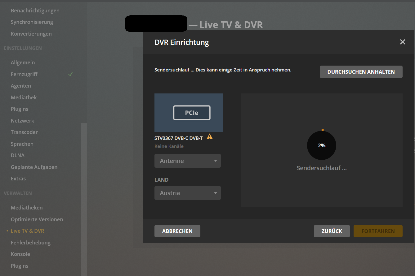

I can see the tuner just fine in Plex itself, which container are you using, the one that is made by Plex Inc. iteself?
Screenshot (sorry it's in German but I think you will see that it should work - I think since this is not a supported tuner and we have a very weak DVB-T network here I will don't get any results, I use the plex/plexinc container):

I tried it with the plexinc/pms-docker, please try to use this container for testing purposes (I think in the case of Plex you can install multiple servers at once).
Seems to work! :)
Must be something with the binhex plexpass docker; any idea what it could be?
@anon1105 may ask in his support thread, maybe some dependencies not added in his container ...
Will do, thank you @ich777 and @alturismo for helping me out.
