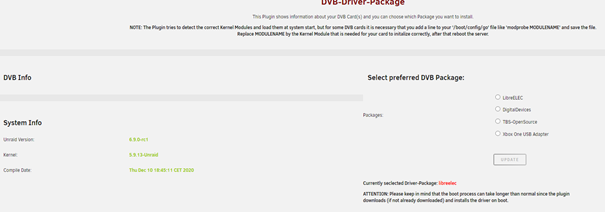

[Plugin] DVB-Driver
Edit: added installation screenshot

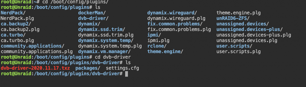

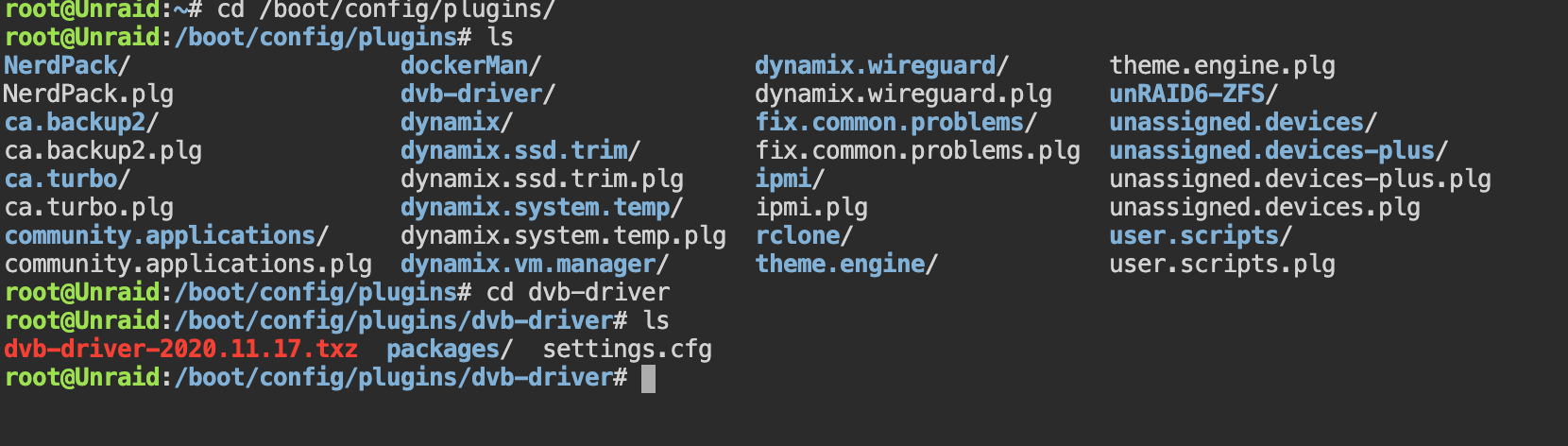

What files are in /boot/config/plugins/dvb-driver after the installation of the plugin?
Inside dvb-driver are the following files and folder:
dvb-driver-2020.11.17.txz  packages/  settings.cfg

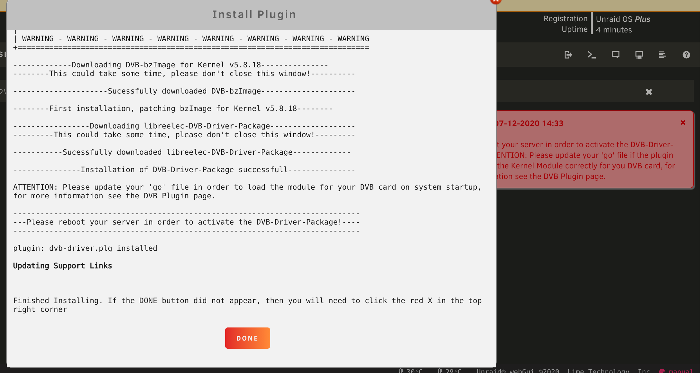

Have you waited until the plugin is installed successfully and the 'Done' button appeared or did you close it with the red 'x' button on the top right corner?
yes
I think it doesn't or at least can't download the package that needs to be installed...
Have you PiHole installed in your network somewhere?
this could be. i use pihole. I disabled it and tried again with the same error.
What is wrong with this? beta35 is on Kernel 5.8.18.
Please forget it. It was just an idea, maybe somethings wrong here...

Can you give me a screenshot what it says after the plugin is fully downloaded (the windows where it installs the plugin)?
Also what is in the folder packages? There should be a subfolder with the actual Kernel version and in that folder should be the package and some kind of a bzimage.

Yeahhh it works now!!!!!
I disabled whole docker and set a public dns on eth0.
You are right, something blocked it.
Many many thanks, i had never thought its something like this

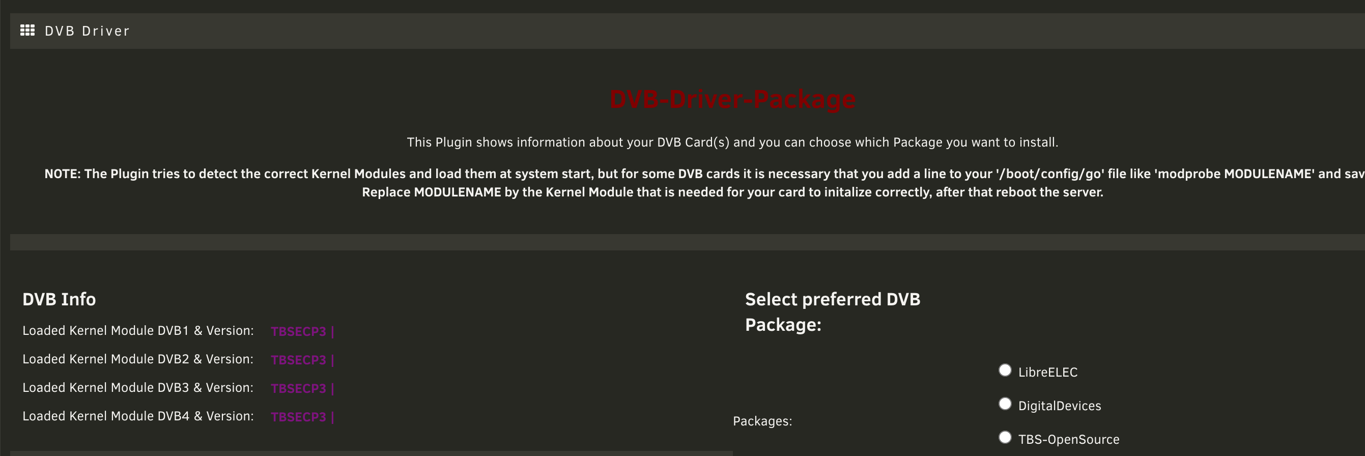

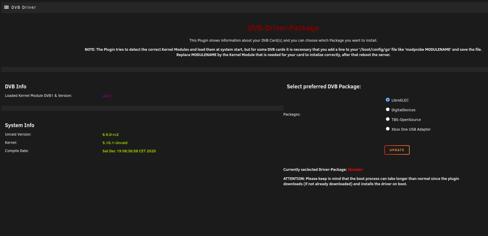

What does the plugin say? Can you post a screenshot?
Looks like from your dmesg output something is wrong:
pctv452e: I2C error -121
Is the Tuner displayed in Tvheadend?
EDIT: How did you pass the devices through to the container, eventually also post a screenshot of the template please.
Screenshot in the annex. I know, that some I2C errors are "normal", maybe also this one?

USB2.0

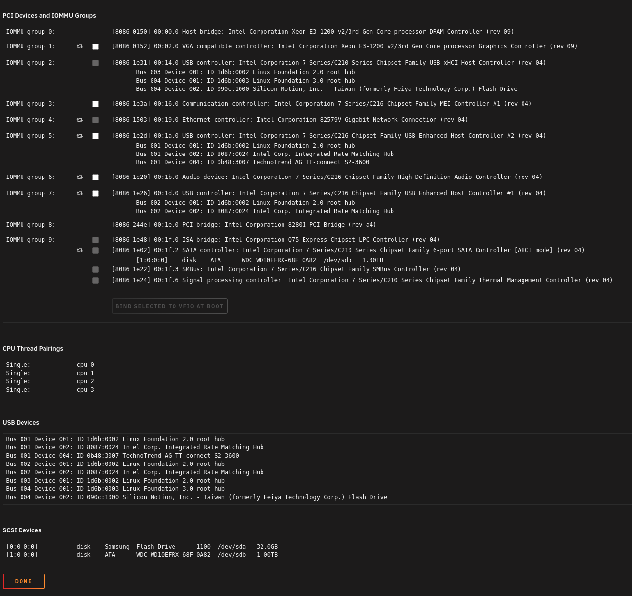

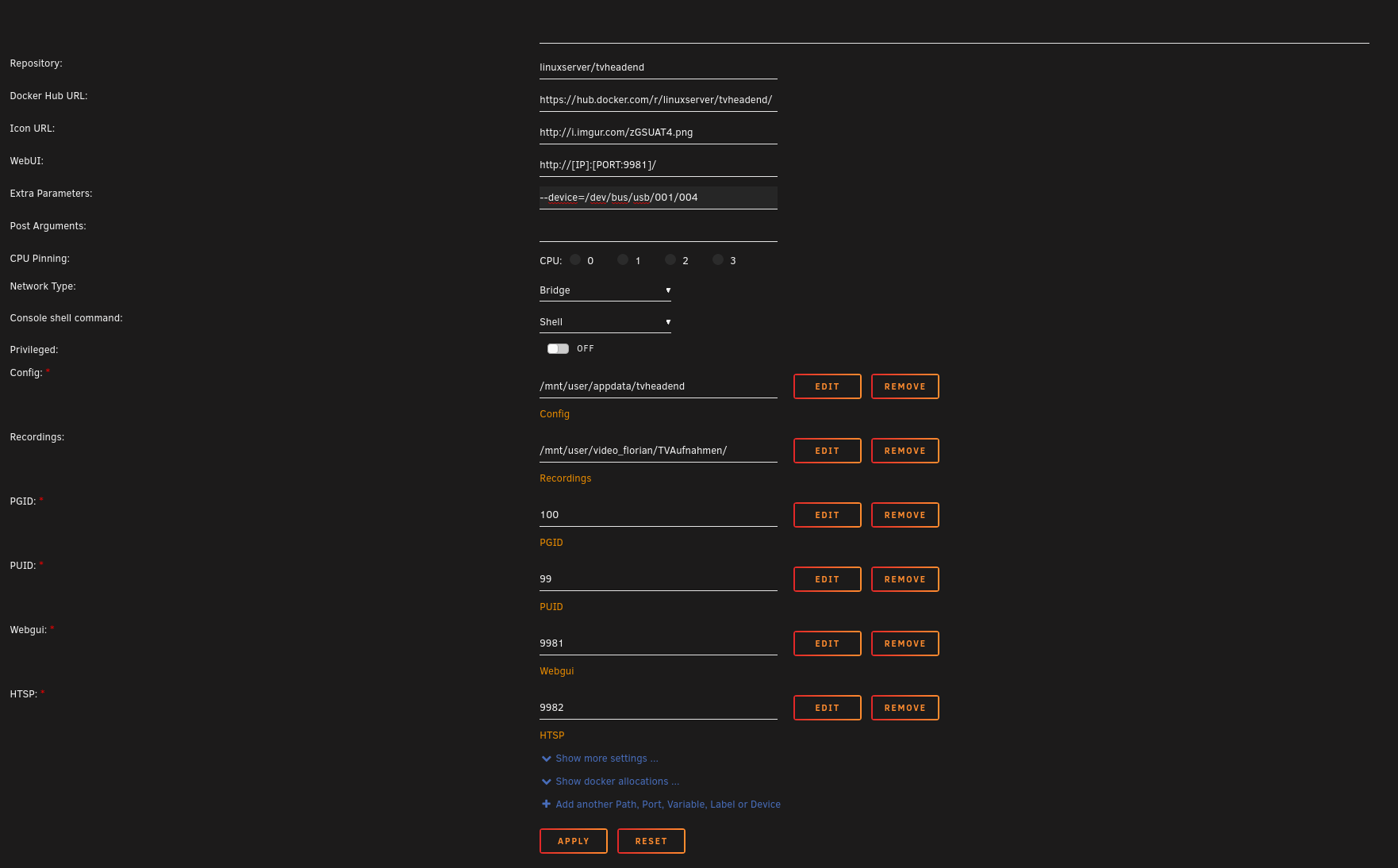

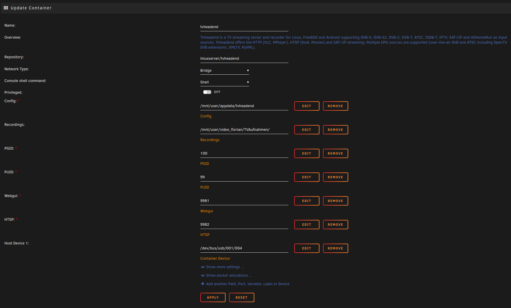

In the docker container no,

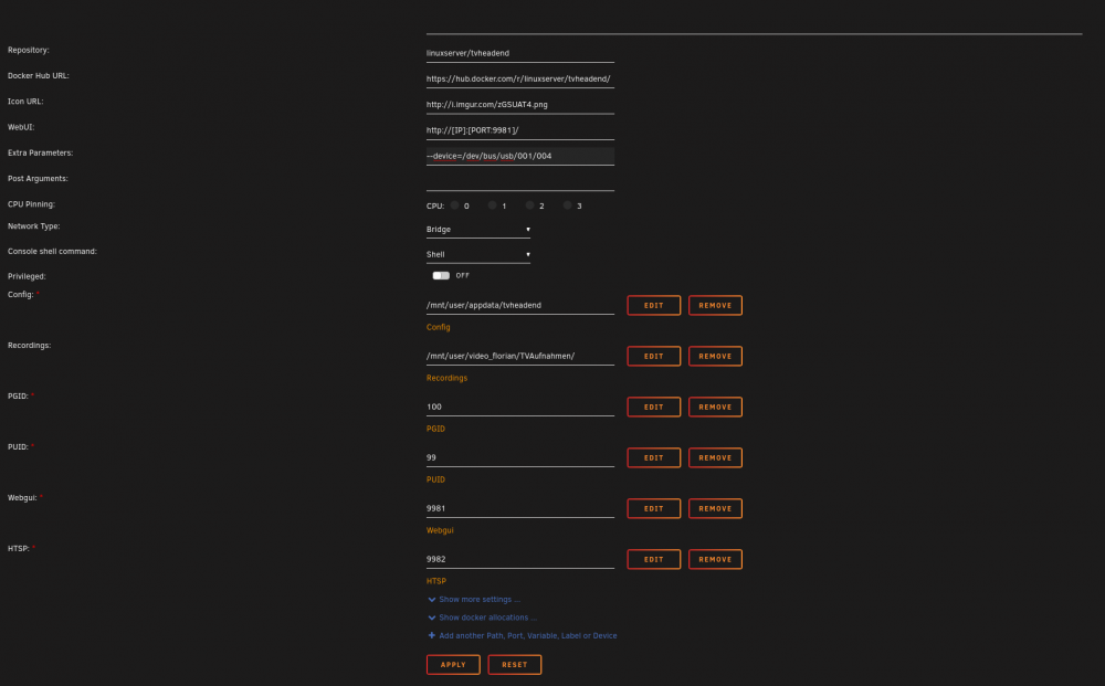

How did you passed the Tuner to the container? Please also post a screenshot from the template if possible.
Are you using the container from Linuxserver.io?
Can you try to open up a console from the container (click on the container and select 'Console') and do 'ls /dev/dvb' and post the output here?

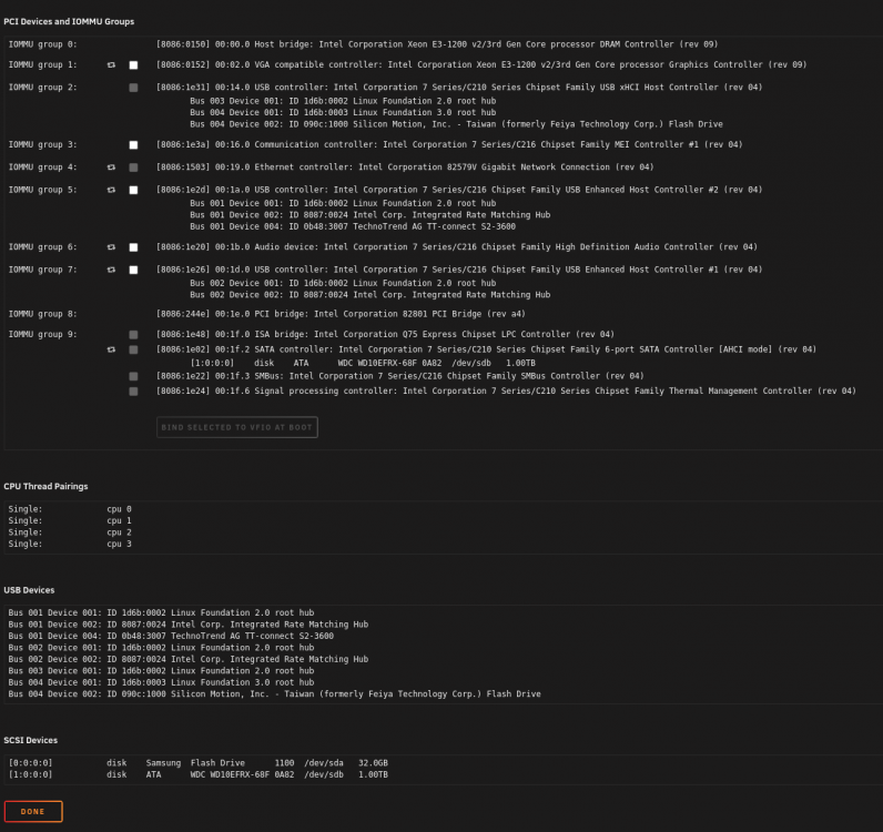

Please see below. I also posted a screenshot from my system devices.
Yes
The output is: "ls: cannot access '/dev/dvb': No such file or directory"
5 minutes ago, Maginos said:
The output is:
I think we've found the problem the line in the template should only be: '--device=/dev/dvb' and not more (if you do it like in the first screenshot in the extra parameters) if you do it like in the second screenshot with the Host device the path should also be only: '/dev/dvb'
