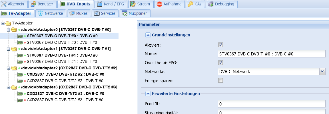

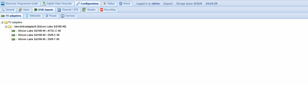

Here's the hardware overview in Tvheadend:
The disabled Silicon Labs card is the DVBsky one, the enabled DRXK is the Terratec H7 one

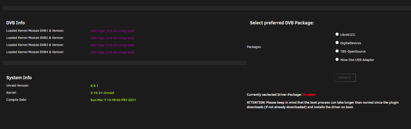

Has any consideration been given to change the name of this plugin?  Isn't DVB a European digital video broadcasting standard?  That is one of the uses of this plugin, but I believe it is also used in other parts of the world for ATSC tuners, and encoders that capture HDMI or Component video. I use it with the Hauppauge HD-PVR to capture the output of Cable TV boxes in Canada. When I first started using unRAID and I was told that I needed this plugin I was confused as I don't use DVB.
Wouldn't something like Media Server Plugin or Media Capture or Video Capture plugin be more accurate?

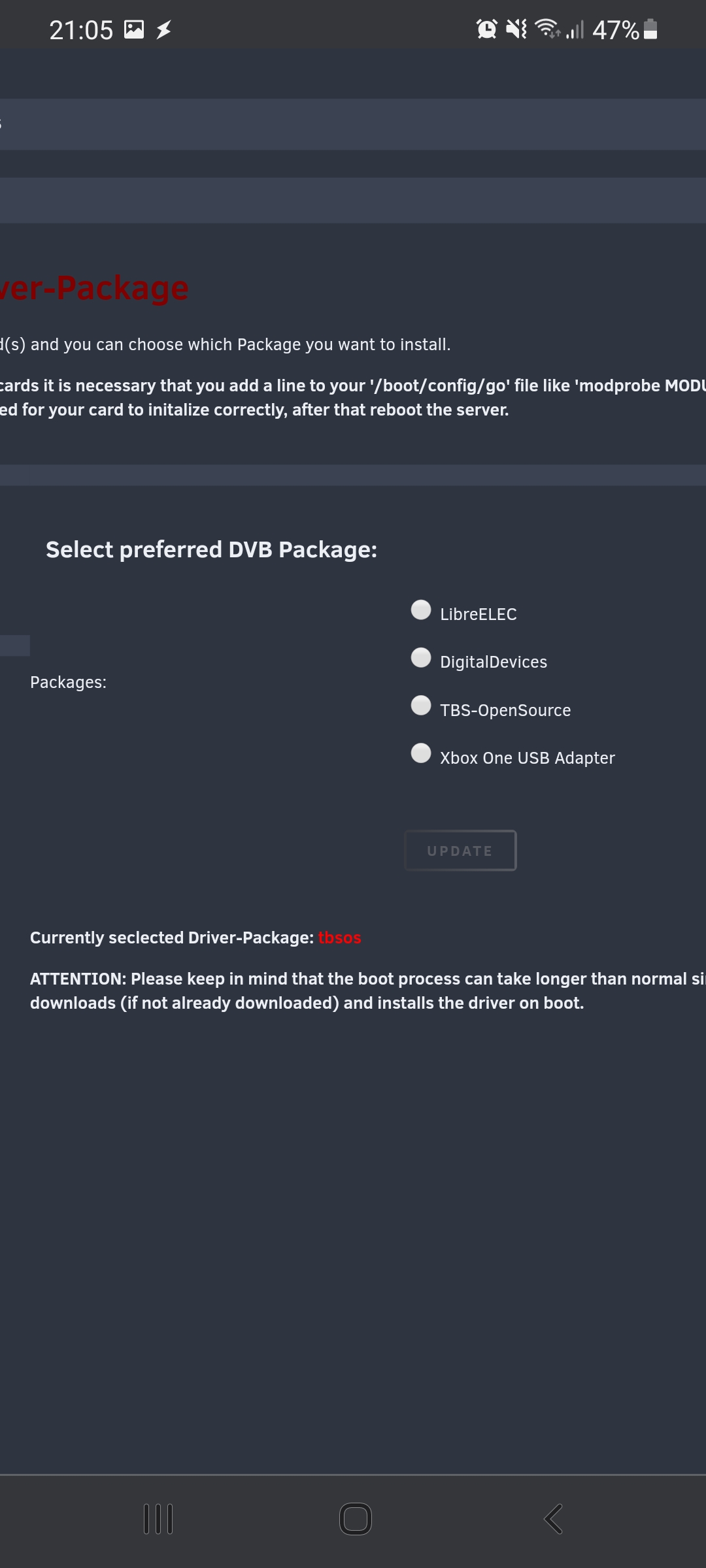

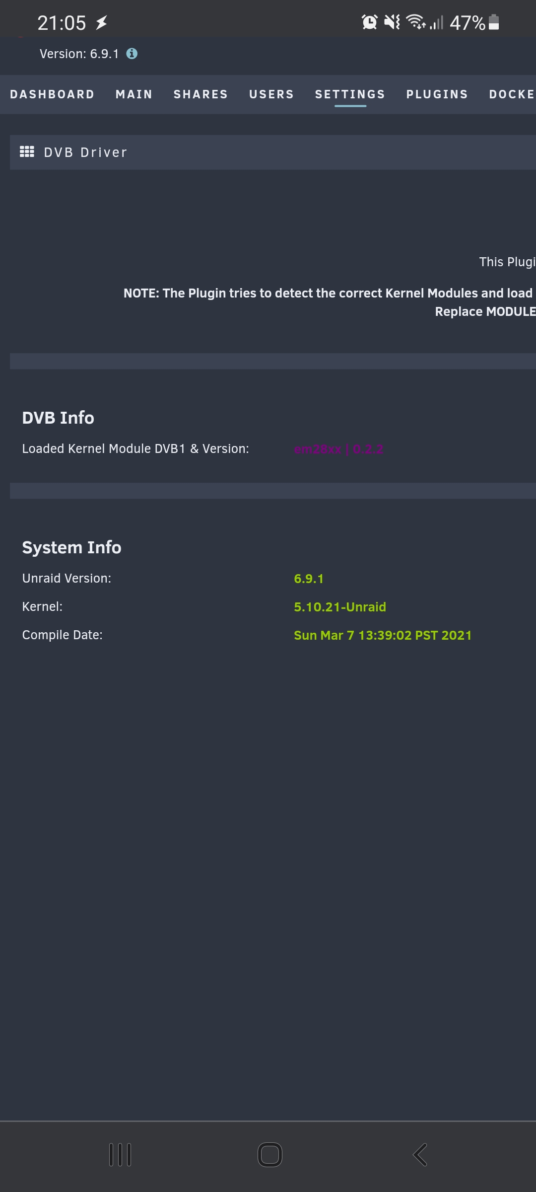

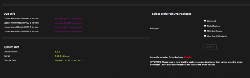

I think I've made progress. I had pci-e card that was throwing alot of errors that made me abit embarrassed to post the logs!
I can see it in the plugin now using the tbs-opensource driver. But when I pass it to plex and tvheadend it can't find us any channels. Is that a device issue or a driver issue?
Ps sorry the screenshots are mobile ones
voyager-diagnostics-20210314-2057.zip
Edited by Kodash
Added screenshots
DVB is in general DigitalVideoBroadcasting is a international standard from what I know ans a well know acronym (also because of DVB-S).
Are you sure that this name would not produce more confusion, I can rename it to DVB/ATSC/ISDB/DTMB/DMB Driver.
Isn't for example DVB-S not available worldwide?
You have to set it up correctly in TVHeadend this can be a little bit tricky...
Have you done the install wizard setup? In Plex this is also a bit tricky I think because the channels that you hand over from TVHeadend must have a valid EPG to see it in Plex.

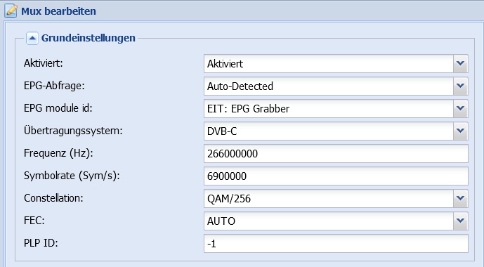

I think there is something wrong with your settings (you should only enable the featureset of the tuner that you want to use something like in my case DVB-C and in your case only DVB-T):
Then be sure to assign the Network to the tuner like so:

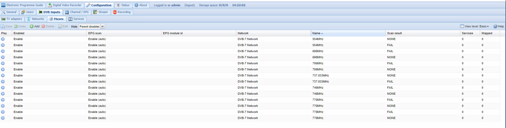

and after that you should be able to create a Mux (something like in my case for DVB-C but only for DVB-T):
Then it should hopefully start to scan and find all channels.

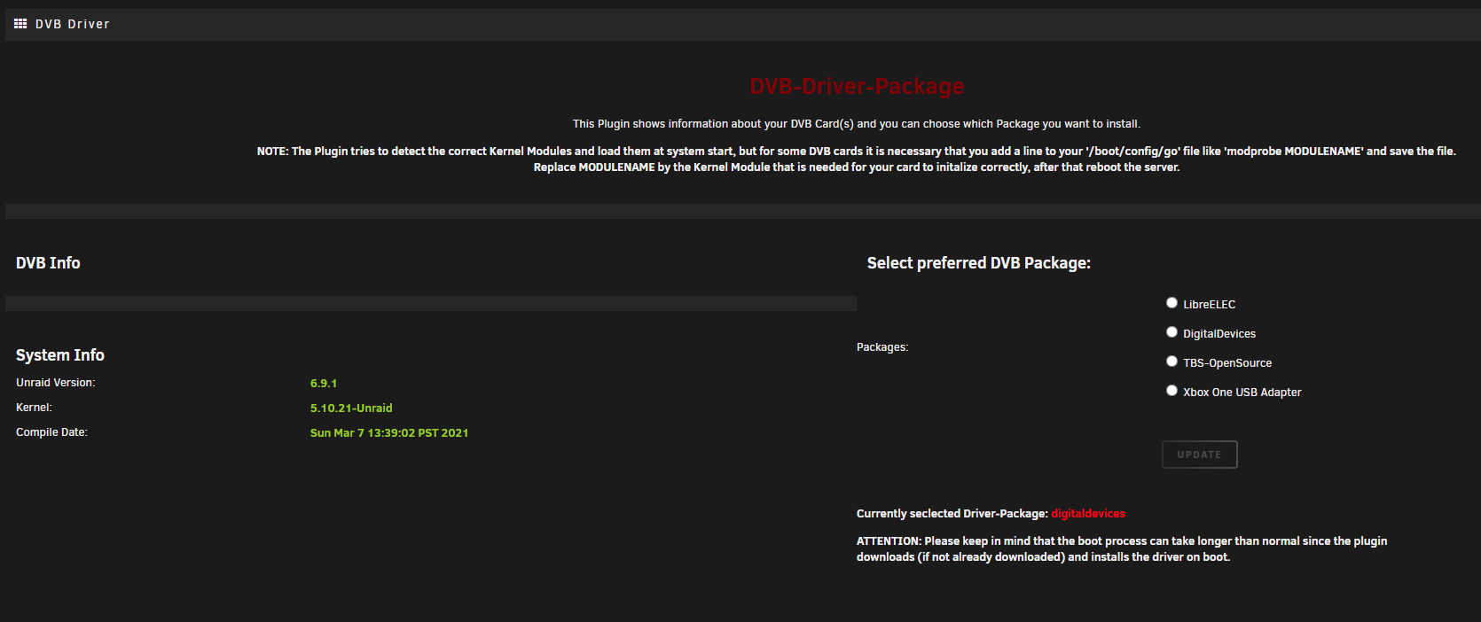

I enabled digital devices drivers in the plugin then rebooted. Here is the information you asked for :
lspcivv.txt
tower-diagnostics-20210320-2228.zip
ls /dev/dvb complains about the folder not existing.
And the plugin page looks like this :
When I switch to librelec and reboot :
Let me know if you need anything else.
Can you try it one more time with the DigitalDevices drivers and try to do 'modprobe ddbridge' after you rebooted and see if the path /dev/dvb is then there with 'ls /dev/dvb'?

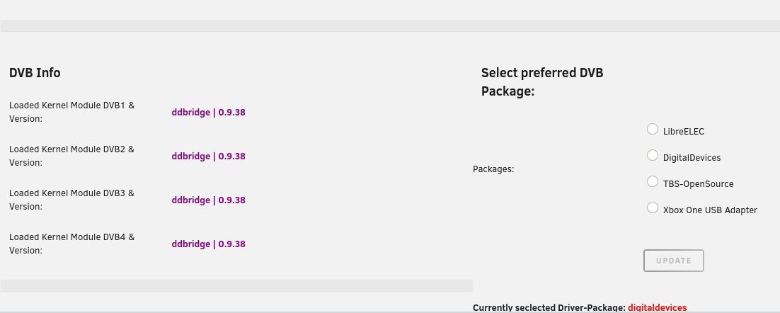

EDIT: Here is the output of my plugin page:

See my screenshot above, all of my Cine C/T v6 are recognized and working just fine.

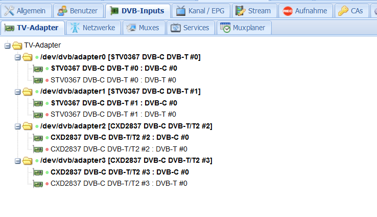

The tunners are not new & the power for them comes from a molex to 2 fdd splitter. I scoured the digital-devices website for the models I have. The octopus is a Octopus PCIe Bridge V2 and the extensions are DuoFlex CT cards (not sure is v1 or v2) .
I did not change anything on the cards myself.
After alot of tests today this is the status: on all driver options except the "digital devices" one (so librelec, tbs and xbox ) all 4 tuners show up in the plugin ( as ddbridge | 0.9.33-integrated ). Tvheadend sees them and it finds services when it scans the muxes (this goes slowly and with a lot of fail results but at this time almost all the channels I need are found).
I m now suspecting that the 0.9.38 driver does not like my cards. Are there any resources that you can point me at about where I can learn to create a package with another driver version ( 0.9.37 ). The link I posted earlier does not work as unraid does not have apt-get or yum etc.
Edited by suyac
added screenshot.
Can you also give me a 'lspci -vv' when you are using the LibreELEC drivers and also the Diagnostics?
The strange thing is that only the CI Interface is listed and not the addon cards with the DigitalDevices drivers.
Yes and no, I can build it for you since this involves some tinkering with my Kernel Helper since I'm only allowing currently the newest driver to be built.
