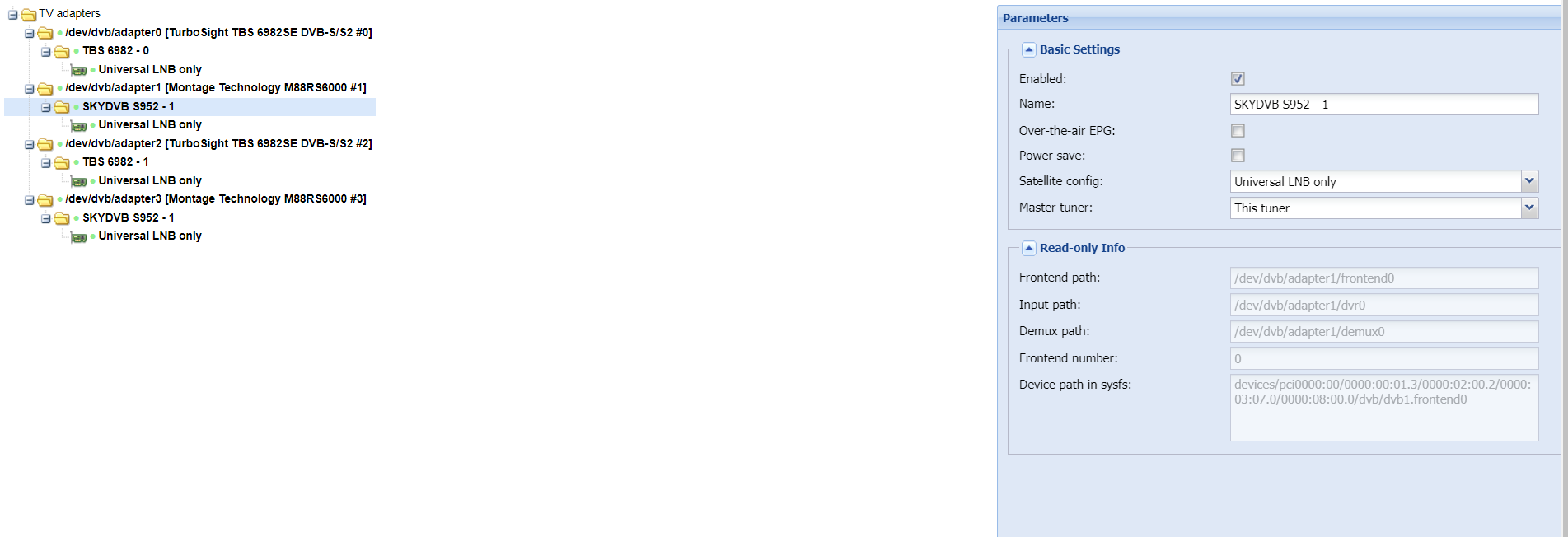

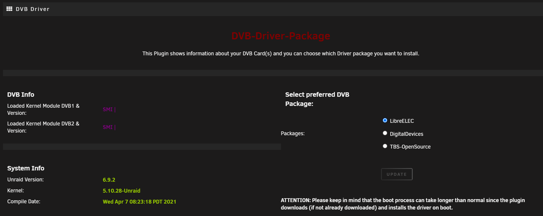

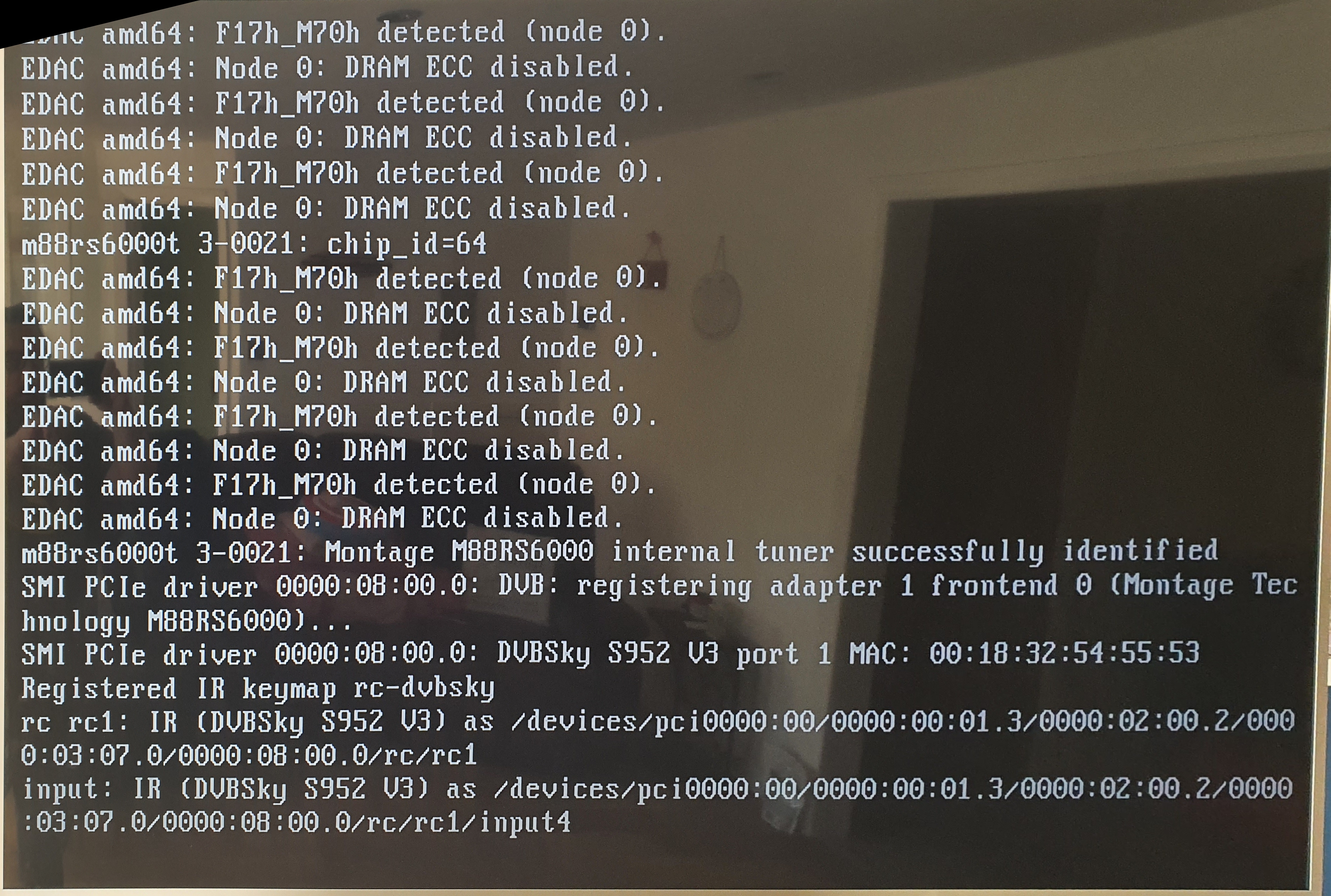

I have changed the drivers to Libreelec and it now hangs on boot. This is the output from the screen.
I used SSH and did a reboot this way and it did the same thing.
Looks like its stuck on the install process. I have Piole installed on the server so changed my router to google DNS and rebooted again thinking this may be an issue. It then rebooted fine.

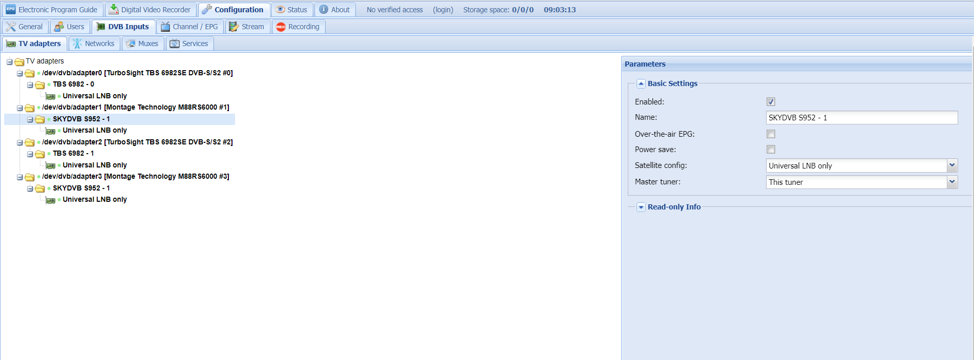

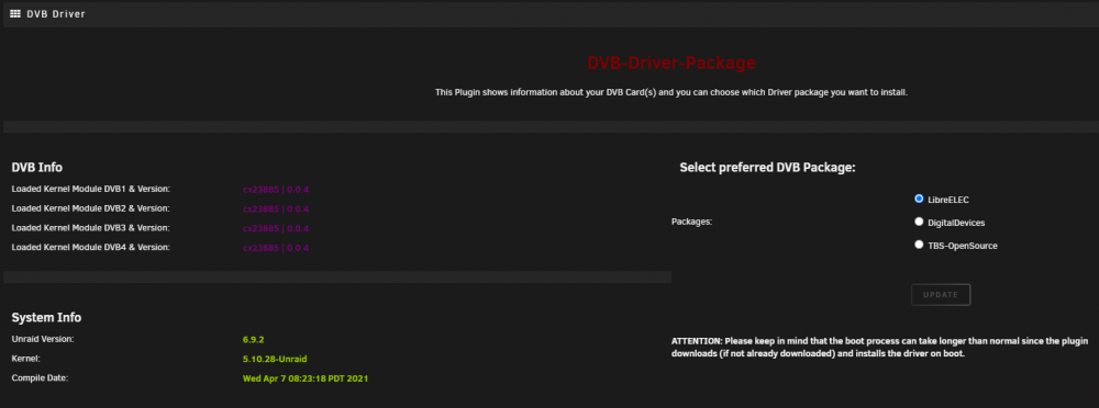

after the reboot its only showing the sky card. attached is a screenshot of the dvb drivers page. There are 3 screenshots showing the devices seen when using the TBS driver package.
I have run lspci and input here. Diagnostic file also attached.

2 hours ago, ich777 said:
Have you tried the LibreELEC drivers yet?
Yes i've done it now.
But it seems that the required drivers are not in the libreelec package, tbsecp3.
But if i read the Libreelec driver thread correctly the card should be supported.
Could you revert the driver package ?
That shouldn't happen because I built in a mechanism that waits for about 30 seconds for an internet connection, can you give me a bit more details on how long you waited?
This is really strange since I only see a "Philips Semiconductors SAA7160" and you DVBSky card in your output, is the Philips one the TBS card?
Also it shouldn't show up in TVHeadend if no module for the card is loaded.

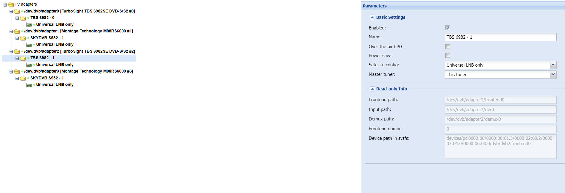

The reboot was stuck for over 10 minutes. I have removed pihole from the router and subsequent driver changes have rebooted fine so must be the issue something to do with DNS pointing to an ip not available.
I have now installed minisatip to see if this shows anything else and when i use Libre i get the Sky card which shows 2 available and they work fine with the cables plugged in. I then install the TBS and it shows 4 i am in the process of using Nextpvr to scan for channels and copy accross to all 4 minisatip devices to see if this will allow me to tune to the tbs and sky cards as i only have 2 cables at the moment. I am waiting for both cards to work together before arranging for more cables to be installed.
Happy to rerun any tests that will hopefully show the issue?
Just finished the scan using libre and got the 800 channels etc. Installed TBS to see 4 devices and its hung on reboot again. Currently sitting at 300+ seconds and the same screen as previously shared showing both devices being found and then hangs.
Edited by LeeK

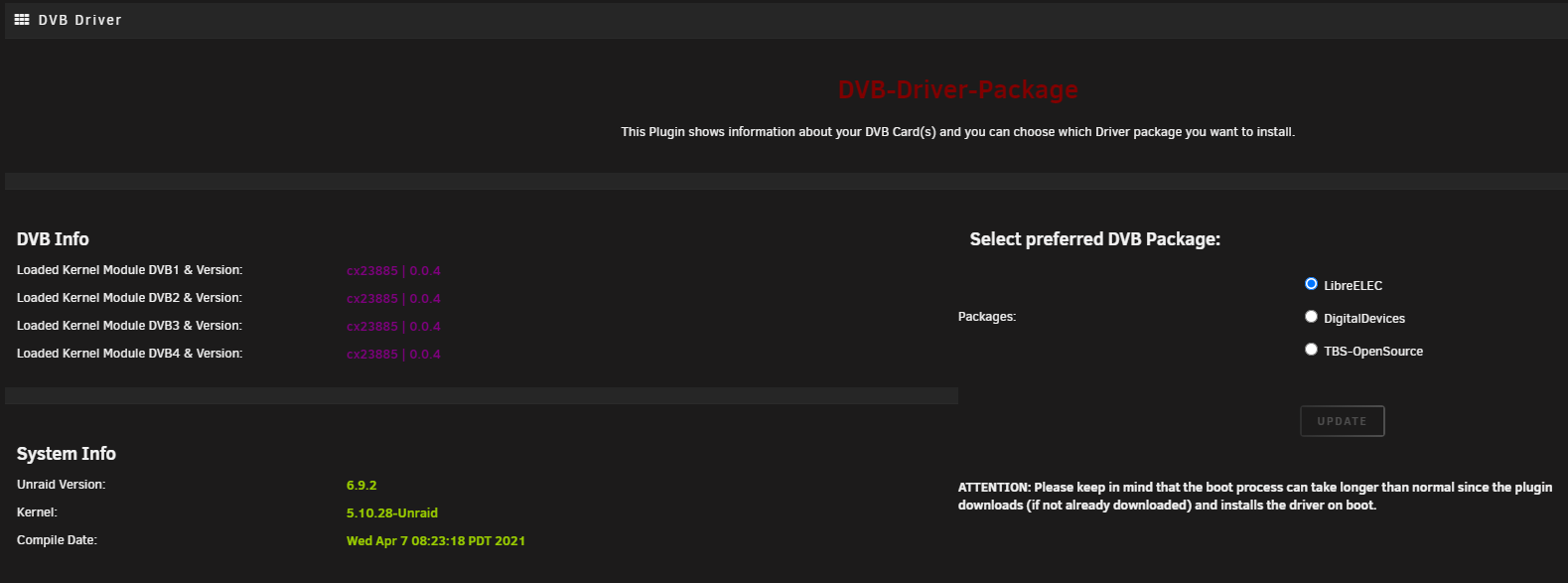

I've been having issues recently with my TV Tuner. I use a Hauppage QuadHD PCIe card, backend tvheadend, via 'antennas' to Plex (all in dockers). Some channels will not tune while others do, later on they'll be fine and others will fail. Using different tuners (1,2,3 or 4) for the playback sometimes works, sometimes doresn't. I haven't had this specific issue before, and just seems to have started recently (since around the 6.9.1/6.9.2 unraid version releases).
dmesg output seems to include the below errors several times, but no idea what they mean.
Are you using the LibreELEC drivers?
You can't roll back to a different version because they are pretty much the same and I only have to compile them for every Unraid version.

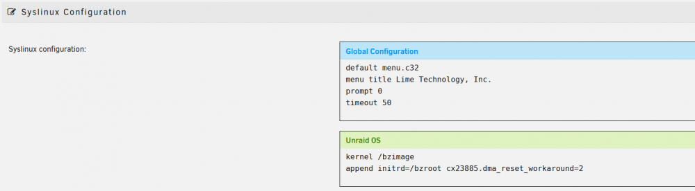

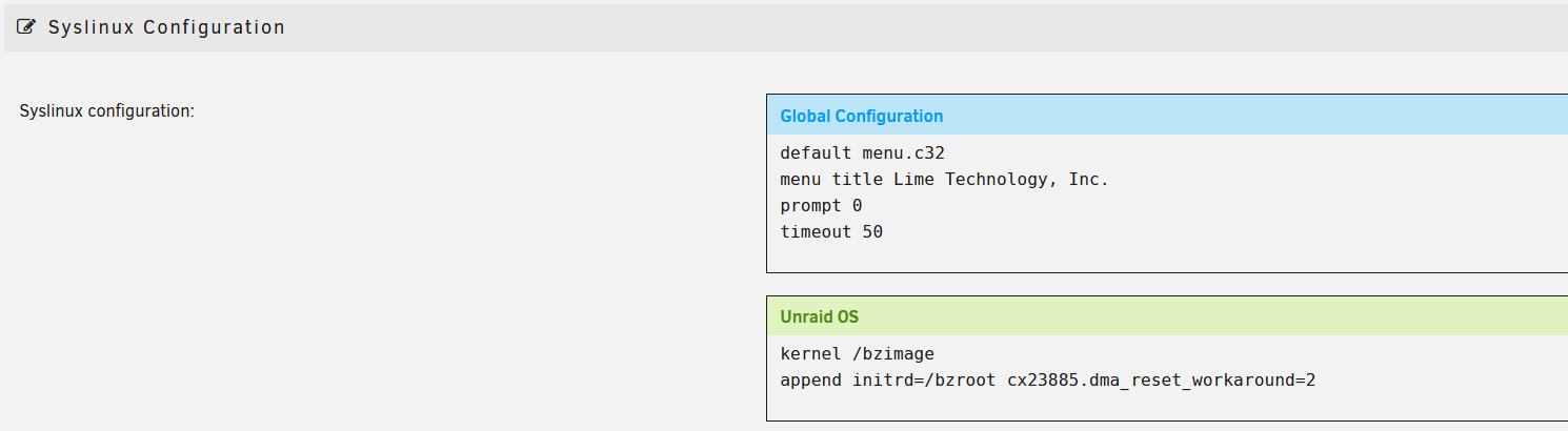

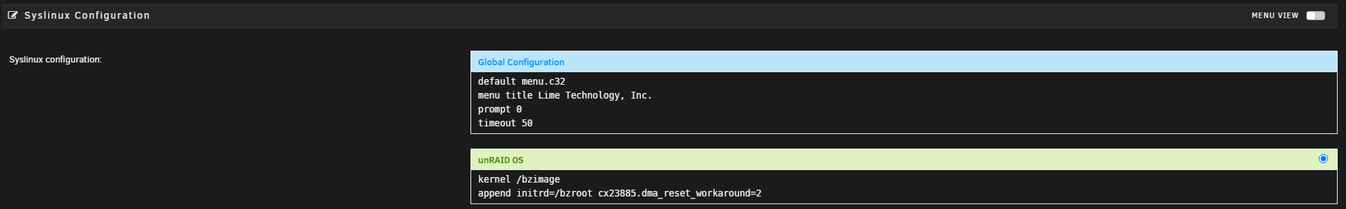

Can you try to append this to your syslinux.cfg: 'cx23885.dma_reset_workaround=2' (on Main click on the blue text that says "Flash" and append this like in the screenshot, click apply on the bottom and reboot):
46 minutes ago, ich777 said:
Is this your card: Click?
Yep that's my card.
I've tried and only the libreelec driver actually recognise my card.
I've added the line as above and rebooted but it doesn't seem to have any effect. Some channels play, others don't, but there is a repeating error in the tvheadend docker log:
2021-04-30 16:13:06.752 [WARNING] linuxdvb: Silicon Labs Si2168 #2 : DVB-T #0 - poll TIMEOUT
The same channel plays fine when connected to a TV directly.
Any other suggestions or logs I can pull?
Edited by Boo-urns
49 minutes ago, Boo-urns said:
Yep that's my card.
Can you try to remove the line from your syslinux configuration again and select the TBS-OS source drivers and reboot after that?
I've found a few reports on Google after searching for that specific error, just put this line in the Google search text box:
Seems like the TBS-OS drivers support your card too.
