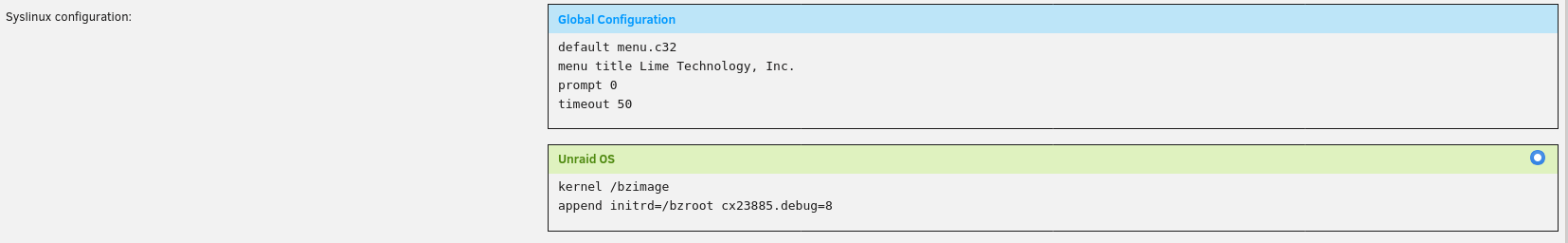

On 3/6/2021 at 3:11 PM, ich777 said:
In Unraid go to 'Main' click on 'Flash' (blue text) then append 'cx23885.debug=8' to the green box like:
press 'Apply' on the bottom and then reboot.
That's it. ;)
SOLVED (Sorta)!!!  My Hauppauge WinTV QuadHD PCIe is now working like normal!!  Thanks again!
EDIT:  Although the card now works as it should, my log memory gets filled to capacity very rapidly.  Not sure how to resolve this.  I'm playing with different debug values now.
EDIT#2:  So I replaced debug=8 with dma_reset_workaround=2 and this solved everything, no more log issues.  A hint to this solution was found here.
Edited by GitBoxer
Not solved due to secondary problem

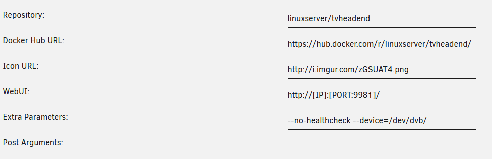

Hello,
First of all, thank you very much for making this plugin!
I use unRAID 6.9.0, Tvheadend 4.3, and TBS-6909 card.
The TVHeadend did not recognize the card until i removed equal charcter /=/ from extra parameter.
In my case the following works:
--device /dev/dvb/
Sorry, it I missed the information in earlier posts.

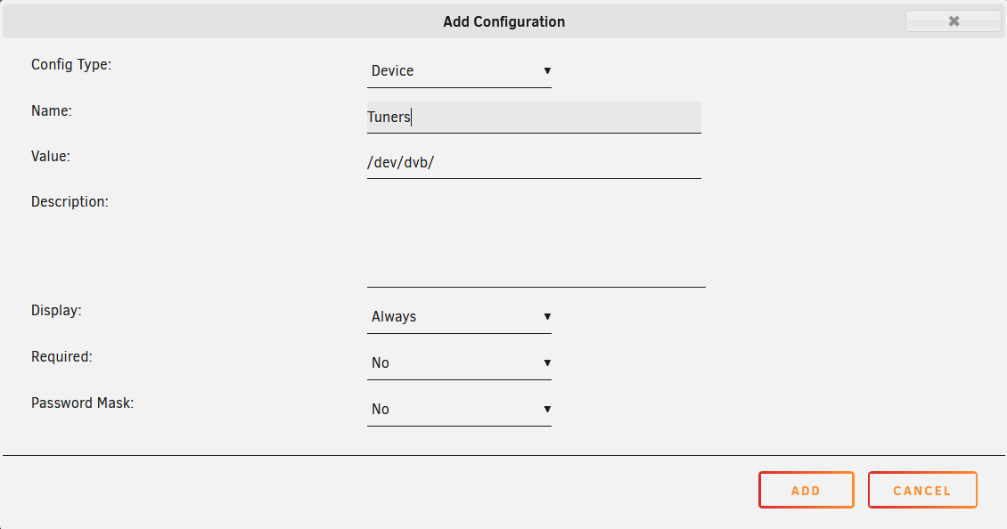

Thank you for the report but in my case this works perfectly fine:
You can also add a device also when you click on 'Add another Path, Port, Variable, Label or Device' in the template and create it like this (but then you should not pass it through the Extra Parameters):
