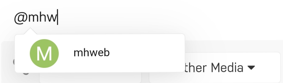

Also, I'm not sure what you mean with the mention. When I click your name it takes me to your profile and won't let me reply to the message.

@mhweb you have to actually click my name so that I get a notification:
@ich777 got it!

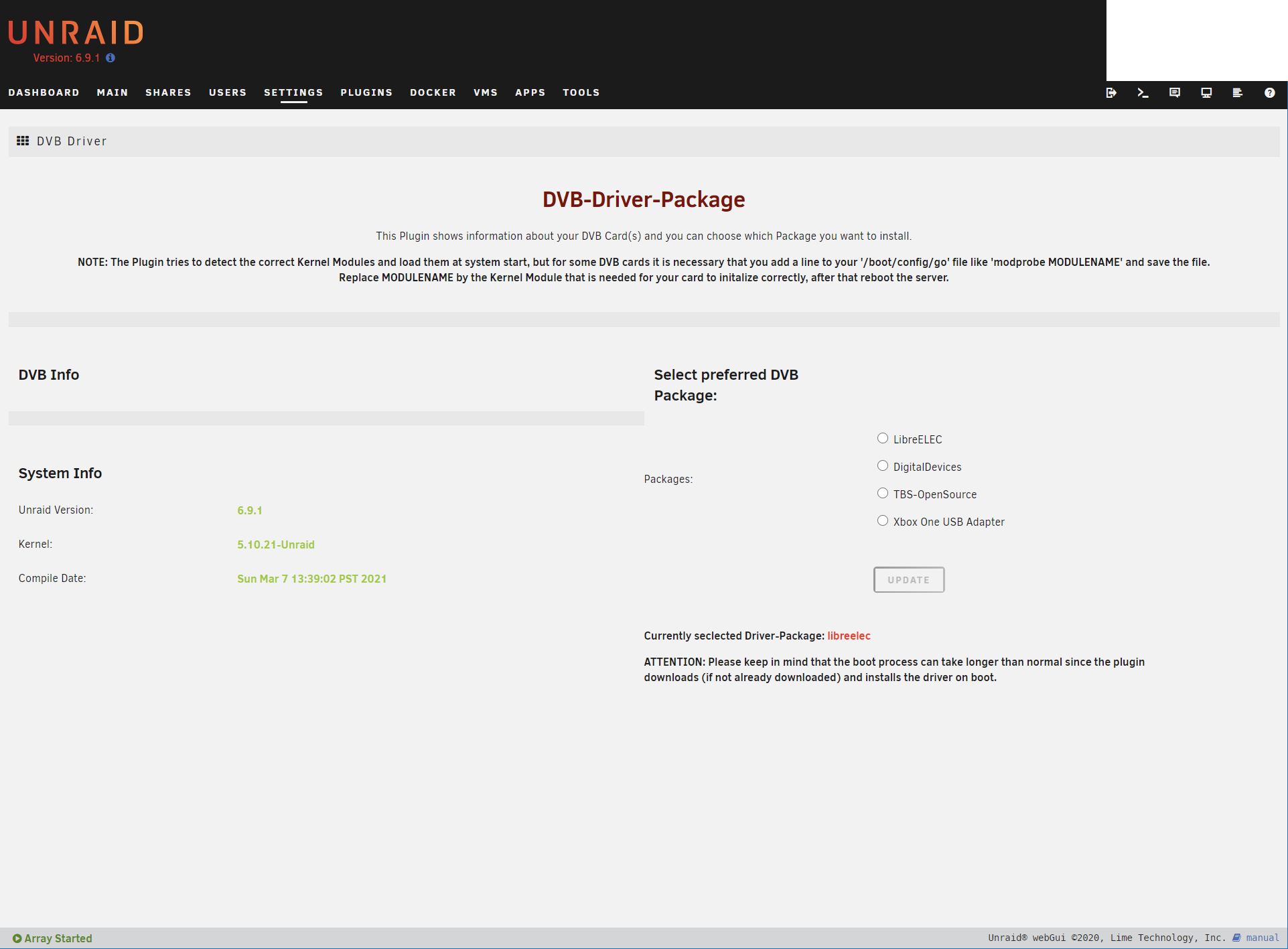

@ich777 I upgraded to version 6.9.1 with the tuner installed in the server, then I installed the plugin, and this is what I have:
Did something go wrong?
Thanks,
I don't think so, have you rebooted after installing the plugin?
If not, please try to shut down the server completely, pull the power cord from the wall, press the on/off and rest button on your server a few times (to empty the caps) wait for 30 seconds, put the power cord back into the socket and turn on the server.
After you booted please attach the Diagnostics (Tools -> Diagnostics -> Download) and drop the downloaded zip file here in the text box if it doesn't work after the reboot.

@ich777 OK, unplugged the server, waited, and then after restart, the same as the image I posted earlier.
 pass is unraid7
Thanks,
Edited by mhweb
diagnostics-20210404-0837.7z pass is unraid7
Thanks,
Can you open up a terminal and type in 'modprobe cx23885' and after that 'lsmod' and paste the output here?
