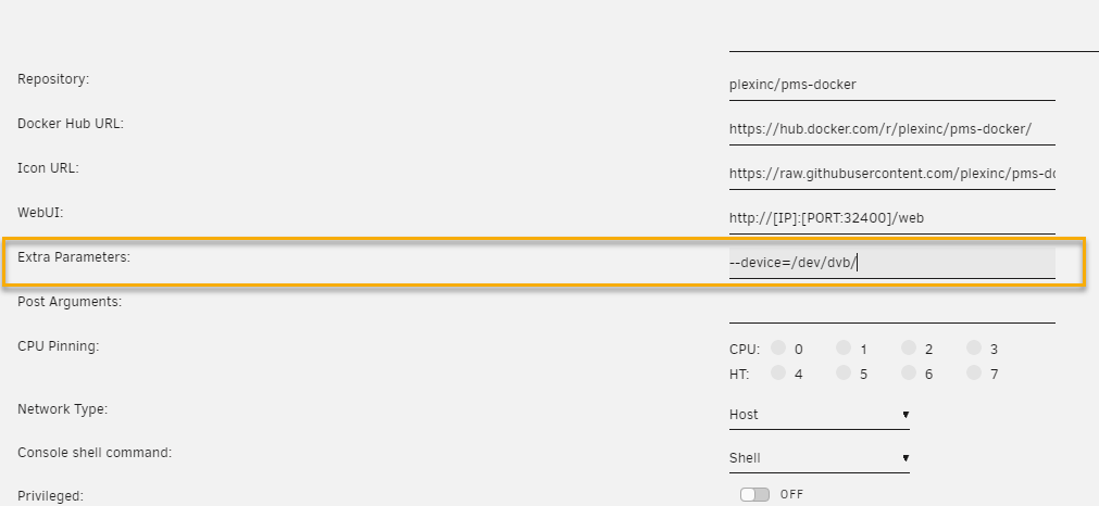

What Extra Parameter have you specified in the TVHeadend container?
--device=/dev/dvb/

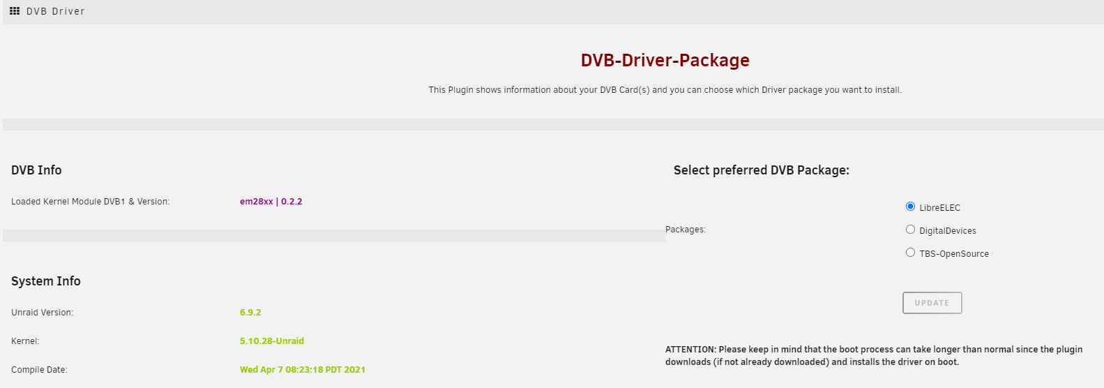

After the recent update my Hauppauge USB tuner has disappeared from the list. Tried LibreElec and Digital Devices driver packages woth no luck.
Bus 007 Device 002:    ID 2040:0265 Hauppauge dualHD
The last update that I've pushed where about 2 weeks ago...
Doesn't it work since then?
Can you please post your Diagnostics (Tools -> Diagnostics -> Download -> drop the downloaded zip file here in the text box).

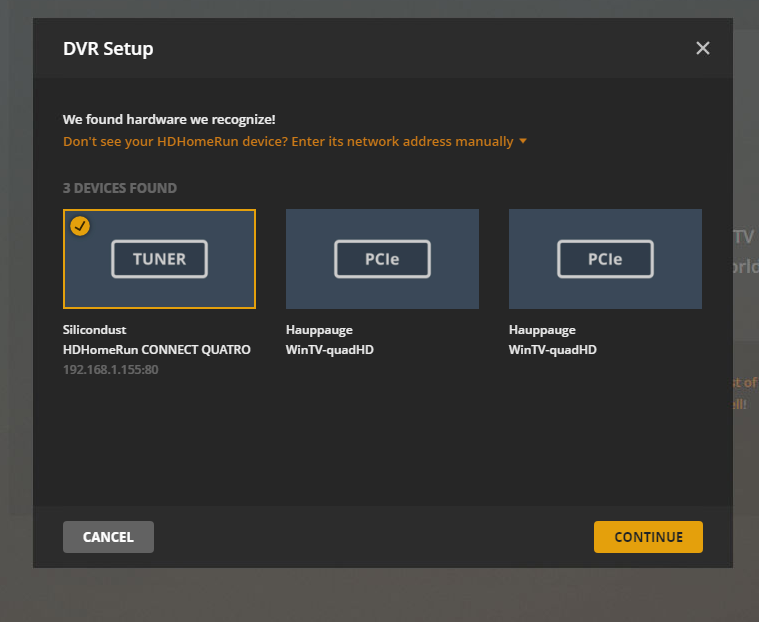

I am have the same card as @anon1105 and also use binhex plexpass docker.  Having the same issue where card shows up in TVHeadend but not in Plex.  Did anyone figure this out?
From what I know for @anon1105 it is working now.
Have you tried to install the official Plex Container yet?
Yes, I tried the official Plex Container too, and nothing.  Trying TVHeadend and Antennnas as a proxy now to see if I can get it to work that way.
Are you sure that you have passed through the device /dev/dvb (as a device, not as a path) to your Plex container?
Yep
