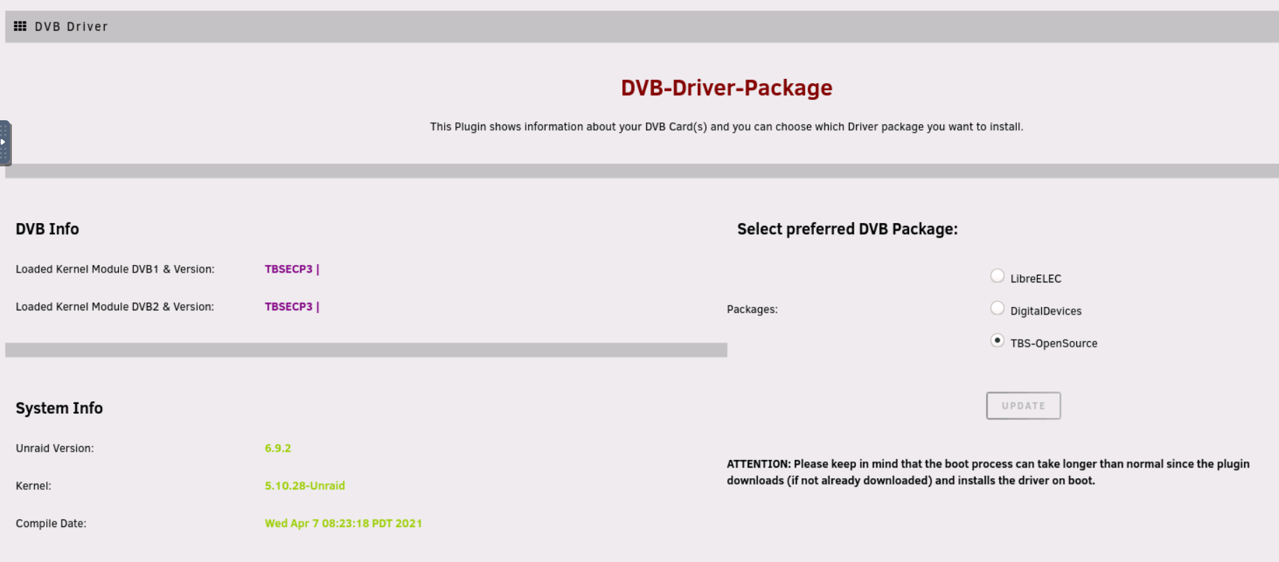

@andris & @pk1057 & @Boo-urns I have now recompiled the TBS-OS drivers please delete the plugin -> then install it again -> go to the plugin page and select the TBS-OS drivers and reboot.
Please report back if anything changed. :)
Same error :(
Sorry, I won't be home on the weekend, cannot test anything in the next couple of days.

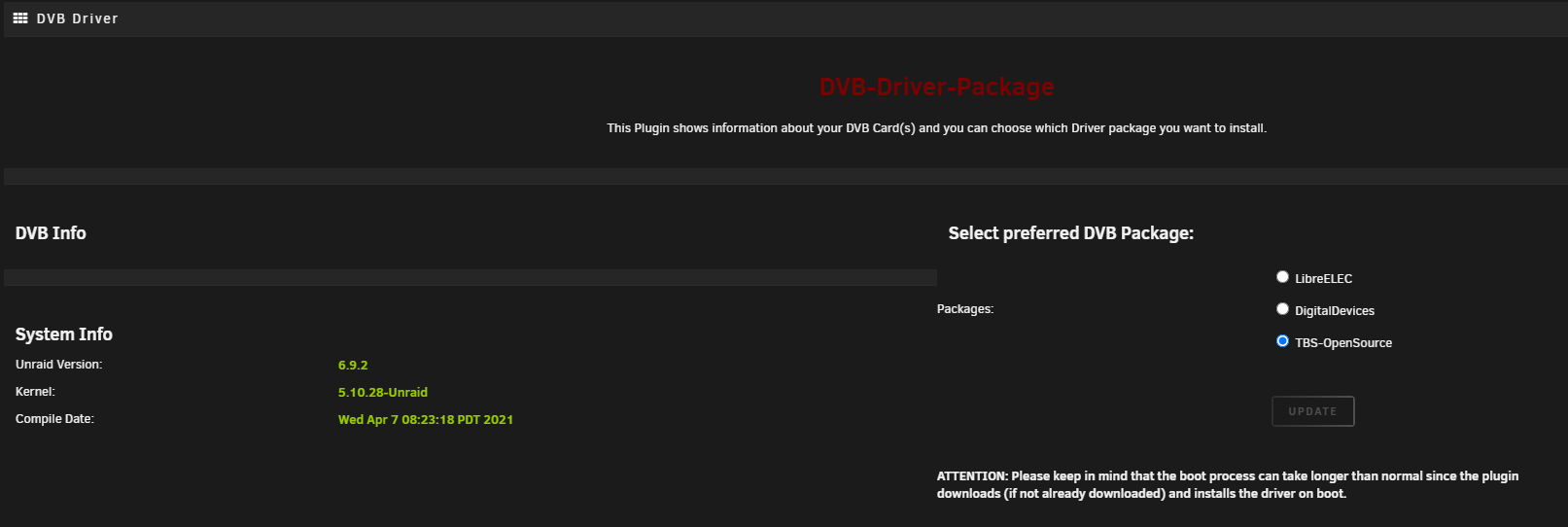

@andris & @pk1057 now I think I got it! :)
Please remove the plugin, reinstall it from the CA App, select again the TBS OS driver pack and reboot.

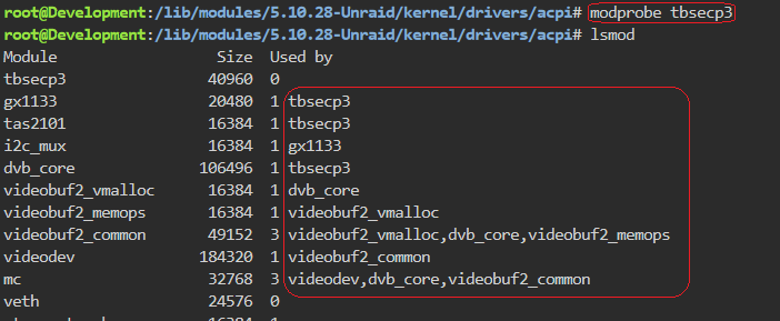

@andris & @pk1057 I had now access to a machine that has a TBS card installed and can now confirm that it's working again.
Please be sure to remove the plugin once to completely get the newest version of the plugin and also from the TBS-OS drivers (you have to be on version 2021.05.02) after you did the above steps reboot and you should be greeted with following screen:
Ok,
driver is loaded but firmware files are missing.

28 minutes ago, pk1057 said:
Ok,
peter
You are completely right, will update the package shortly and report back.
Tried a few things yesterday and I think I uploaded the wrong file while the kids where screaming for his dad in the background... :D
Sorry for the inconvenience... :/
43 minutes ago, pk1057 said:
Ok,
Package now updated, you can do the same like always (delete the plugin, install it again, reboot) or delete the package itself by issuing the command: 'rm -rf /boot/config/plugins/dvb-driver/packages' from a Unraid terminal and reboot.

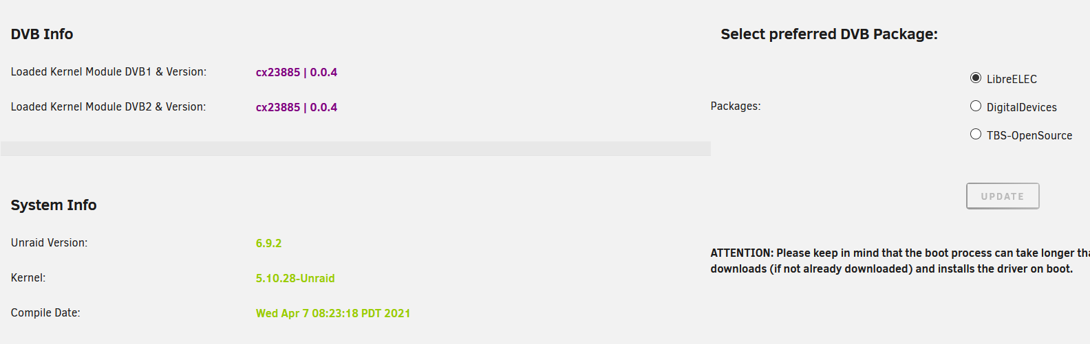

Hi! I hope you can help me out... I installed a WinTV-HVR-5525 into my Server and loaded the DVB-Driver Package. I've tried all 3 Driver Packages, only the LibreELEC finds something. So far so good, but only two tuners show up (DVB-T, DVB-C). The DVB-S / S2 is missing and when I try to set them up in Plex it only shows the T/C. Any clues what I could do?
