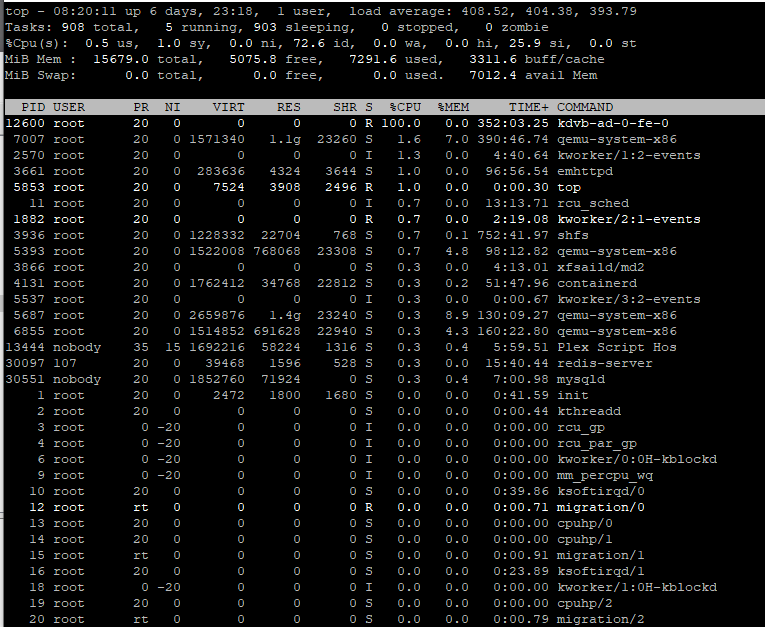

1. Thank you for the work on this plugin and getting TV to work easily!
I've been experiencing some major stability issues every since I installed this though.  I don't know if it's this plugin or Unraid 6.9.0-rc2.
Prior to this I was running the stable branch of Unraid - 6.8.3 and I had a flawless 100+ day uptime.  Now I need to manually reboot my system every 3 days.
The Unraid UI becomes unresponsive, all my docker containers become unresponsive, all my VMs are down, but I can SSH into the machine fine and when I check
top
 I get everything is fine.
I'm struggling to get stability back my system because I rely on a number of things that it's running.  I'd love some help trying to troubleshoot or solve this problem of mine.
Can you try to run the server without my Plugin for a few days for troubleshooting reasons to narrow down what's the problem?

8 hours ago, ich777 said:
Have you installed a VM on the server? If so is the Networking set to virtio-net?
I have 3 (three) Linux VMs running on the server, all set to the virtio network model.
EDIT - I have removed the plugin but kept Unraid 6.9.0-rc2 I'll see how the stability goes.

Just now, lord xeon said:
I have 3 (three) Linux VMs running on thee server, all set to the virtio network model.
Anything in your syslog?
Is it a option to uninstall the Plugin und not use DVB for a few days to narrow down the lock ups?
I haven't noticed anything.  I have uninstalled and re-booted my system.  I'll see if that helps and report back.
The plugin was working perfectly and I was able to use it in the TVHeadEnd Docker Container - I had recorded TV and all.
I'll keep you updated.
UPDATE:
I uninstalled the plugin and was able to keep track of things for a few days and noticed something in the syslog related to the 6.8.x to 6.9.2 upgrade and networking in VMs.  I'm sorry for missing that.  I was able to catch that and fix it before too long.
Without the plugin enabled, I had no problems with over a week of uptime.  I decided to try turning it on again and trouble arises.  I can go about 6 to 7 days with no problems and then one of my cores will show 100%.  Unpon ssh and running
top
I see this:
kdvb-ad-0-fe-0 is at 100% and when this happens the server is more or less un-useable. I can't reboot or shut it down via command line or the UI, I have to hold the power button down.
This thread is usualy started in TVHeadend and is related to the first tuner, what kind of drivers have you installed?
I'm using the libreelec driver package and I have a Hauppauge WinTV HVR-950 USB tuner plugged in.
