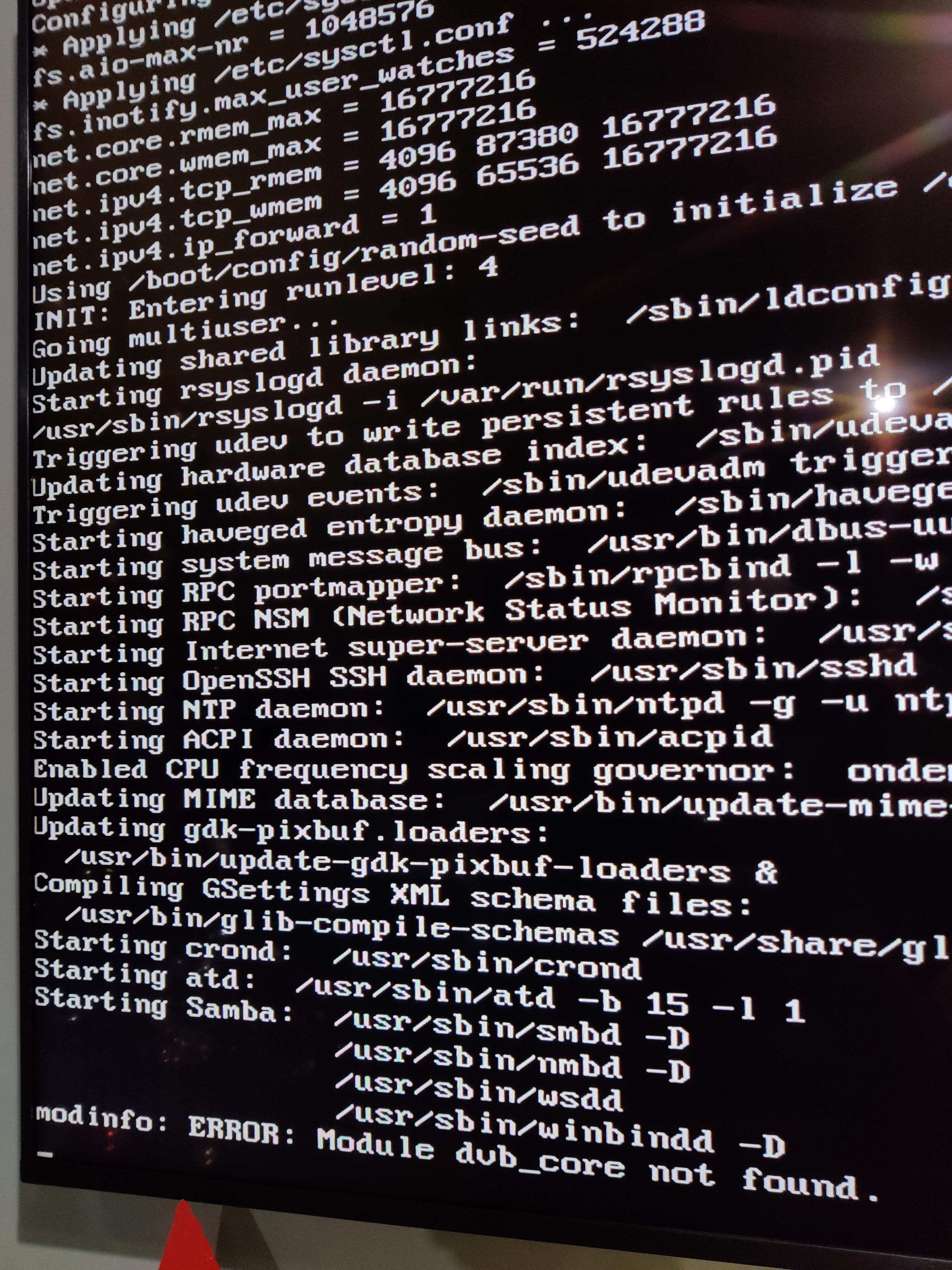

Hi @ich777, thanks for your work on this new plugin.
I'm also getting a "dvb_core not found" error during system startup.
Subsequently my AF9015 USB sticks aren't getting initialised properly, but I think it's due to the AF9015 firmware not being available during initialisation first time, as when I remove the sticks and re-insert them, the firmware is loaded fine, and /dev/dvb gets created.
Attached is my syslog
Please always attach the full diagnostics, the output of lsmod would be also really helpfull (but without the adapters repluged).

Also where did you get the error that dvb_core is not found, I can't find anything related to that in your syslog.

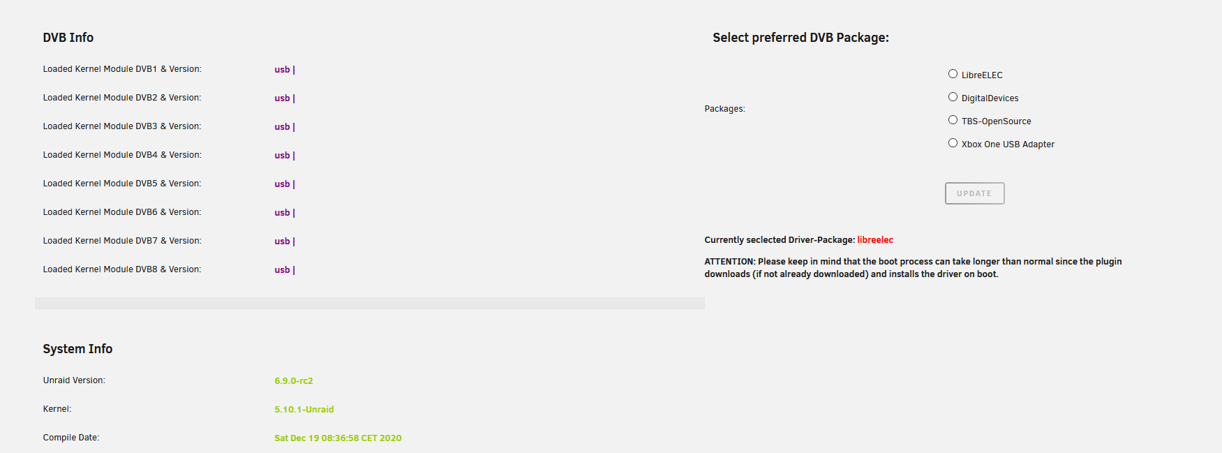

1 hour ago, piotrasd said:
for TBS 6909 doesn't work
I tested it only with a TBS-6902 and it works just fine with the TBS-OS drivers.
What drivers are you using? Have you rebooted after you installed the plugin? This seems fine to me, have you the folders 'demux0', 'dvr0', 'frontend0',... in the folder /dev/devb/adapter0/?
EDIT: Please keep in mind that you also have to reboot if you change the Packages from one to another.
nothing /dev/dvb/adapter0/ under this directory and others which is weird
and im using tbs-os
and im using tbs-os
yes i rebooted few times
That is really weired, does this card's need any boot arguments like the DD Max S8?
Can you post the Diganostics from your server?
Also please try the LibreELEC drivers just for testing.
The next thing you can try is to build custom images with the Unraid-Kernel-Helper...
Attached is photo of the console messages showing dvb_core not found. Also syslog.txt and lsmod.txt from a second boot of the machine.
There are mxl5007t errors. I've tried modprobe mxl5007t in /boot/config/go and that didn't help.
lsmod.txt syslog.txt
Edited by Zan
That first initialisation
From the output of your 'lsmod' the module 'dvb_core' is definitely loaded, I think it has something to do with the initialization itself, what you can do is try to generate a Custom build of Unraid with the DVB-Drivers included with the Unraid-Kernel-Helper (it's a really simple process):

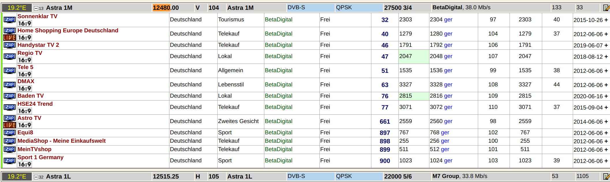

Hi @ich777 and sorry for bothering you again. Unfortunately not all of my TV channels work normally in tvheadend. One channel (Sport1 in specific) shows laggy picture and interrupted sound. Please find the log output in the annex. All other channels work as expected. In the vm I have the same problem. Can you also help me with this?
Thank you again for your help!
This seems like a waek signal or other kind of problem, nothing that I really can help with.
Eventually look at this thread: Click
@Maginos Cont errors are pretty sure bad signal on this mux
may try to scan again and cross test other channels on the same network, just to be sure its only this one channel ...
@ich777 and @alturismo thank you for your help.
as it turned out, its unfortunately not only Sport1, its also DMAX.
The situation is the following:
Before I used the TVH docker container, I used a raspi and the cable from the satellite was directly going into the usb adapter on the pi. With this setup, all channels worked normally. The unraid server is in the back of my room and the cable from the satellite too short, so I had to connect another cable to get to the unraid server. With this prolonged cable, the two channels don't work neither on the pi, nor on unraid, so the problem should be the cable. I ordered a new cable and a new connector for the two cables and I hope, that this will solve my problem. A rescan is indeed a good idea, thank you for that.

@ich777 and @alturismo I got it!
FYI: The new extension did unfortunately not bring the solution, but extension of the USB cable did. So no I have the cable from the satellite directly plugged in the usb adapter and the usb cable from the adapter is extended to the server. Now, all channels work as expected.

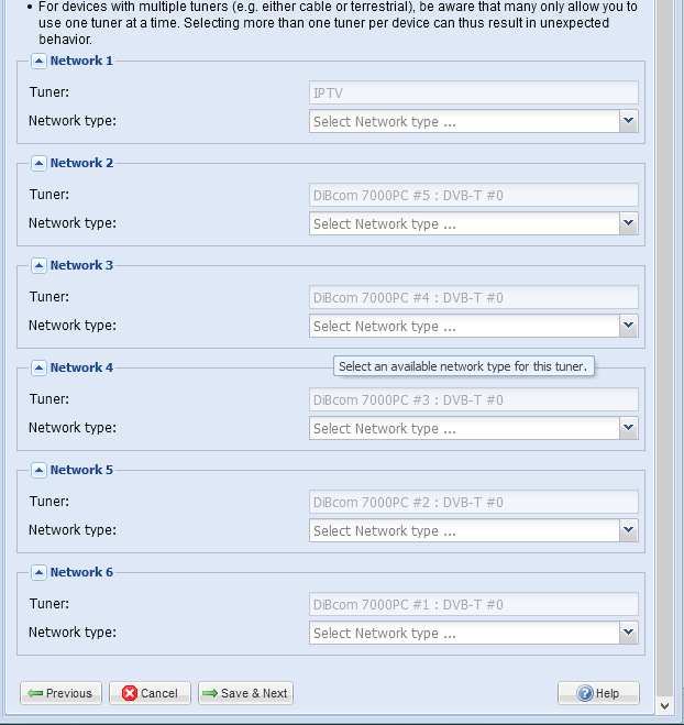

10 hours ago, Spriggy said:
One question tho, is there a way to compile the kernal with a 16 Tuner limit instead of 8 (dont ask why I have more than 8 lol)
This plugin should be compiled with a tuner limit of 16.
I did reboot the server once I installed the Plugin.
What I have plugged in at the moment is 3 x Sony Playtv Tuners and I am using the libreelec drivers.
When I have 2 plugged in TVheadend (linuxserver.io version 4.2.8), it sees 4 tuners and tunes fine.
When I add a third it detects the 6 tuners in the config page but only 5 in the wizard page for tuning.
Should I be using a different driver? Or is this a TVheadend issue?
