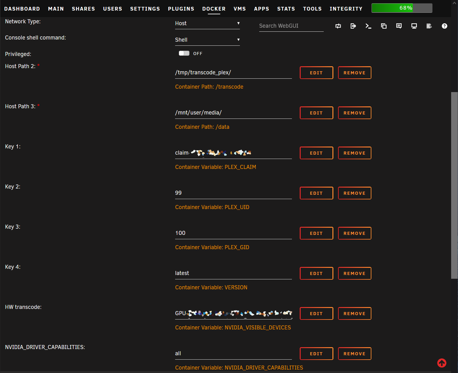

November 8, 20223 yr Hi I tried to use the fantastic Spaceinvader's guide but when I've to add my GPU Nvidia on "Nvidia Visible Device" I'm not able to set nothing. (I've posted an screenshot to explain better than my bad English) Whwre is my error?? Tks for help me!!! Edited November 8, 20223 yr by Alcarimon
November 8, 20223 yr 2 hours ago, Alcarimon said: Hi I tried to use the fantastic Spaceinvader's guide but when I've to add my GPU Nvidia on "Nvidia Visible Device" I'm not able to set nothing. (I've posted an screenshot to explain better than my bad English) Whwre is my error?? Tks for help me!!! SOLVE tks
December 4, 20223 yr On 11/9/2022 at 4:56 AM, Alcarimon said: SOLVE tks How did you solve this? Can you please share?
