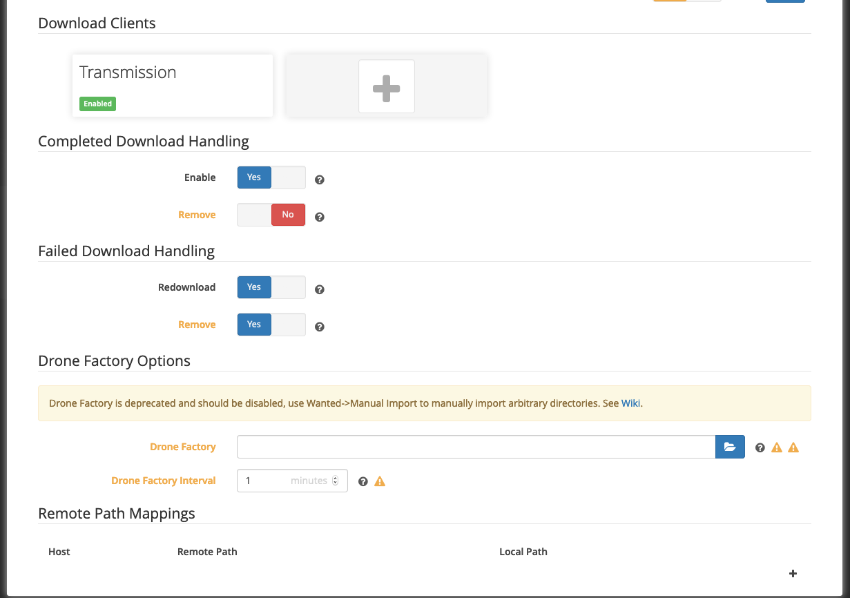

  4. Dear Squid, I appreciate your help very much. Thank you. No error messages with this additional path mapping. I will wait till tomorrow when new downloads are scheduled and will report here for the sake of good order.

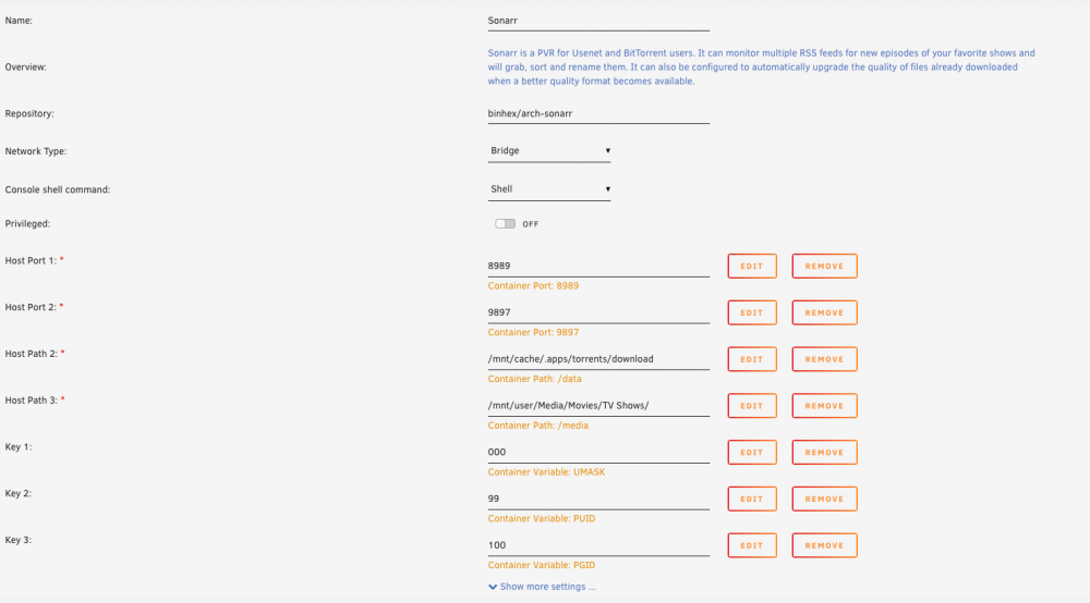

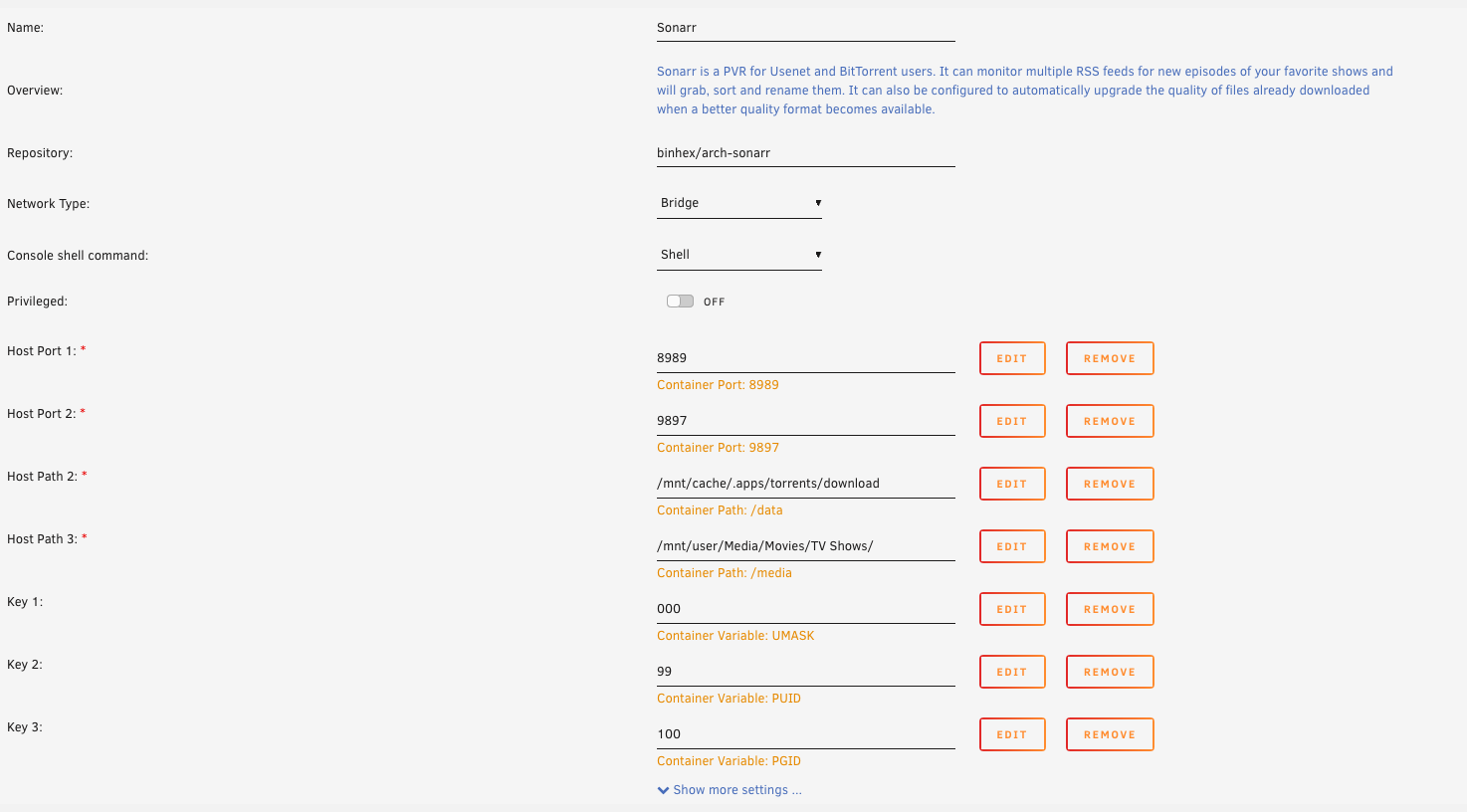

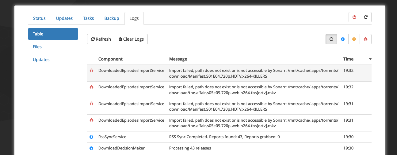

  5. Thank you Squid. I understand. I will switch to transmission docker. Could you please let me know what you mean to map /mnt to /mnt in Sonar container. I do not see such setting. Do I need to add a custom path? Sorry for the newbie question.

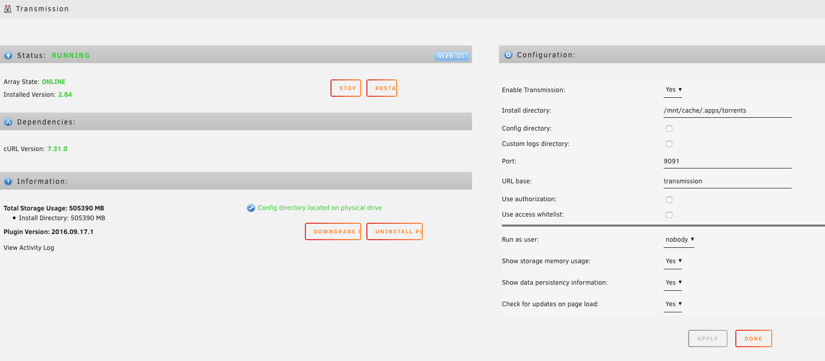

  6. The transmission is a plugin. Not a docker. Here is a screenshot. Do I need to have transmission as a docker?

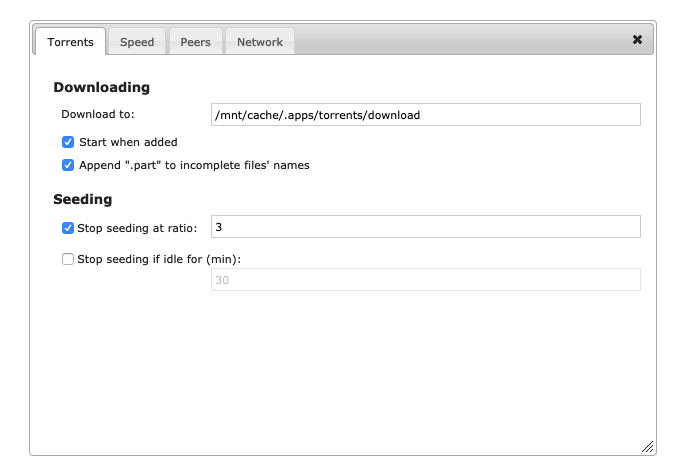

  7. Thanks Squid. Transmission is downloading straight on the cache drive. The full path to it is:

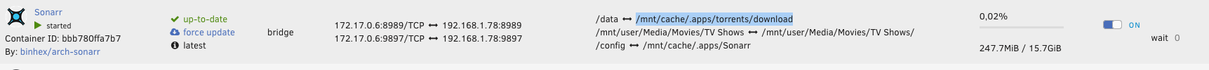

  8. Dear all. The last few years I was using Sonarr with Transmission with a great success. As my unraid server version was quite old I have decided to update. I am using a transmission plugin (not docker) and the latest Sonarr. However the problem is once Sonarr tells Transmission to download the series and it finishes, Sonarr cannot move it to the cache drive where it should be located. The settings are exactly the same as they were prior Unraid update. The Data folder at Sonarr docker points to the folder where transmission is downloading and seeding. Here is an excerpt from the log file: Please kindly see my screenshots attached: Thanks for your time in advance.
