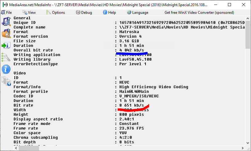

  8. @Josh.5, I got this results on every transcoded file, the video bitrate (red) is not updated to reflect the transcode, it stays the same as the original bitrate

  13. Hello, I just installed Unmanic to replace handbrake (the thing I don't like about handbrake is that force converts srt to ass). So far going great, but a couple questions: 1.- I get "Unable to connect to Unmanic backend. Please check that it is running." in the webUI. Despite that message conversion works so I don't know what the backend is or what I am missing. 2.- The mover v2 plugin does a copy of the file to another location (and still replaces the original with the new transcode) Is this how it supposed to work? I think the logical behavior to need this plug-in is leave original file in original location alone and put the new transcode in the specified location (great to compare both). 3.- Unmanic is using x265 3.2.1+1-b5c86a64bbbe, is there a reason to use this version and not a recent one? 4.- Why the media info of the transcoded file wrongly states the bitrate of the original file under the video stream?
